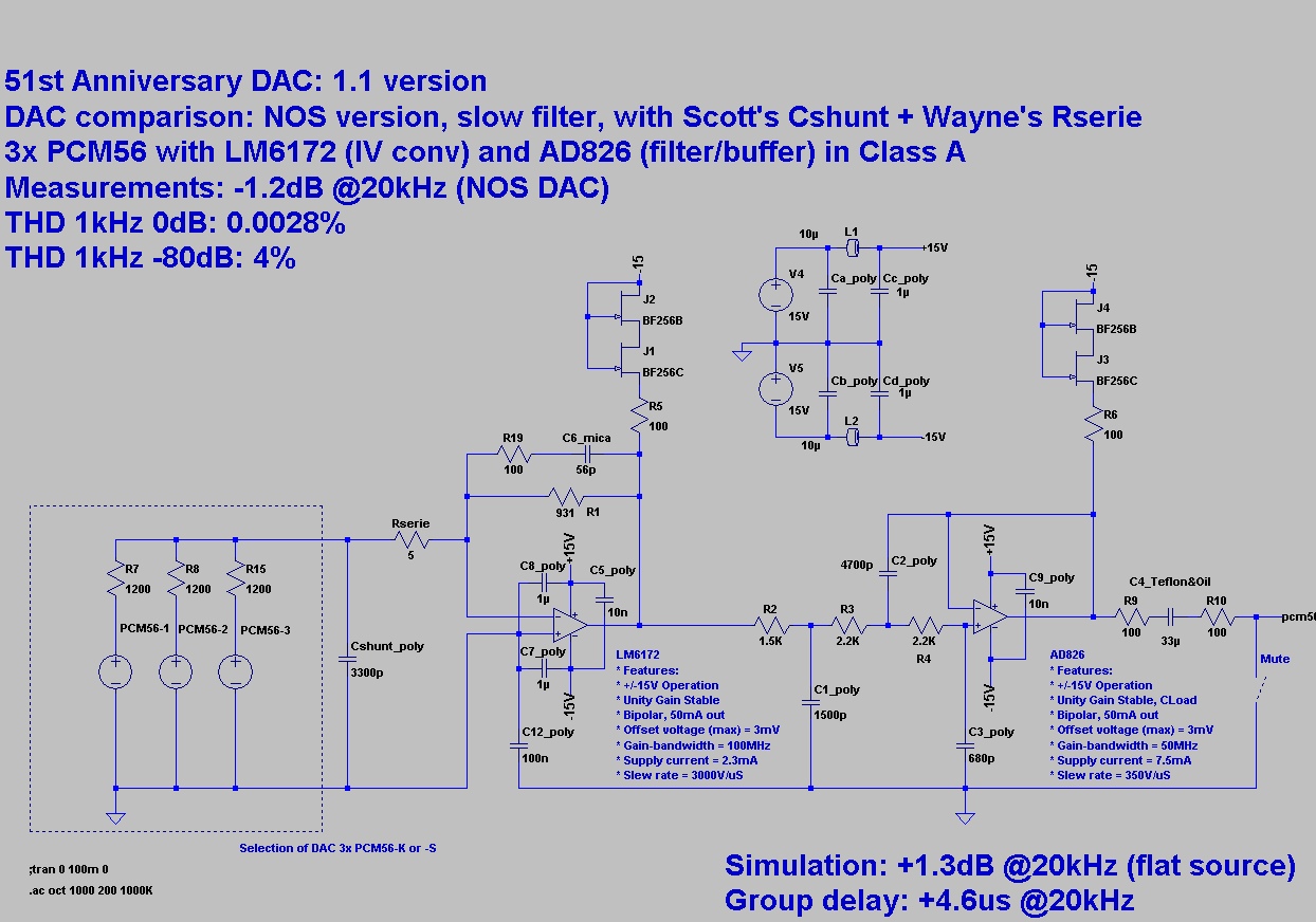

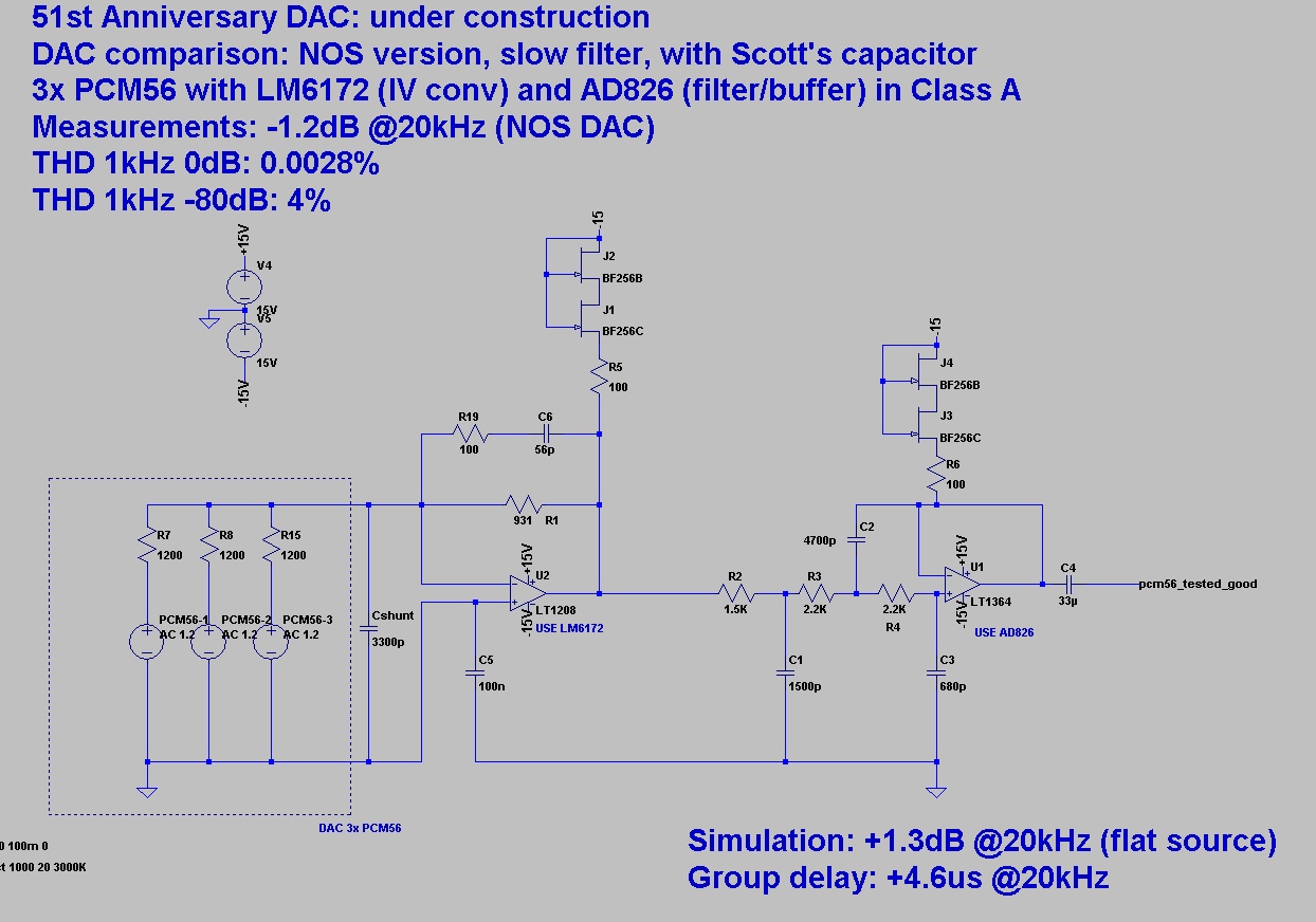

Let us pass on some measurements of mine with Scott's capacitor.
First: a 150nF cap in that position, even if sounds good with a 5 ohm serie resistor, lowers too much the response to a further -0.3..-0.4 db at 20Khz. Too much in addition to the sinx/x roll-off inherent in the NOS digital to analog conversion process. I would have -1.6dB at 20kHz at the end which I cannot afford.
Scott's capacitor (1.8nF) sounds good the same but does not visibly affects the HF frequency response (till 20kHz). I'm thinking to move to 3.3nF.
Both values (150n and 1.8n) made worse the THD (with PCM56s). With some opamps THD doubled (strange but AD826 was the worst arriving at 0.006% 0dB 1Khz) due to the increase of the 2nd harmonic... Also with LT1208 THD increased at eye.
With other opamps the THD increase is negligible: the two best results I got are with LT1469 (0.003%) and LM6172 (0.0028%). The last is sounding much more musical and rounded.
I added the small RC network with 100nf +56pF (silver mica) which sounds better than the single picofarad cap.
All caps are polypropylene.
So actual configuration is the following. Still testing and tuning but performing quite well. Maybe not definitive but I'm close to it.

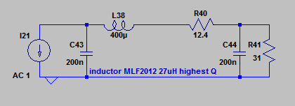

Don't know why not look into what abraxalito has been doing with multi-pole filters between dac and opamp. More attenuation of clock noise (or whatever other unwanted HF) without going to a huge cap. abraxalito?
Where I'm at currently is 3rd order CLC - the challenge I'm interested in is finding inductors with close enough tolerance. This variant is using TDK 0805 27uH (selected as it has the highest Q) with about 15 in series to hit the required inductance (400uH).
One advantage with the CLC filter in NOS applications is that it can be tweaked to give the required HF boost - however doing this makes the FR even more sensitive to having the correct inductance. In my present design I'm doing the NOS boost in a subsequent MFB 3rd order stage in the hope of RCs giving me better production consistency than LCs.
The noise gain issue becomes significant if aiming above 16bits - with the 31R loading I have here (its the series R feeding the virtual earth) the SNR is fine for my 16bit DACs (subjectively) - the opamp involved has about 2nV/rtHz voltage noise. Going to lower noise I plan to play around with a step-up transformer between DAC and I/V stage.

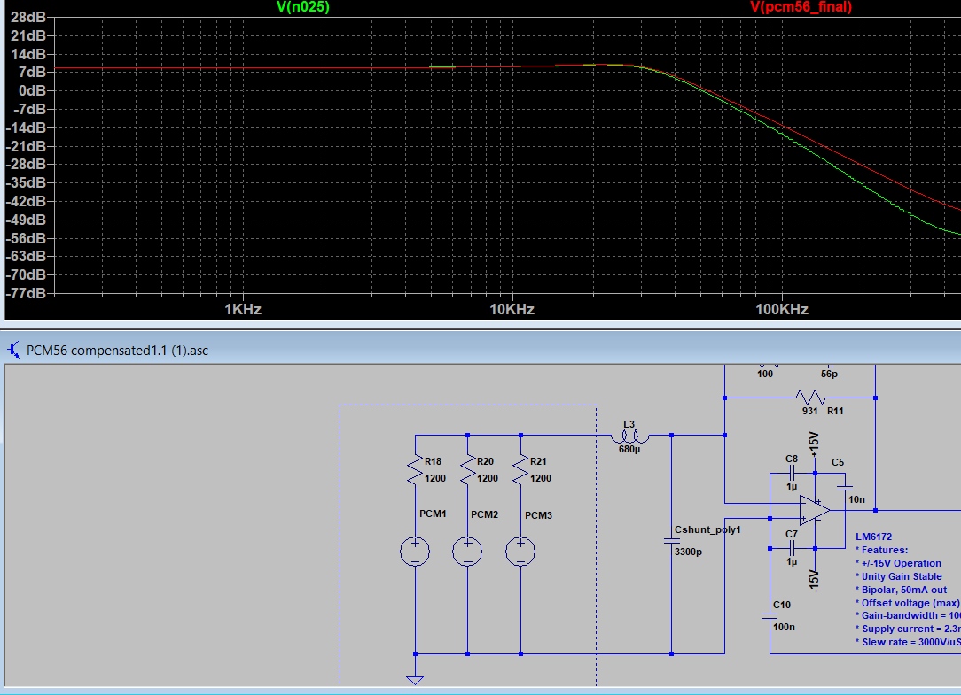

Final solution
Hello, little update, and probably final version.
Added 5 ohm resistor (Wayne) between Scott shunt cap (increased to 3300p) and Opamp input: that balances a little, making a long-term free fatiguing listening and doesn't hurt the gain and dynamic at all. Completely analog sound now!
LM6172 IV converter is the final choice among more than 20 Opamps listened in that position.
Thanks to all your inputs!
Multilayer.
I'm now testing a 680uH TDK TSL0809RA-681KR28 inductor (I have not multilayer, I hope this is not an issue) before the 3300pF Scott's cap, giving up to the 5 ohm serie resistor after the cap.
This should form an LC filter at 100kHz, cutting a futher -10dB RF (green line) without effect in the audio band.
Sounds good. Sounds better.
The choke you're using looks superior to the multilayers I'm using (higher Q), definitely not an issue. I'd guess your LC filter relies on the relatively low output impedance of your paralleled DACs (400R) for damping.
