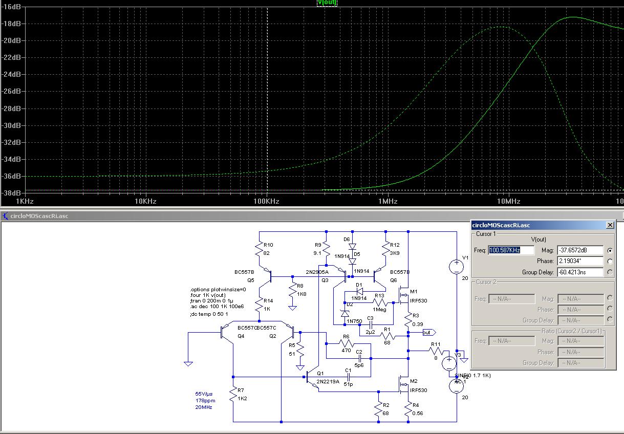

1) schematic for damping factor over frequency
2) AC-Analysis (damping factor over frequency)
3) AC Analysis - not show !! (normally frequency response)
4) Fourier Analysis lin 10 KHz (THD)
5) Fourier Analysis log 10 KHz (THD)
6) Fourier Analysis log 100 KHz (THD)
7) Fourier Analysis lin 100 KHz (THD)
8) Transient Analysis 1 MHz
9) Transient Analysis 10 MHz
10) schematic (normally frequency response)

Simulation results for the distortion are to be taken with a pinch of salt: they give the right order of magnitude, but they are rarely spot on: in ~80% of the cases, I find the actual, measured value is somewhat higher than simulated, in ~10% of the cases, it is better, and the remaining 10% are about right.About number 2 to 7 can be seen clearly that the p-spice models do not perfect or my simulation program "Circuit Maker" is overtaxed. What about the simulation results in this case with your LTspice?
One or two things to remember about this amplifier:
It's cheap, it's N, it's dirty,
This design is optimized to be simple, cheap, robust, stable and energetically efficient. If there is still room for linearity, so much the better...Crude, but effective
There are a number of identified causes of non-linearity: one is the folded cascode: not all the current from the NPN circlo phase shifter is transferred by the PNP to the upper MOS (because the low-value emitter resistor R9 shunts part of the current), meaning the circlo symmetry of the driver stage is not perfect.
Another is the switching action of D1 when the threshold-shifter enters the "hold" mode: this removes some current from the drive to M1 and causes distorsion.
For this reason, the current through D1 (hence D2) is kept minimal.
The low bias current is also required for the subsequent versions including the autobias: operating the zener in a "soft" part of its characteristic gives more compliance to the control.

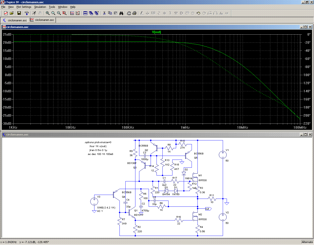

Thank you very much for your replies in post #41. I agree with all except in case of D5: When D5 would be a zener diode it would be the wrong direction (please note: Zener diodes are bidirectional diodes, one direction the zener voltage, the other direction approx 0V65 - 0V7 - like a normal diode) But I chose a normal diode, i. e. an unidirectional diode. So the choiced direction of me isn't wrong.
Regarding the clipping behavior I wrote the following:
"About number 2 to 7 one can be seen clearly that the p-spice models do not perfect or my simulation program "Circuit Maker" is overtaxed. What about the simulation results in this case with your LTspice?"
But I mean number 3 to 7 of the second pdf !!! - only the four different AC current transient signals (transient analysis)
I get the mentioned current signals through introducing current sense resistors in the gate line, that have very low values without influence of the other parameters.
What show LT-Spice here in case of clipping? That would be highly of interest, because thereby I can identify and compare the character of the simulation work (and perhaps different p-spice parameter of the MOSFETs)

Interesting reasoning.Thank you very much for your replies in post #41. I agree with all except in case of D5: When D5 would be a zener diode it would be the wrong direction (please note: Zener diodes are bidirectional diodes, one direction the zener voltage, the other direction approx 0V65 - 0V7 - like a normal diode) But I chose a normal diode, i. e. an unidirectional diode. So the choiced direction of me isn't wrong.
You must have received a jesuit education.
You can always reverse a zener in any circuit... but then the circuit will behave differently. Similarly, you could argue that BJTs can have their emitter and collector swapped: they also work in the reverse direction, only with a reduced beta.
Reversing D5 disables the threshold level shifter. If you really want to do that, you can in fact remove it completely, as well as C3, D1, R13, D6, Q6, R12.
You then have to halve R9, to rebalance the circlo operation. It will also work, but the positive excursion will be limited, as in your simulations.
If you insist on simulating "your" circuit, it makes little sense to try to make comparisons.Regarding the clipping behavior I wrote the following:

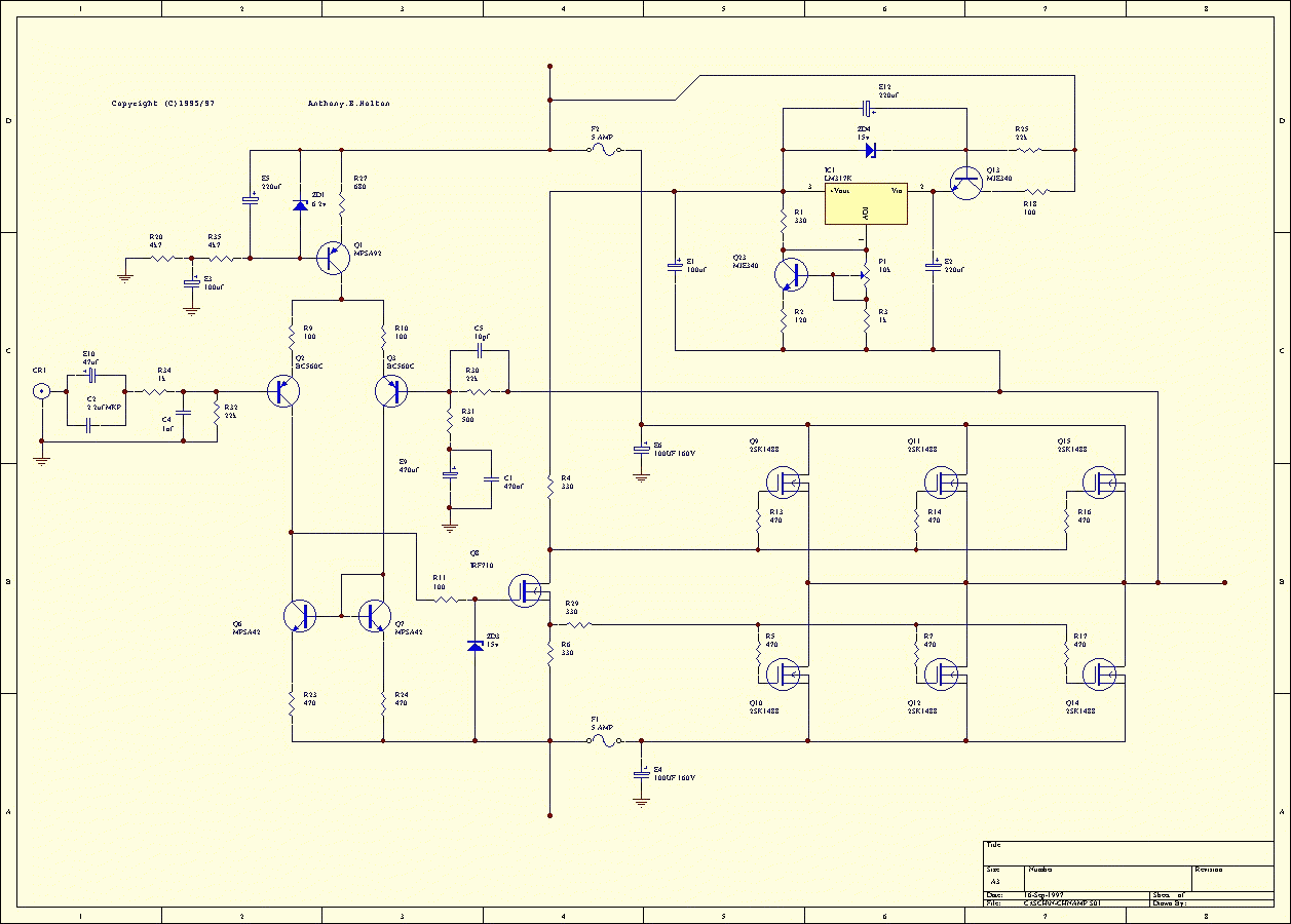

You have a very interesting amp. The closest commercial equivalent would be this: Model 6552-1A 100 watt Solid State Audio Amplifier used for testing power line noise immunity. Again durability is paramount in these things. Which also brings tradeoffs in distortion/noise versus indestructability. For sheer bandwidth the amps from Krohn Hite are the most equivalent Krohn-Hite Corporation - A Leading Manufacturer of Test and Measurement Instruments Since 1949. I have one thats broken. I have been reluctant to service it since the supplies are +/- 200V making it rather hazardous to poke around in. Some long weekend when nothing else is more pressing. . .
Your solution is much cheaper and could be packaged as a disposable module for a commercial market.

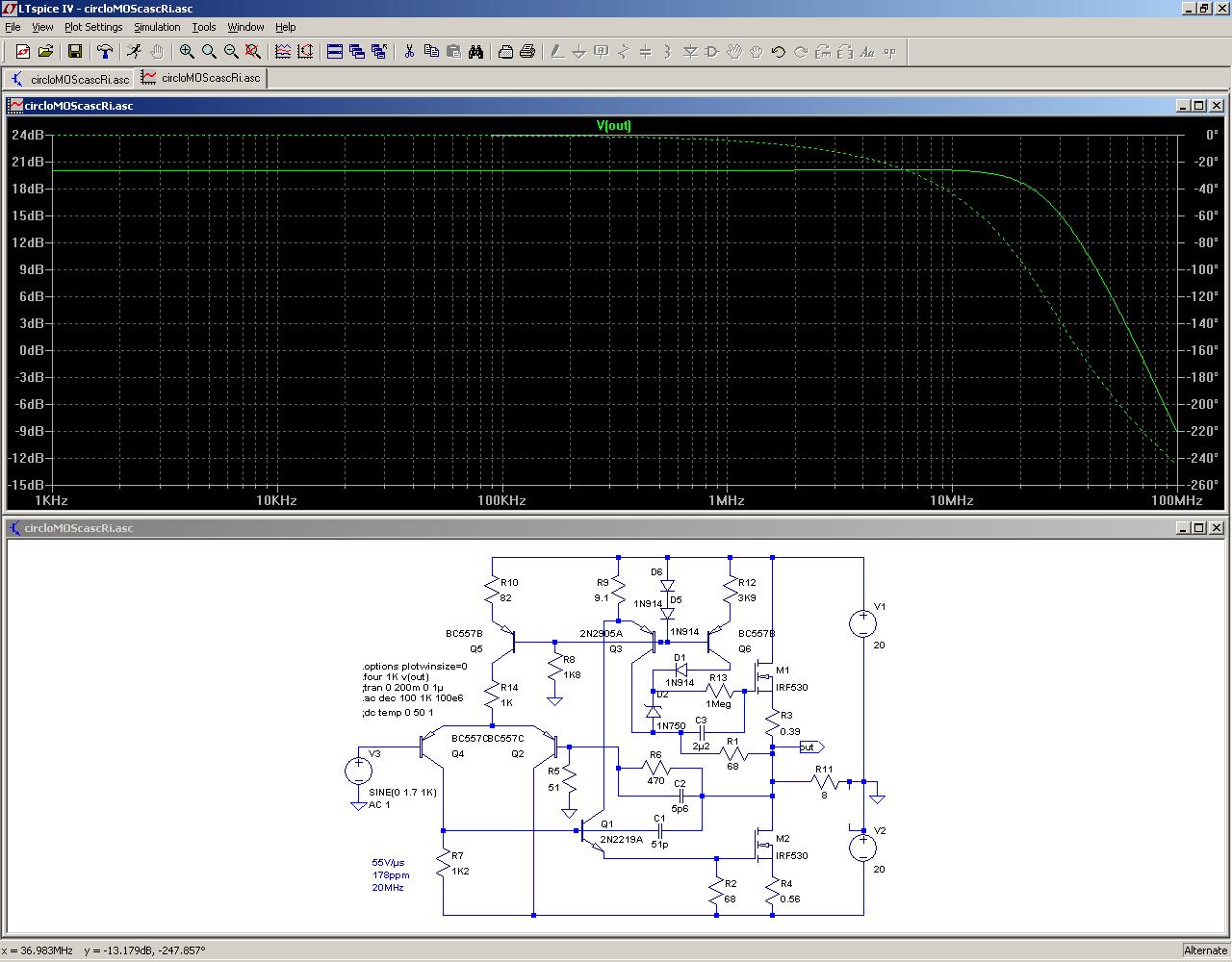

from post #18 The next variant has a higher loop gain.
This results in a higher feedback factor, and a reduced distortion: the linearity is now around 5 ppm at near-full power (0.0005% dist.)
Other characteristics remain practically unchanged.

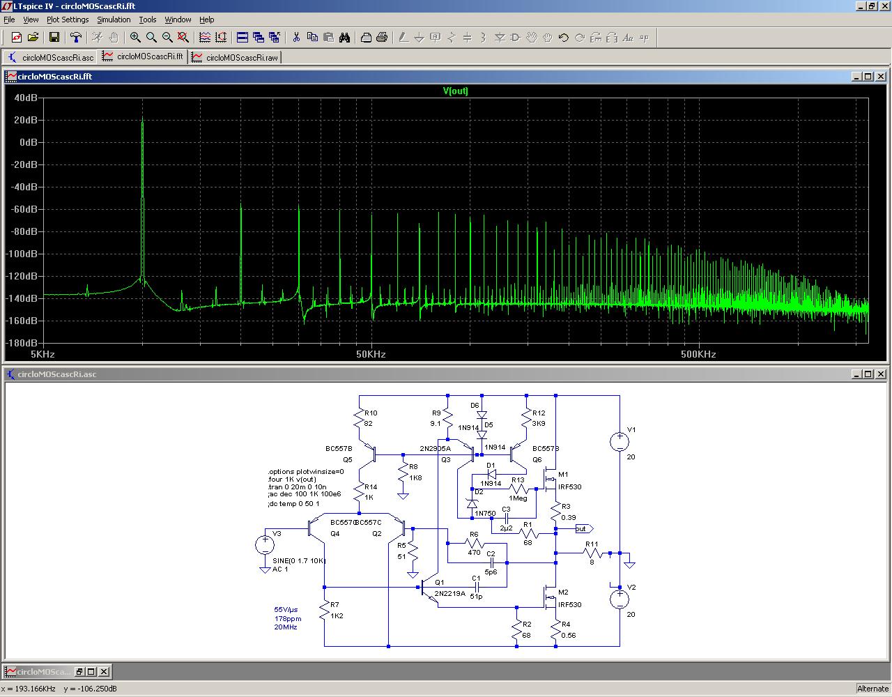

Here my simulation results of this circuit by 10Vss output and 1200mA idle current through the output (slightly modify the comensation to get results):
1) schematic with mentioned dc voltages (set by simulation)
2) AC Analysis (normally frequency response)
3) Fourier Analysis lin 10 KHz (THD) K2: 540uV, K3: 230uV
4) Fourier Analysis log 10 KHz (THD)
5) AC-Analysis (damping factor over frequency)
Unfortunately I don't get the follow diagrams:
Fourier Analysis lin 100 KHz (THD) K2: 1130uV K3: 390uV
Already by 20 KHz I get only error messages (by the introduce of current mirrors in generall - independend of the circuit topology)
The reason is, that my simulations software don't like current mirror's. If I remove the current mirror, then I get all diagrams again. Instead of current mirror I will test the two transistor topology Q6/Q5 of X-Pro in the schematic of first post about

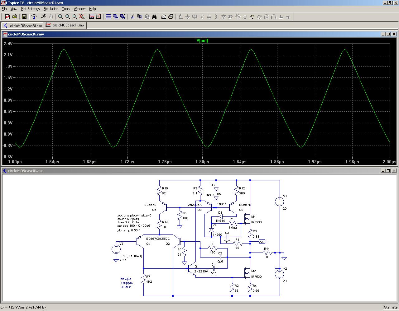

Some remarks about this schematic: it is derived from a very similar version using a BJT as the circlo phase shifter. This variant, using a MOS, M3, is a theoretical exercise, and has not been tested, just simulated.
In addition, the circuit was initially calculated for 20V supplies. I just changed the supplies to 50V "to see what happens", following a request by AKSA, and it happened to operate almost normally, but all this means we are in uncharted territories.
In addition, your schematic shows a number of errors and inconsistencies:
-R3 is a test resistor of 0.5milliohm, not 0.5ohm
-R20 is 33 ohm, not 330
This should result in a much lower Iq. Yet, you get 1200mA in your sim (I had 300mA with the "normal" version)
This is clearly inconsistent (yet your schematic shows that Q8 is in hard saturation)
Now, there remains an obvious inconsistency, and it has to be in your 1N750 model: there is only 63pA passing through it, yet the voltage is 4.55V, almost the nominal voltage.
This means the ideality factor must be unrealistically good, or something similar.
At this level of current, these low-voltage diodes behave like ~short circuits.
Dou you have also a circuit diagram resp. schematic diagram of this device from the Krohn-Hite Corporation?
I do have the manual. However having it and knowing where it is do not necessarily correspond. I will try to find it over the next few days and scan and post the circuit drawing. There is a lot to learn from them. They have a long history of building wide band amplifiers and a large collection of tricks in the designs to solve problems "waiting for the unwary".

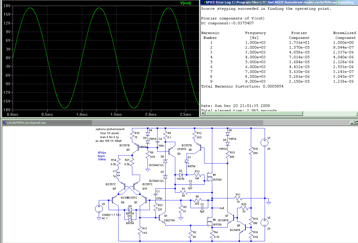

CircloMOS-XQ
Here is another variant of the circuit, where the higher loop gain and resulting lower distortion is achieved by means of a crossquad input stage.
This should please those unhappy with current mirrors.
Note that this is a pure simulation exercise: the circlo topology and the Xquad input have both been validated, but separately.
Some food for thoughts.
Also note that the Xquad is not an easy beast to tame: its input impedance is negative, and it will oscillate unless the source impedance is very nearly zero.
Have fun anyway

Im building a small version of this amp today.
Since im using what i have at home, it will be a 5 - 7 watt version using a 19 volts single rail powersupply and two IRF3706 in the output.
Slowly making some progress.
I found a LED that have a 1,72 v drop when running 0,7 mA through it. It should be perfect bias to the IRF3706.

I am curious to see the results with a rather large, high conductance, high capacitance device like the 3706.
The IRF530 and BUK453 I used for the tests have a lower gfs and a third of the capacitances.
Have you seen the message about the compensation?
http://www.diyaudio.com/forums/soli...-n-its-dirty-its-circlomos-5.html#post2008665
Anyway, with the 3706, other values might be required.
Good luck and good fun!
Yes, i have read that. I have read this thread 10 times all the way through... 😱
I hope i understand this one... I will try without compensation first.
I hope i can hear if there is any serious problem with it. I dont have any scope or anything. Maybe i will place a 100 pF cap from the collector to the base on the phasesplitter/vas transistor. A millercap.
This is just a test. I use what ever i have at home. I hope it will work, i do think your amp is a novel design. I like the simplicity of it.
Johannes. 🙂
