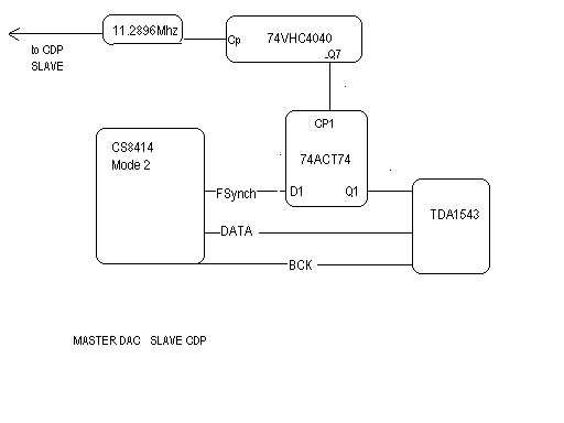

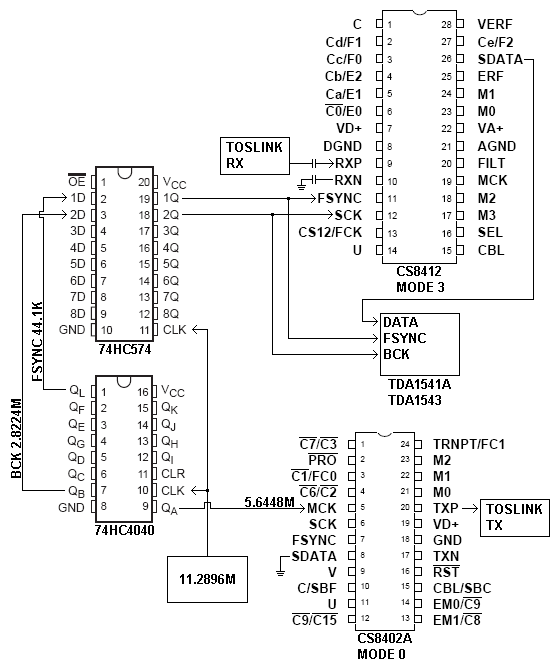

Hey.
Regal, the jitter-critical signal for tda154x is bck, not fsync.
Here is a fool-proof way of slaving, for tda1541a/tda1543 nos. Use it with a soundcard capable of locking to the spdif in.
Or mod your cdp with an spdif input and a cs841x to recover a suitable mck. The cs8416 can recover 384fs (16.9344M).
Alexandre

Ok the first diagram has an obsolete part CS8402A with TXP outputing a RS422 compatible line driver. The datasheet makes no mention of the clock coming out of TXP.
I like the second diagram, The 74HC244N looks like what I need. It should be something I could add to the DDAC1543 MKII SPDIF reciever board. That board is identical except he uses a 74VHC4040M to do the same thing as the IC1 and IC2 are doing here. It looks like he has the CS8414 in the same mode.
