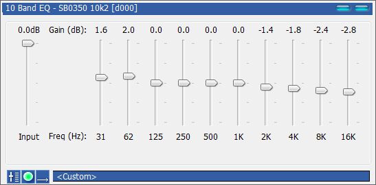

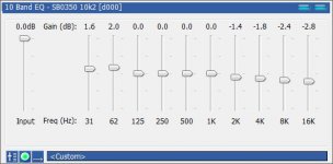

Most tweeters have a lot of weirdness at the top. Manufactures try to get the off-axis better by bumping up on-axis response and I'm not a fan.
It just occurred to me: why am I always turning down the treble?
Why not just put in the tweeter that I want to listen to?
That's why we build speakers right? Mostly?
Also I don't care how good a driver sounds.
If it's not built to my liking I don't put it in a speaker I'm building.
Also building things is kind of a waste of time, unless you have a lot of time to spare :eek: Just like everything in my life, it took me forever to realize that one.
Here's the EQ I use for almost every speaker I've ever had.
Not sure what is going on there.
