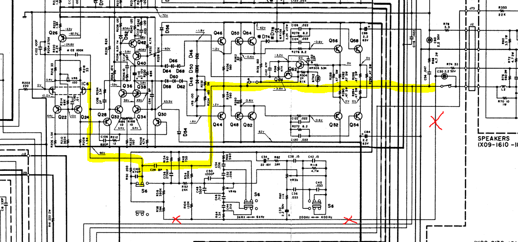

As its been a while since learning this can anyone check the schematic I've posted where I think I've highlighted the feedback loop in yellow, also the part with the red crosses is this part of the loop? If not what does this do? Also when the tone controls are switched off what does this switch into the circuit?

According to the schematic posted the voltage at the emitters of of Q32 and Q34 is 6.4 V. You should check that as 7.2V vbe is out of line with base to emitter diode voltage which should be around 0.6V
Q28 and Q30 set the base voltages for the above transistors. The value for those is shown on the schematic next to Q22 but the figure is indistinct.
The part you highlighted is just an 8pF (is it 8?) compensation cap that is permanently connected.
The feedback proper is in parallel to that cap and via the whole network below it which is the tone control circuit and its switchable turnover frequencies.
When you switch the tone control out of circuit you retain the path you marked in red which then connects via that lower left resistor feeding into the left hand SW6 switch.

The tone control section would be in the nfb decoupling arm to earth. There should be a switchable RC divider that substitutes for the tone control decoupling arm.

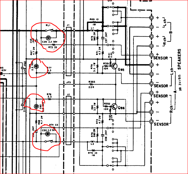

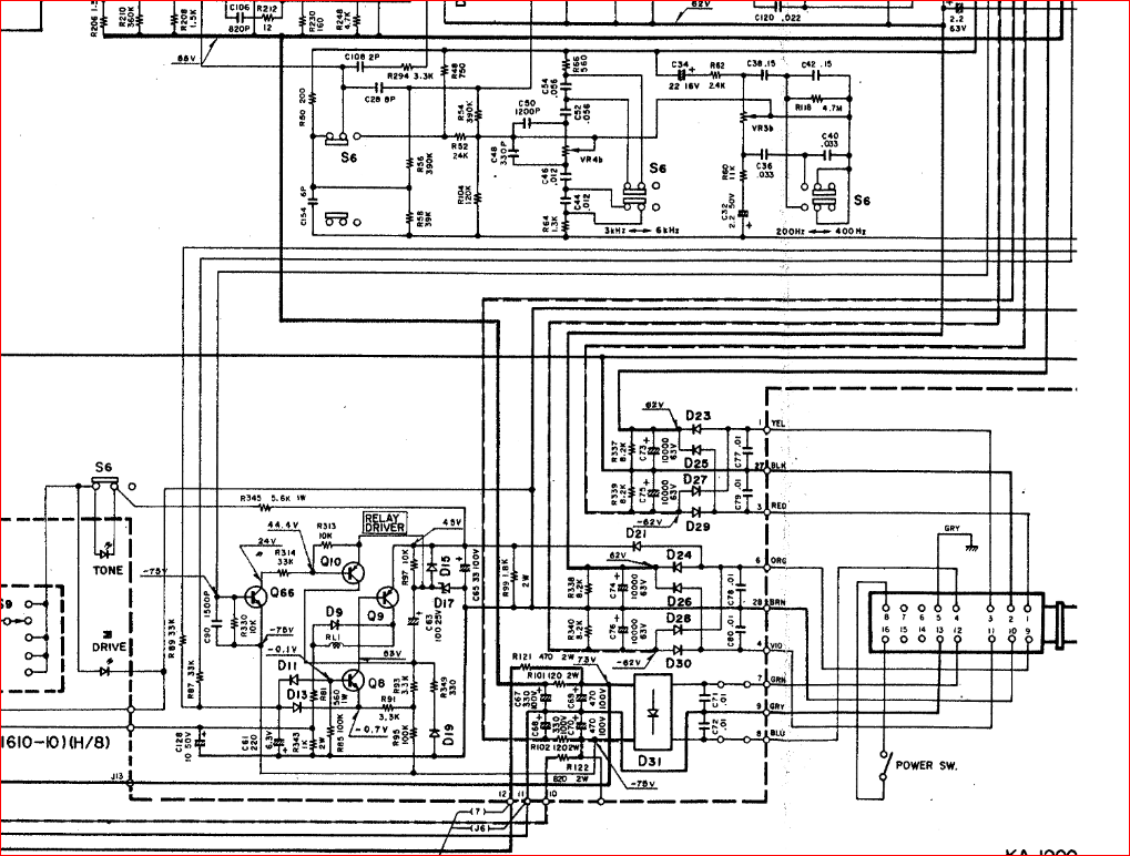

The tone control switch has a gang that connects to the relay control circuitry There is a pair of 2u2 bypass capacitors across the contacts.
Q66 and Q10 appear to lead to the headphones suggesting these deactivate the relay when the jack is inserted in the socket.

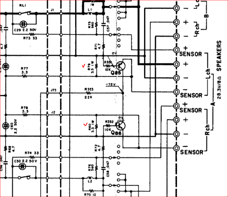

Furthermore there are 2u2 capacitors C59 and C60 on the live side of the relay for each channel with connections between the sensor and normal output terminals positive and negative for each respectively.
If any of these are not are not making proper contact the offset change in balance between Q85 and Q86 then the effect via R365 to the base of Q66 would cause the relay to drop out.
