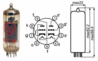

Yes it is. Infact I checked the overall dimensions of these tubes and they match with ECC99 (ECC82 is shorter). I don't know ... but I imagined JJ assembled the inner parts (plate, heater etc...) into a wrong envelope.
I also checked the heater resistance: it's some 5.5R while ECC99 should be 800mA/6.3V=7.8R
I can't imagine anything else to recognize this valve.

I use ECC99 in my preamplifier. Very nice valve, and I never had any problem with the biasing. I use with 120V/8mA bias.
It has nothing same as ECC82.
The heater 5.5R. Yes but this is the COLD resistance. Let's measure any other valves, any You will get less resistance, than the calculated.

Here is the picture of ECC99:
I selected the ECC99 after all the positive impressions I read and I would stay with it but ... I am going to report the data to the distributor to see what they think about it. Let's wait and see.
