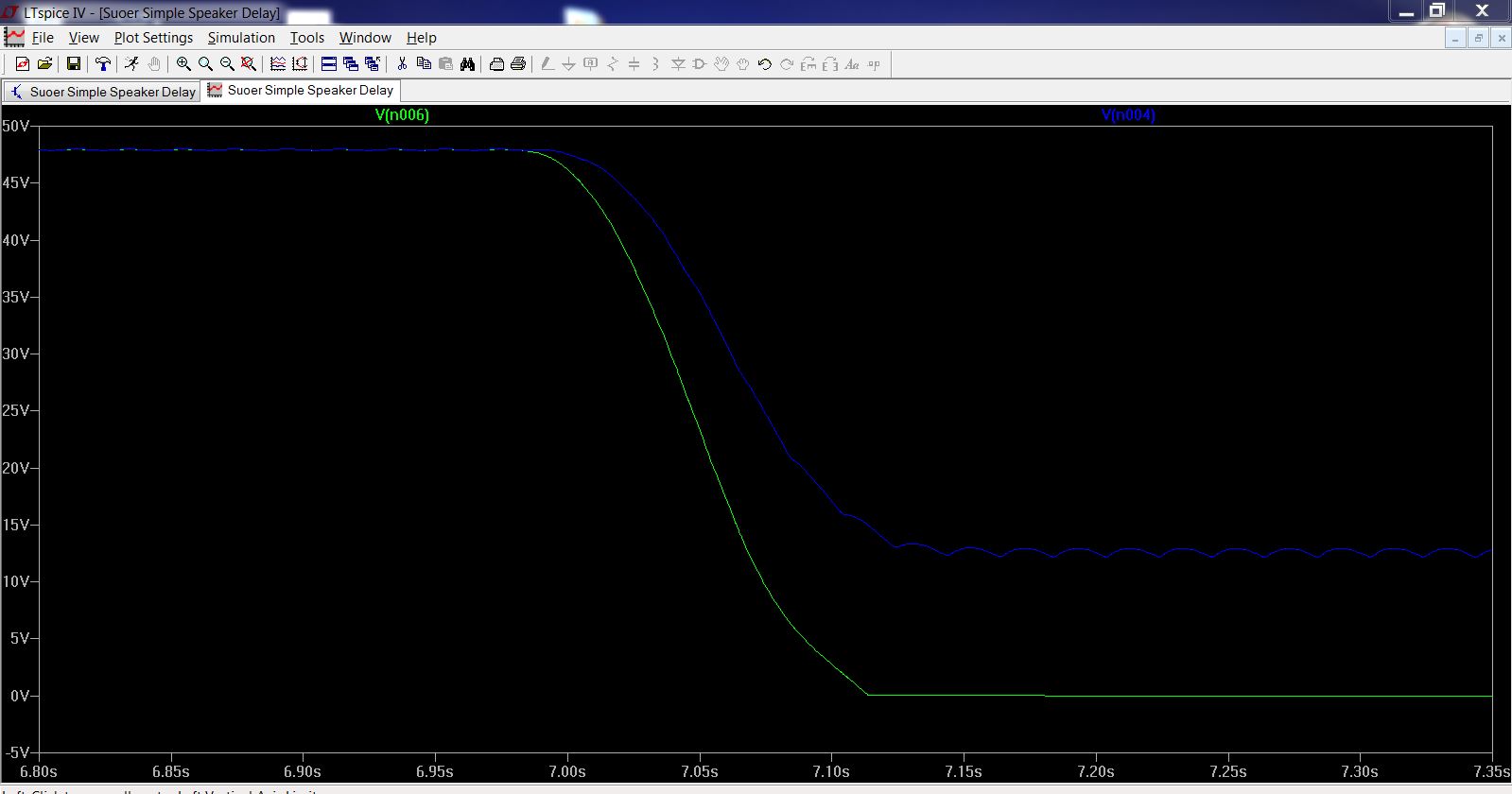

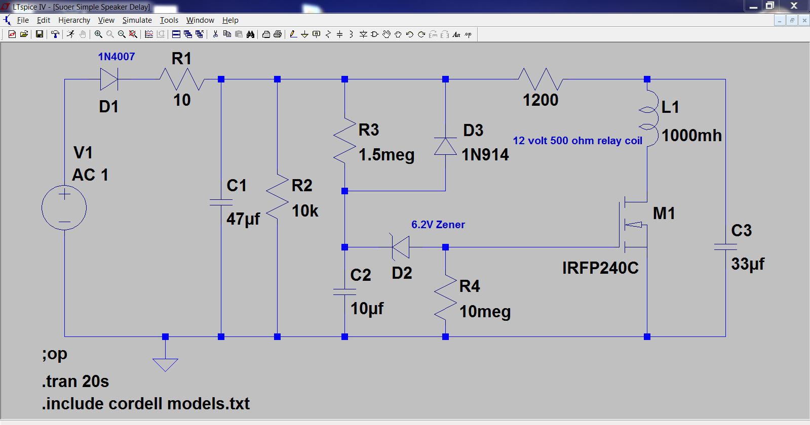

Here's a super simple version using a single FET. As the gate threshold voltage is passed the FET conducts. Use of a FET means we can use small currents in the timing network, in other words high value resistors and small caps.
Look how slow the switch on is as the gate voltage increases. The same effect happens with an ordinary transistor except here we talk in terms of current rather than voltage.
This slow switch on means the 33uf cap dissipates its charge slowly and doesn't kick the relay closed. We have no power saving here, The 12 volt relay needs 12 volts.
That said its a very workable circuit for those that want the simplest approach.
Can you see why D3 had to be rearranged to discharge the timing cap on switch off ?

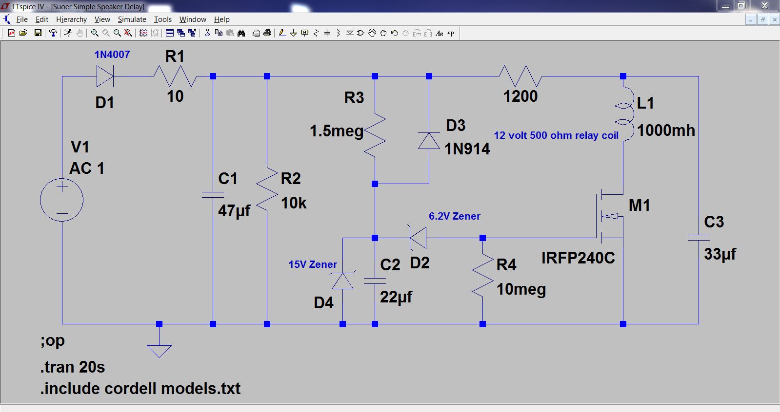

Edit... the zener is actually a 15 volt and not 6.3 as in the blue text on diagram.

LT Spice simulation does not confirm this transistor being too slow behaviour....................To use a transistor we have the problem of the device coming "slowly" into conduction as the base current increases. That means the relay current increases relatively slowly and so the charge available in the boost capacitor is "wasted" and is non effective. To get the relay to work reliably like this would mean ensuring that the relay is fed with its rated coil voltage when the transistor is on. We couldn't use the same power saving technique because we couldn't get the contacts to "snap" closed like we can with the triac.
My ear "hearing" the relay click over also confirms a very snappy action using the resistor + capacitor triggering trick.
I have been recommending it for a long time.
Use 50% more voltage than the relay rating and insert a resistor of value between coil resistance (for 75% running voltage) to twice the coil resistance (for 50% of running voltage).
I have not experienced any slowness in the transistor switching action using this technique.
But the transistor must be saturated, i.e. the predriver transistor must deliver ~ Icoil/10 to the base of the switching transistor.
If a 12V relay has a 300ohm coil then 40mA is the rated coil current.
Using an 18V regulator as the circuit supply with a 300r resistor in the relay coil route then the predriver transistor must supply 4mA to the switching transistor and the final voltage across the relay is ~9Volts and the final current is ~30mA. Simulation generally shows that the "current pulse" from the overcharged capacitor is at least 3ms long and this exceeds the ~2ms closing time quoted for these relays, i.e. the cap enhanced current lasts longer than it takes for the relay to complete it's changeover action.

The Super Simple Circuit is actually missing a vital component which I've just spotted... the hazards of designing a circuit on the fly. The Vgs of the FET could be exceeded depending on supply voltage so a 15 volt zener added. The 6.2 zener now really is a 6.2 volt device. Sorry about that folks 🙂
