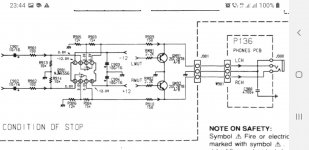

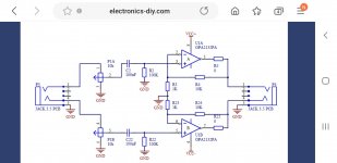

Here's cmoy schematic first picture based on opa2132, and Marantz cd 63 hp schematic(second picture) based on njm4556 with much lower gain.I'd say that if you go with a bipolar op amp it's better that the resistor from pin 2 and pin 6 to ground to be decoupled through 100uF capacitor .Njm4556 doesn't really need it as it doesn't have real problems with virtual ground bias either because its bias current is actually lower than the residual leakeage current of a very good wet electrolitic capacitor including nichicon muse bipolars thus the output offset is not significant.With njm4556 you might not even need a bias resistor to ground in pin 5 and pin 3...although it's better to have it.Jfet op amps like opa2132 never need bias if the signal is coupled through electrolitic capacitors.They'll use the cap's leakage current for that.Still...better wisdom is to use one in case you're going to use a low value input film capacitor.

Good quality capacitors are low ESR ones, right? I do have the Panasonic M-A 100U 25 Elco, 100 uF, 25 V lying around. I see that the schematic for the Marantz cd 63 uses a much higher value resistor for the gain feedback loop compare to the one I’m currently using; 12k instead of 4,7k. Does that make a big difference in output?
Do you also recommend using the OPA2132PA instead of the Njm4556? Or just to switch them around to see what works best?

Opa2132 is better only if you drive 600 ohms loads so you need to know your headphones impedance, the series output resistor, the needed output voltage and the min supply voltage that will allow for enough headroom so that the series ouput resistor allow enough voltage on the headphones.Usually with at least +-12v supply you can safely use 600ohms headphones or 330ohms output series resistors and 250...300ohms headphones or 620 ohms output series resistors and +-15v supply with high SPL 32 ohms headphones but some 32 ohms headphones won't get enough power and better use njm4556 with 150... 68 ohms output resistors for 32...64 ohms headphones.
Then the matter of feedback resistors is a delicate one.Your gain is around 5x, marantz gain is around 2x.They used higher resistor values because the older opamps in general were more sensitive to common mode distortions and one cause for that is the unequal impedance at both inputs.So they wanted to present both inputs similarly high impedances to minimize distortions sacrificing a bit of signal to noise ratio, but njm4556 has quite low bias current and it's not affected too much by the value of those resistors especially with such a low gain.
