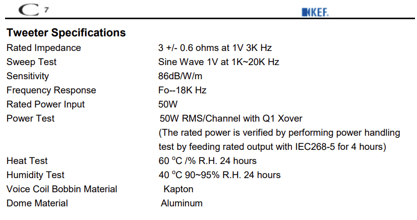

Searching the internet I found the following (which comes from the attached pdf)
The speakers are the ones at the attached picture. They have a front wooden/black painter plate to cover the speakers bolts.Tweeter is shown at the other picture.
Any ideas with what tweeters i can replace the old ones? Maybe a modification ?

It appears we need 4 ohm, aluminium dome, around 86 dB sensitivity and an appropriate physical size.
What is the size of the tweeter cut out in the cabinet and the size of the tweeter opening in the decorative front?
I can add that the crossover frequency is 2,500 Hz.
"KEF’s 19mm (0.75in.) tweeter and ‘tangerine’ waveguide is complemented by a pair of 165mm (6.5in.) bass drivers."
Perhaps you could enlarge the cabinet cut out and fit a tweeter which has a flat faceplate so you can fit it flush to the cabinet and not foul the fitting of the decorative front. The tweeter dome would have to peer though the aperture in the decorative front.
