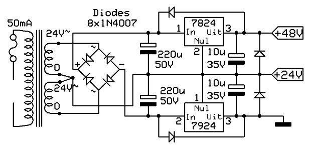

Why not doing it like this.No loss in big serial resistors.
Depending on the current needed the capacitors (220µ) could be smaller.
Mona

At eeweb.com I see a 0.4A regulator and no current limit exept from the IC itself ?
If you use a 78L24 in place of 7824 the current is limited to peak 150mA.Eventualy a resistance between the bridge and capacitor on the positive side so that the voltage drops below 50V (referenced to ground !) when the current reaches 100mA.
