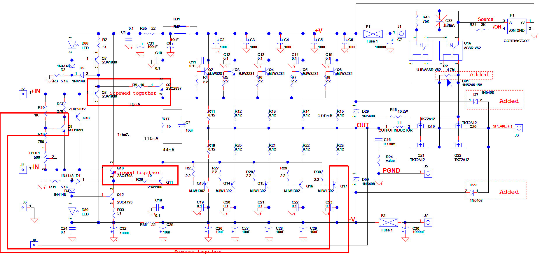

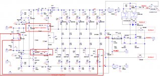

I have been spending a lot of time dealing with oscillation of my 3EF Diamond OPS. I finally have to cut the Diamond connection of the pre-drivers and connect them to the rail to get rid of the oscillation as shown. Now, it is a 3EF with FOLDED pre-driver stage. I don't know whether you guys encounter any oscillation problem with this, but from my finding, it is a real problem with the diamond design. I like to hear what are your experience.
Attached is my schematic. I just use one 2K resistor to pull J2 to +rail and 2K to pull J4 to -rail. then just drive the +ve input with a generator. I have no IPS/VAS, just the OPS with no GNFB, so any oscillation is local.
Attached is the schematic of the OPS. I believe the problem is the pre-driver Q8 and Q10 in the Diamond where the collector is connected to the emitter of Q7 and Q11 resp. The Ccb feed the signal back in phase to the base and create the positive feedback. The frequency is between 4MHz down to 500KHz depending on the length of the coax connecting from the generator to the input. This is not from the normal parasitic, the tell tale is the input coax has a lot of effect to the frequency of the oscillation, so it has to be from the collector of Q8 and Q10 feeding to the base and into the coax. I even try putting a series resistor at the base of Q8 and Q10, it did not help.
Before I connect the collector of the two pre drivers to the rail, I tried putting up to 82ohm resistor in series with the collector to the emitter of Q7 and Q11 to try to current limit, it help, but really depends on the transistor used. I changed from KSC3503/KSA1381 to KSD1691/KSB1151 resp. for reason explain later, it got really bad. I then change to 2SC4793/2SA1930, it is better but still oscillates. So I decided to move the collector to the rail to solve the problem for once and for all.
I managed to play around with collector resistor and RC loading to stop the oscillation with the diamond connection. But when I did the square wave test, I can still see the ringing. I don't think it is safe to keep the 3EF Diamond anymore. Now I really have a solid square wave output with only very little overshoot and die down after one ring.
I think the problem is the Ccb, the larger the capacitance, the worst it is. So I need transistor with low Ccb. BUT, the problem with the 3EF diamond is the bias spreader can only be about 1.1V, One has to be very careful in what transistor to use, AND also the pre-driver has to have very low Vbe in order to give more headroom for the bias spreader. The original KSC3503 and KSA1381 has Vbe of 0.66V, it really killed the headroom. that's the reason I had to change transistor. Problem is all the transistor with low Vbe are high current device and has higher Ccb by default. I settle with 2SC4793/2SA1930 because it has about the lowest Cob and have Vbe=0.58V.
Another problem is when I crank the frequency above 800KHz, the waveform at the output totally collapsed. I have to reduce the R17 to 15ohm to run the drivers at close to 100mA and increase the current of the pre drivers Q8 and Q10 to 28mA in order to increase the frequency to 1.5MHz before collapsing.
The symptom is actually the two driver transistor q7 and Q11 actually turn off at part of the cycle. I speculate that it's the 600pF Cob of the big MJW that actually hold the voltage and I need more tail current in the drivers to prevent the Q7 and Q11 from turning off. The frequency of collapsing depending on the output voltage amplitude of the sine wave. Since the OPS has gain of only unity, I ony get about 8Vpp output as that's the max of the generator. the higher the amplitude, the sooner the output collapses. So I expect the output will collapse at much lower frequency if I drive close to the rails.
Also, part of the problem is the folded pre-drivers that you can only have max current equals to the CCS used. This is another short coming of the Diamond.
Not only the problem of +ve feedback, the tempco of the spreader can be a huge problem. You only have 1.1V to play with. Not a whole lot of room to be creative. I am using two transistor CFP and adjust R37 and the bias pot to balance between the tempco and bias voltage. I am still working on it. I just finish taming the oscillation.
Anyone actually implemented the 3EF Diamond? You experience the low spreader voltage and oscillation problem like me? I would like to compare notes and see whether I missed anything.
All in all, I think it's worthy to spend the time on this folded 3EF as the tempco of the pre driver and the drivers cancels out really well when I screwed them together. It just take time to fix the short comings. I don't see any disadvantage using just the folded 3EF instead of the 3EF Diamond, the main thing is the tempco cancellation of the pre driver and driver stage and the spreader only have to worry about the power transistors. The folder 3EF will do just as good a job as the Diamond.

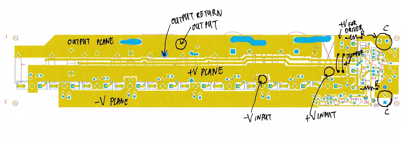

Layout is everything. I layout pcb for circuits for hundreds of MHz and RF for a few GHz. So this is nothing new to me. Attached is the components and traces, the power and output planes layout and the ground plane top layer. You can see, other than the two driver traces and the two input traces that is longer, every signal trace is pretty much point to point. That's why it looks so simple for a big circuit. This layout is good for many MHz.

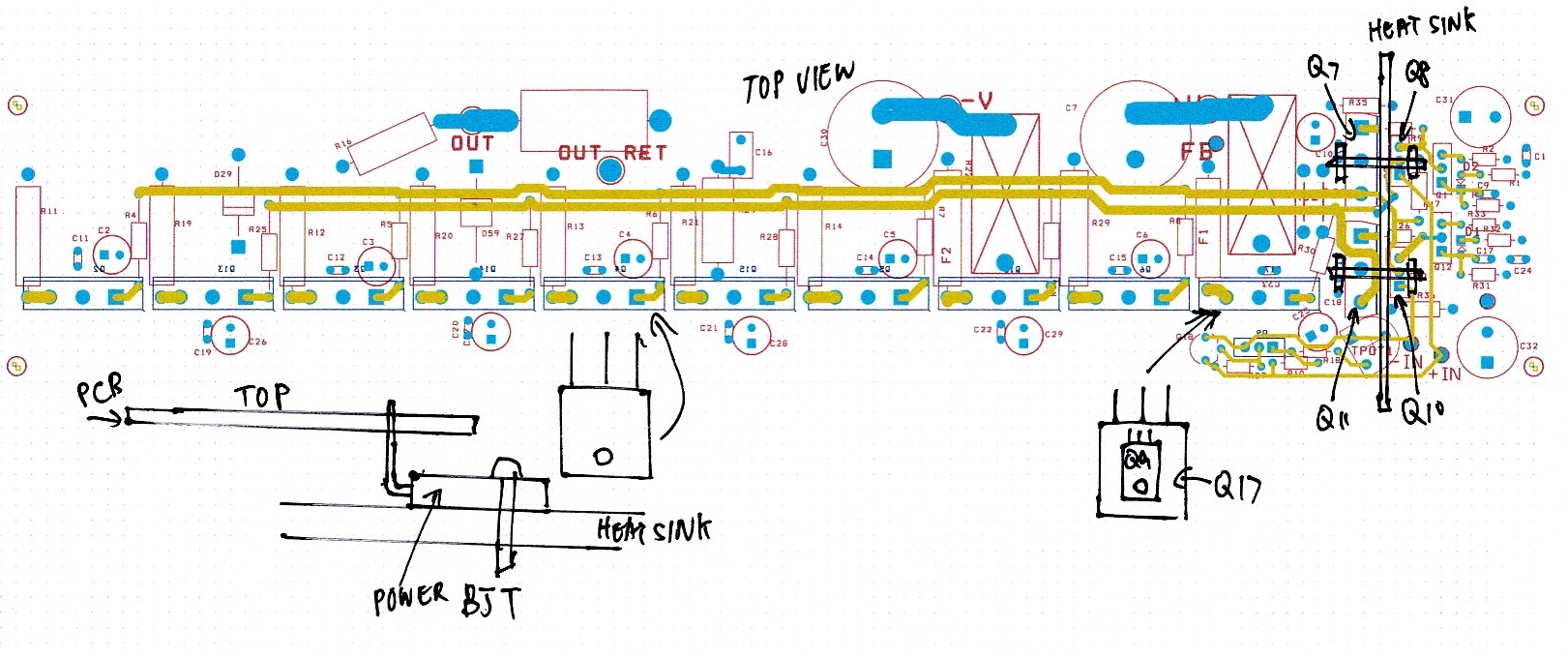

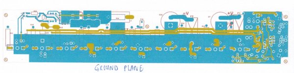

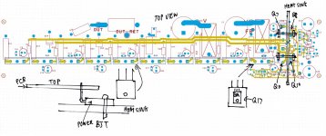

I have 0.1u and 10uF cap point to point from all the collector of the power transistors to ground plane, I make sure I don't accidentally have holes on any of the planes that create current loop. Layout is NOT a problem. As I said, the frequency is very low, any oscillation caused by ground loop on traces will be at higher frequency, not vary from 4MHz down to 500KHz.
