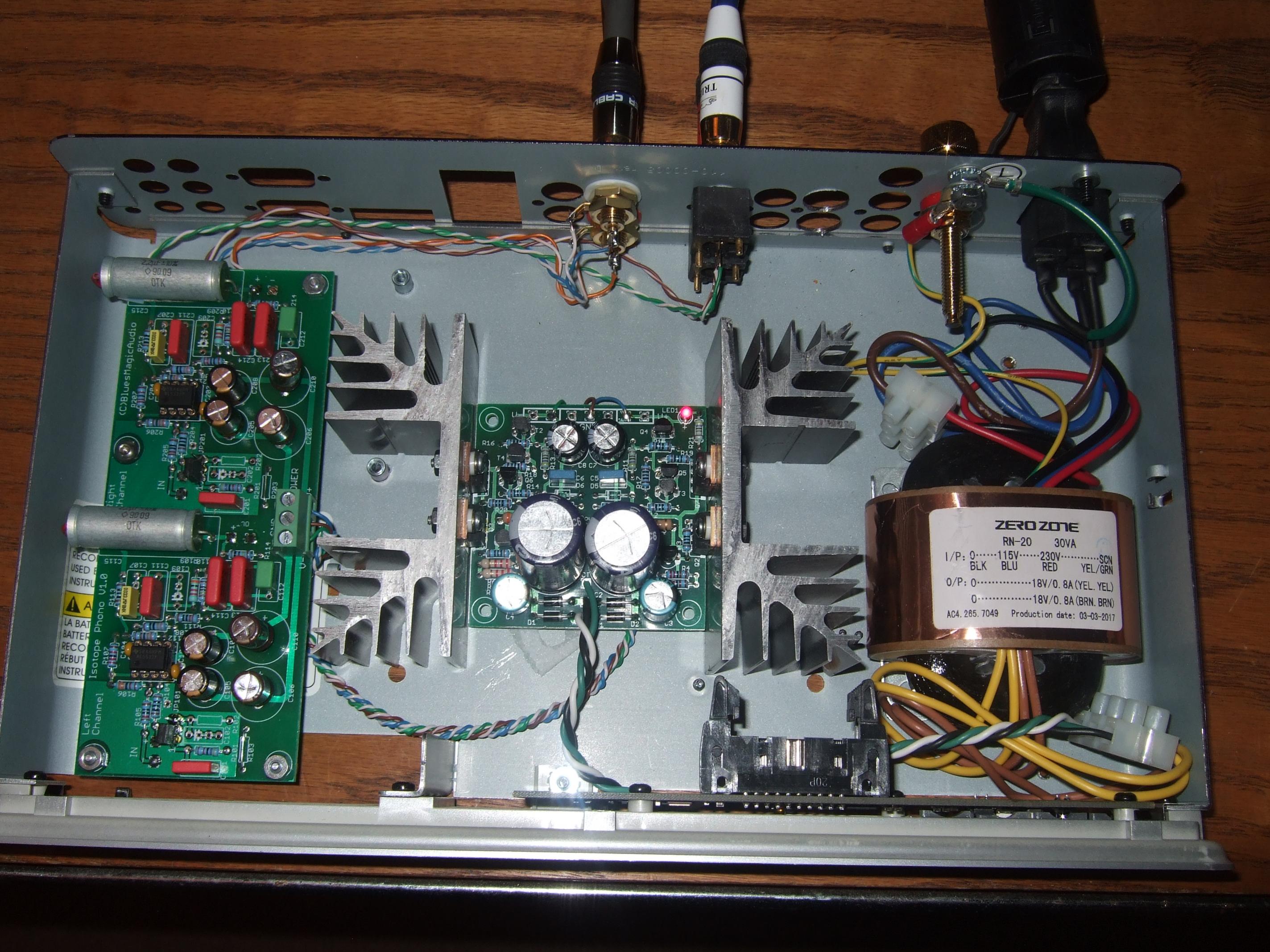

I bought the boards for the Isotope preamp and shunt power supply a month or so ago. I was waiting for a suitable cigar box to show up but so far nothing has inspired me.
I soldered together the boards a couple of weeks ago. Yesterday I ran out of patience and grabbed an old Control4 controller box, ripped the circuit board out of it, cut some heat sink and cobbled together the preamp. I know, it looks like crap, but I was in a hurry.
This is such a musical preamp! Even in it's thrown together state it is dead silent. The music just strikes me as realistic and so enjoyable. I don't think it worth the effort to wax poetic and throw out a bunch of superlatives. I am thrilled with it and count it as a true bargain. It was simple to build and door666 was a joy to deal with.
