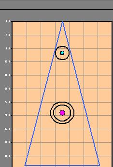

I have a pair of equilateral tetrahedron speakers, which have been destroyed in the course of history. I want to keep the tetrahedronal concept, but design them better. The picture is the front baffle with a 6 1/2" Vifa P17WG00-06 and a Vifa D27TG05-06 aligned.
There will be a total of 4 baffles (if this idea survives). The bottom one will be an equilateral triangle of 21" or so (it needs to be reasonably narrow). The other three are shaped exactly the same, like the one pictured, creating a reasonable volume in the shape of an isosceles tetrahedron to let the woofer speak. You basically see the front baffle, and that's it, as shown. However, as was pointed out, it's hard to come up with enough volume in a tetrahedron.

Tetrahedra are soooo sexy, though. The wife wants them painted white with pictures of clouds and rainbows on them.
