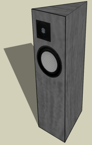

Back a little over a year ago I decided to design and build a two-way speaker system. The primary goal of the project was to use my basic understanding of wood working, electronics and sound to the reach an acceptable end result. To that end I think it was a great success. The system sounds good and I learned a lot. But after all the learning and experience I knew I could do better.
The basic flaws with the current design are two fold. One is a serious diffraction around 2K and the other issue is box resonance related. The diffraction issue is because the tweeter is located in the worst possible place on the baffle dead center to three sides. SPL measurements show it clearly as it is audible. The later issue is a little more subtle in that the mid-bass has a muddiness on most music material that ruins the overall illusion. It’s not in your face there but it becomes apparent during listening sessions. My believe is that this is related to panel resonance and/or standing waves in the box. I have given some thought on how to control the later without a new cab design but I thought it better to create a design that minimizes the issue to begin with and while I am at it correct the diffraction issue as well.

So I’ll start with a name, description and a picture and see what happens…
Isosceles
A two way closed box design using the C30-6-23 and C173-6-93 Accuton drivers.

I will point out such a cabinet design is extremely volume inefficient.
You'll probably end up with as much wood as you have airspace.
Not only that, triangular sections do not kill resonances, treating
the angled faces as a mirror you are back to a box and the usual
resonant modes of an orthogonal box somewhat modified.
FWIW with adequate damping the internal standing wave modes
of a box are a non-issue. Panel resonances (and consequently
panel transparency at certain frequencies) are the more likely
cause of your percieved problems.
/sreten.

I haven’t work out all the volume requirements for the bracing but the current cab dimensions on paper are 33 X 9 X14. Those dimensions provide about 33 liters of volume. About twice the amount of the final Vb target. Plenty left for bracing, drivers and cross over components. I agree with you in that as the Vb requirements increase the design becomes less practical.
But they do reduce them no? I think I understand what you are saying in that the geometry of the design can also be thought of as half a rectangle.
I had this idea to measure the modes in the box. Simplistically I could think of having a mic inside and measure SPL at various points. I would like to see what the effects enclosure shape and damping material have on the box modes. (If you or anyone else has thoughts about this I would like to hear them.)
I think adequate is the key word there. What is adequate for a given enclosure design type? Some say they have experienced that speaker materials have influence on how much sound from escapes from the box. The other factor I have observed is a reduction in SPL as the stuffing density increases. Or maybe I am just thinking about it too deeply.

You may be right. All the more reason to design a new cab!
Panel resonances (and consequently panel transparency at certain frequencies) are the more likely cause of your percieved problems.

crazyhub said:or unparalleled walls allowing standing waves to develop in the height of the enclosure (ie your isosceles ttruman).
ouch! Geez crazyhub I havn't even posted the first draft of the internal drawings.
But I somehow get the feeling I may be getting in over my head already.
In any event my idea to correct that was to place a pryamid at the top and bottom of the cab. I hope that is to your liking.
BTW your speakers are very impressive. I am very interested in how to eliminate standing waves in a box but I fully admit I am not well versed in this subject. However I am willing to learn and that's why I am here.
