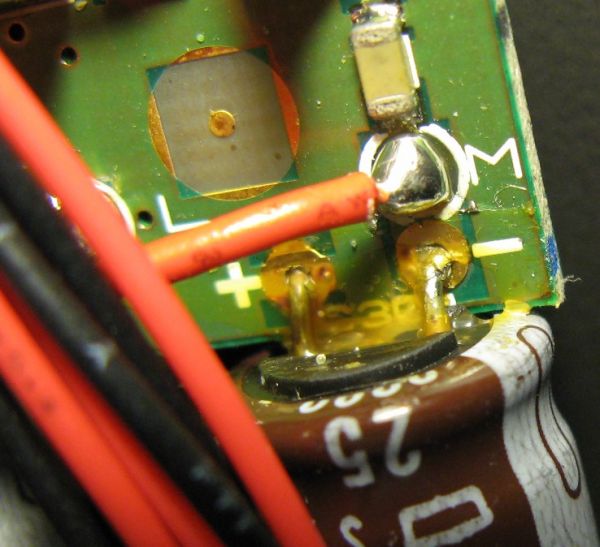

I've had a look at the caps and while there is contaminant at the edge of the PCB, I'm not entirely convinced this is leakage. Can anyone confirm for me from this photo?

I cannot open your photo....
It's hosted at another forum and you have to be a member there to view it.
Hi John, I've tried toggling the clock lock switch, but it was in the correct position in the first place. The DAC had been performing perfectly until one night last week when the noise began midway through a track. This certainly suggests a component failure.
I used a tablelamp last night for lighting on the poor quality photo - I can take further photos in daylight if required.

The "Stuff" around the capacitor is just "Glue" to hold the Cap in place - no problem with leakage.

Glue to keep the cap from vibrating. No worries.
