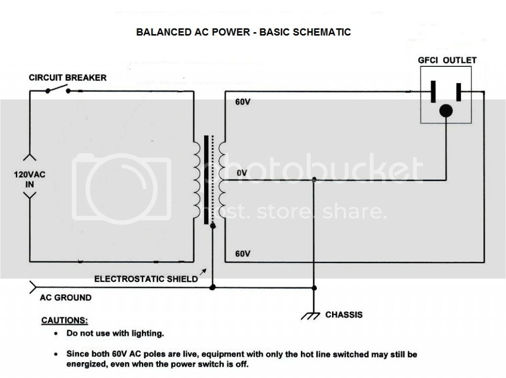

The isolation transformer in question is referred to as a Balanced Power Transformer. I've found the following information, but do not have the expertise in this area to judge whether or not it will be helpful to you.
"Balanced Power Transformers are designed with a center-tapped secondary winding which consists of two identical, mirrored secondary windings in series and an electrostatic shield. When the center tap is grounded, these two identical windings short circuit the equal amplitude but opposite phased noise current and greatly attenuate (low to medium frequency) common mode noise. The ground noise amplitude goes to zero, allowing audio to be free of noise interference."
A basic schematic of such a device is attached for interested parties.
That shows the primary as not being grounded. If it was grounded it would not truly isolate the two sides. As shown it is an isolation transformer however you are picking up all the crap on the ground and putting it on the secondary.
