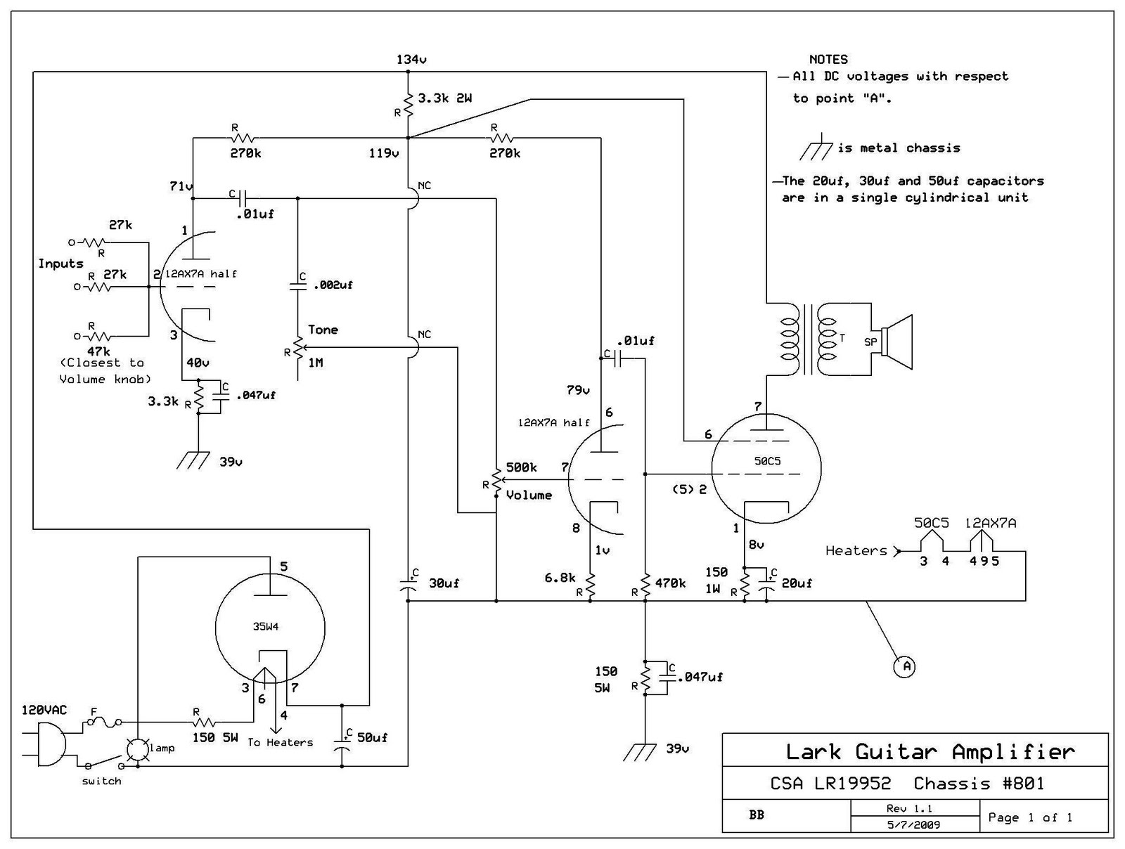

I'm installing an isolation transformer in an old pepco tube amp (this one's labeled Marlin), and i have a question about general approach.
it's my understanding that i want to ground the amp's chassis using only the ground connection on the 3-prong side of the isolation transformer (IX), so it makes sense to me that i no longer want the amplifier circuit to be connected to the chassis anywhere. everything that was previously connected as a ground or neutral plane should be together, but floating from the chassis.
thankfully, there were only a couple of components that were visibly soldered to the chassis, so i used a spare tab on the terminal strip to connect them together.
now i've realized that the 4 inputs are still grounded through the chassis, but if the chassis is only connected to the ground on the 3-prong side of the IX, they won't be connected to the ground plane of the rest of the circuit. i can't find any mention of this separation in the discussions i've read online.
is it ok to have the chassis connected to the neutral on the 2-prong side of the IX as well as the ground on the 3-prong side? do i need to isolate the inputs from the chassis, and run separate grounds to the neutral on the 2-prong side?

The amp is a chassis 801, so identical to the circuit here:
https://www.diyaudio.com/forums/att...chassis-isolation-mod-lark-schematic-v1-1-jpg

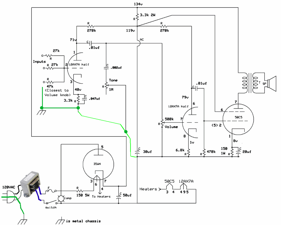

what i've done is try to take the chassis out of the circuit by removing the 2 grounds (both labelled 39v) from the chassis, and connecting them together. what's omitted from that drawing is the ground sleeve on the 3 inputs, which are grounded through the chassis, just by contact.
i'm thinking i need to replace the input sockets with isolated sockets, and them run ground wires to the same place i connected the other 2 grounds. that way the entire circuit is isolated from the chassis, and then i can ground the chassis by itself. am i overthinking this?
That is a very tangled drawing of a very troubled amplifier.
They "separated" 1st-stage common from amplifier common to "reduce shock hazard". This is an intermediate step from true Death Traps to the later fully isolated cheapo amps. (Was this form actually sold in Canada? Or did it leak over the border?)
It needs some significant re-wiring to make a happy little SAFE amp. All the internal commons tied to each other (losing the R-C network which does not even look safe). The chassis ties to plug Green. Wall-power white and black ONLY to isolation transformer.

PRR, That's exactly my plan.
What I've found strange is that in all of the discussions of these amps that I've seen, there's lots of discussion about what the connections at the transformer, but not the other connections, like the chassis.
It made me wonder if for some reason it's ok to have the ground connected to the circuits on both sides of the transformer. It didn't seem right, so I decided to ask for clarification.

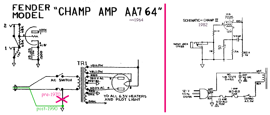

> connect the house ground to the floating side of the isolation transformer.
Correct for any modern amp.
Keep a clear distinction between "Ground" and "Neutral"!!
In the attached snip-shots you see that a 1964 Champ ha NO ground pin (cuz most outlets had no ground). However even by 1990 most outlets had the 3rd hole and most-all stage amplifiers had the Ground pin tied to chassis AND to the circuit common (the part of the jack-cord you touch).
