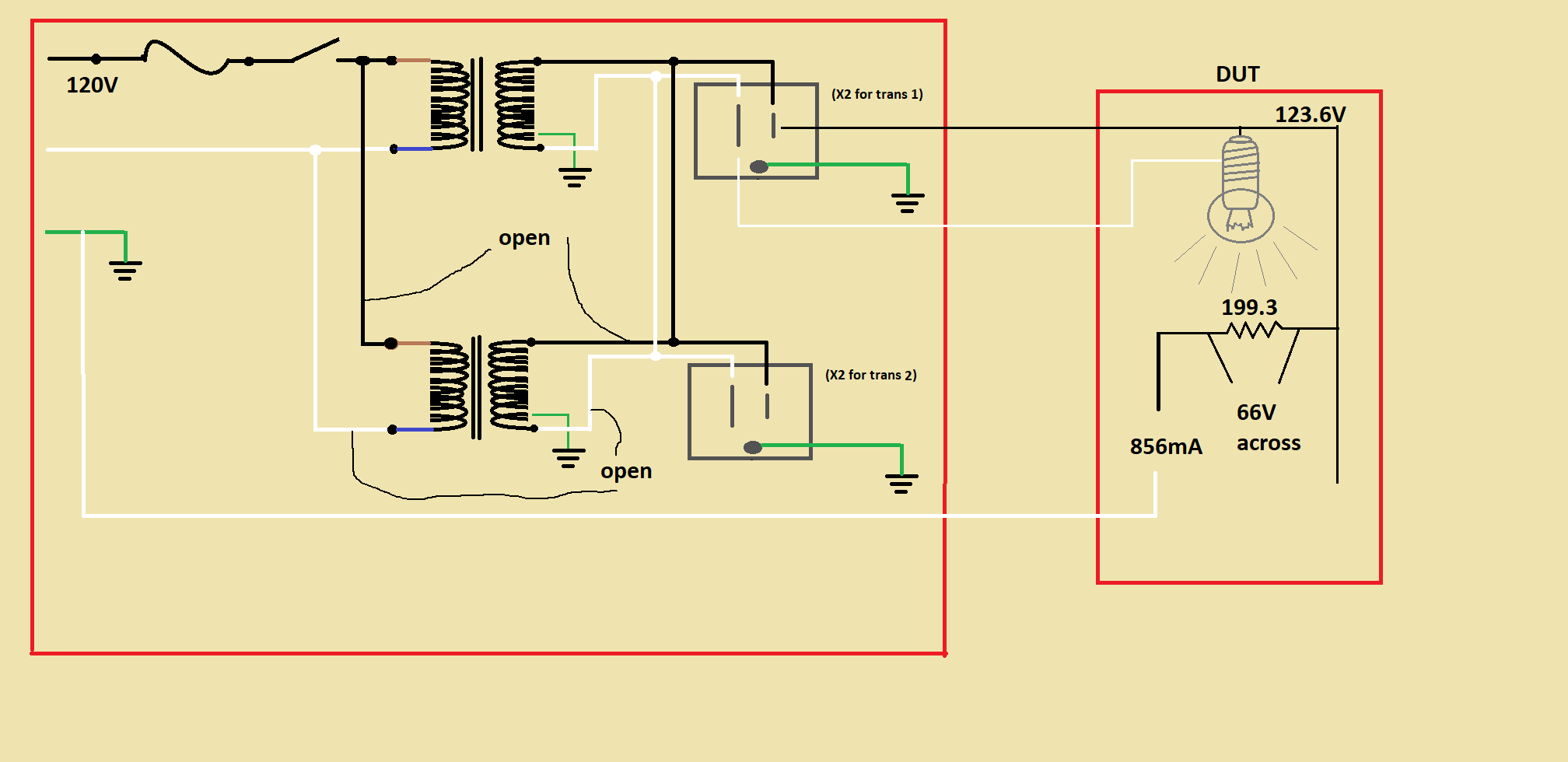

> 120v .....dead short with my volt meter from the hot leg all the way to my mains house ground get 68.3 volts... ...I put that 68.3 through (2) 100ohm 5w resistors which measured at 199ohms and measured .910 AMPs..
Does not add up.
0.91A in 199r is 181 Volts... more than you have in the house. 68.3V in 199r ought to be 0.34 Amps.

What do you get from the neutral leg back to input side ground? Also as a sanity check measure the voltage across the resistors to confirm the current. You should also check DCR from a primary to any secondary. It should be open.

Attached is what and how I measured. I must be missing some fundamental physics lesson..
Added to the circuit the outputs of the secondary's are in parallel behind the outlets. thought that might be important to know...
The voltage drop across the resistor in the DUT and its resistance dont add up to the amperage measured. Ohms law isn't wrong, must be me.

Lesson learned! When measuring amperage DONT FORGET TO MOVE PROBE ON METER TO CORRECT LOCATION!
Had .2 volts from hot leg of dut (light bulb @123v) to house earth/neutral, and 0 amps to house earth/neutral!!!
Lesson will never be forgotten...

That makes lots more sense (and now you know the quirk of your meter. I have several and the one I used most recently reads zero if the probe isn't moved on amps.)
