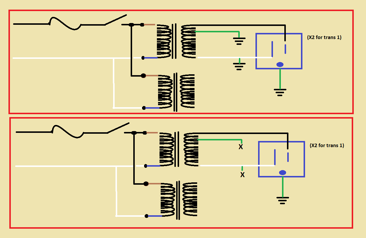

Ok, again... I am a buffoon. I said float the scope, but SHOULD have said float the DUT.
The attached image, shows 4 outlets in my rig. 2 toroidal's in parallel.
The top image shows the stock setup.
The bottom shows the modifications I made. I had to disconnect from the chassis lug, and heat shrink over every ground marked X.
I think I figured out that the secondary's ground (green) was tied into the neutral somewhere deep in the winding. None of the schematics I have seen showed this....
For those who wonder what this is all about, its almost gets you to
"bird on a wire" around high voltage. If you keep one hand in a pocket, you may fry a finger or hand (if you close a circuit with your skin) but you shouldn't get any unplanned electric through the heart action...

This is a start. I suspect the green wire is a shield. If it has no dc resistance to ant winding then it's a shield. However it may be a center tap on the secondary but then connecting to the White wire would short the secondary which would be bad. Floating the secondary is OK but won't offer any new safety protection unless the chassis is "hot". If the green wire is a shield then open its voltage will be determined by the interwinding capacitance. It should return to a ground to block some of the emi on the power line.
What I think, the green is connected to the neutral. A single wire as a shield in a sea of copper wingdings, couldn't do much... And the factory wiring clearly had it tied to the chassis.... If its connected towards the end of the line, say just before the white leaves the winding, it would be the same as the neutral and grounds connected in your fuse panel. The only way for me to disconnect the ground from the the actual plug to the isolated power supply and the neutral of the isolated receptacle was to disconnect the green from the secondary winding and chassis..

With power removed, a dc continuity check with a multi-meter should establish if there's any connection of the green wire to any other winding Assuming there's no internal joining connection of the green lead, i can't imagine anything other than a shield. This shield is often a foil layer with a lead brought out.
If the continuity check confirms a tapped connection, a couple of ac voltage checks re the green lead should establish where the tap's relative position is located.

Does the green wire come only from 1 transformer? Shielded toroids are less common, substantially more work to make.
I cannot emphasize enough how important a GFCI would be in this application. Even better an arc fault GFCI https://www.amazon.com/Leviton-AGTR...MTN4?source=ps-sl-shoppingads-lpcontext&psc=1

The green comes from both secondary's on the toroidals
I fail to understand the GFCI protection, may be I misunderstand its function.
The ground after an isolated circuit is completely removed from the circuit, not in physical sense but in physics. In a normal house hold circuit, the neutral IS tied to the ground. The electrons from the power plant simply want to have a path back. In a normal circuit, the earth presents it self as a path that is supposed to provide less resistance than your body (say a restive short against chassis).
The GFCI acts when the current through the hot leg does not match the current in the neutral. The only way this can happen is when neutral is also tied to earth. Now the electrons can flow through the ground lug, and cause an imbalance in the hot and neutral, tripping the circuit open.
All can think of that would allow the isolator in question to function like this would be to add a pig tail on the neutral (white) on the secondary and have the pig tail tied to the ground lug on a GFCI outlet?

Right now, Im going to reread previous posts, open the isolator back up, take some measurements. I'm curious if the green is a shield or..
I dont want to keep making changes, or modifications unless Im 100% confident...
All who said Green was a shield were 100% on the money!
There is no continuity between that and any other connection inside the box...
After reconnecting it to the chassis, neutral on the secondary and the chassis are not connected at all.
To change to GFCI or remove the earth to chassis connection will require new receptacles... the lower bracket that holds the receptacle to the chassis is using one screw that also doubles as the ground wire lug..
Not the only path. Current could make it's way back thru leakage to other circuits.

A GFCI triggers at pretty low leakage current, 5 mA which could be leakage or who knows what. Still low enough that you won't get seriously injured. You use it because you could have a problem with your DUT OR your power source has some internal breakdown. The Arc fault feature would help protect and spot bad or shorting connections, not unusual on vintage equipment.
If you have the tool you can measure the capacitance between the shields and the secondary. Them measure the voltage between the secondary taps and the shield with a hi-Z meter to determine which end of the secondary is closest to the shield. This would minimize the leakage current if that end is used the neutral, usually.

If there are only 2 wires from the secondary on the isolation transformer (hot and natural) what path would you be talking about ?
Even if the Chassis is grounded, that ground has no reference to the secondary (right now anyway..)
Am I still missing something ?
There are still leakage paths plus the hazard of an unintended breakdown in the transformer or internal wiring in the box. Its more important if you have a grounded center tap, another popular isolation configuration. Probably it would not be necessary, like fuses, until it is.
Let me touch on another misunderstood aspect in power wiring. That ground connection is a safety feature. Its function is to shunt any short paths to ground AND create a fault current enough to blow fuse/open circuit breaker and protect user/equipment. Noise considerations are secondary. And I much prefer the 5 mA trip of a GFCI to the 15A+ of a (US) residential circuit breaker when something goes wrong.
