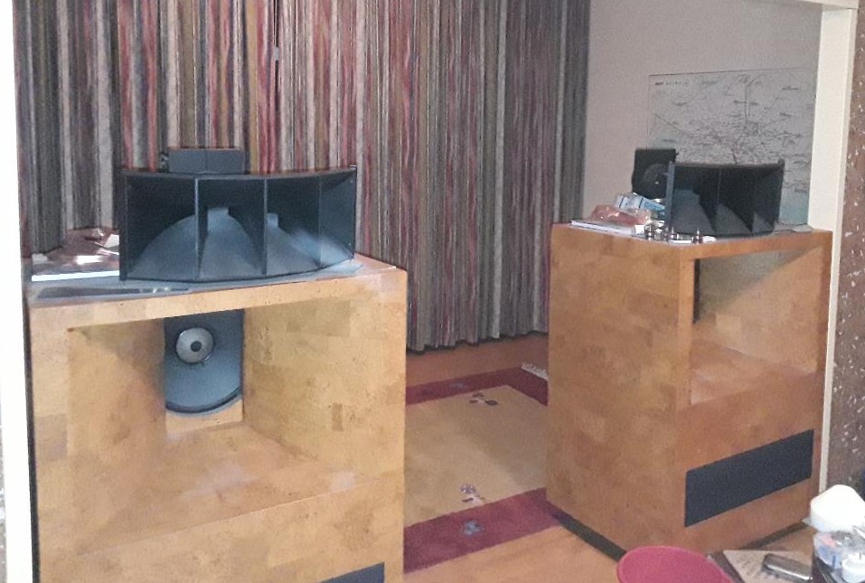

Hello,
I am looking for some diy solution or non audiophile price ( so general purpose) so isolate my Altec Vot cabinets they are above 100 kilogram( 220 pounds) . I have no way to check the weight. So it could be a bit higher. Maybe i will add a bag of sand on top lol but i need something to give a better isolation than the rubber wheels.
Something like a ''pile '' of 4 square inch of 3.5 mm 1/8 inch thickness cork ''sheets '' like the ones on my wall or get some thicker cork panels normally used for temperature/sound isolation? I can make a sandwich of cork and lead sheets.
Any ideas are welcome.
Greetings,Eduard

Have to check if i can use 3 or 4 because the '' weight division '' bewteen left and right is identical but i think 75 % of the weight is on 50% of the depth. I mean the center of gravity will be not be in the middle . Let us say the depth of the speaker is 60 cm the center of gravity wont be at 30 cm from the front but at 40 cm from the front.
Maybe i will make a 20 30? kilo lead bar that i can locate under the wooden horn on top of the cabinet as close as possible to the front side of the speakers so the center of gravity will move in that direction too. Of course the further the feet are apart the better the stability will be and of course all the feet should have a similar load.
Greetings, eduard

Probably i will melt some lead into a probably T shape mold where the upper part from the T will cross the entire cabinet from left to right side and being located in front of 515 loudspeaker cone and the lower part of the T will cover the area under the wooden horn that is placed on top.
Distributing the weight in such a way that the center of the weight will move to center of the 66 centimeter total depth of the cabinet will allow me to put the 3 or 4 feet further apart which will give a more balanced situation and for best results the load on each '' foot '' should be close to identical.
Right now i have to find out which durometer to go for. I general it seems sorbothane is working better than rubber. My diy cabinet is sand filled so it does not vibrate as much as the original VOT but getting rid of unwanted vibrations ( sure the lead will help) will also make the wooden horn on top better.

I just checked the bottom side of my cabinets it wont be difficult to add a kind of lead bar underneath the box to have a more uniform spread of weight. The lower the position of the weight the bigger the effect will be on the stability. And then use a thinner thickness of lead on the top plate.
It wont be difficult to hang the TAD2001 PBS on 3 '' strings '' attached to the ceiling
Greetings, Eduard

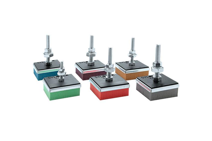

Hello,
I did not get an answer from Sorbothane so i also looked around for other solution.
I can across a rubber based feet to be used for all kind of noisy machines. With the following property.
Natural frequences of the anti-vibration elements between 5 and 11 Hz
Also came across a sylomer foot with a little different frequency range
Natural frequences of the anti-vibration elements between 11 and 24 Hz
When i constructed the cabinets i already installed 3 M10 threaded metal '' elements that i can reach from the outside so if i lift up the speakers it will be easy to insert a M10 bolt or threaded rod.
Like i wrote before i will use some lead to create a similar load to each foot
Will it be good to use a set of 3 feet let us 15% above the minimum load or 15 % under the maximum load?
I hope the properties of the sylomer ones are better for audio because i like the looks.
There are also the ones using combination of a spring kind of surrounded by rubber.
As usual any ideas are welcome.
Greetings, Eduard

Hello,
I do know them but what i like to install is something that is kind of adjustable . This will allow me to keep using the 4 present wheels installed there decades ago. So i will use the new feet to get just a little clearance between wheels and floor. If the clearance will be diminished or cancelled be cause of the loaf i just have to give the M10 bolts an extra turn.
Greetings, eduard
