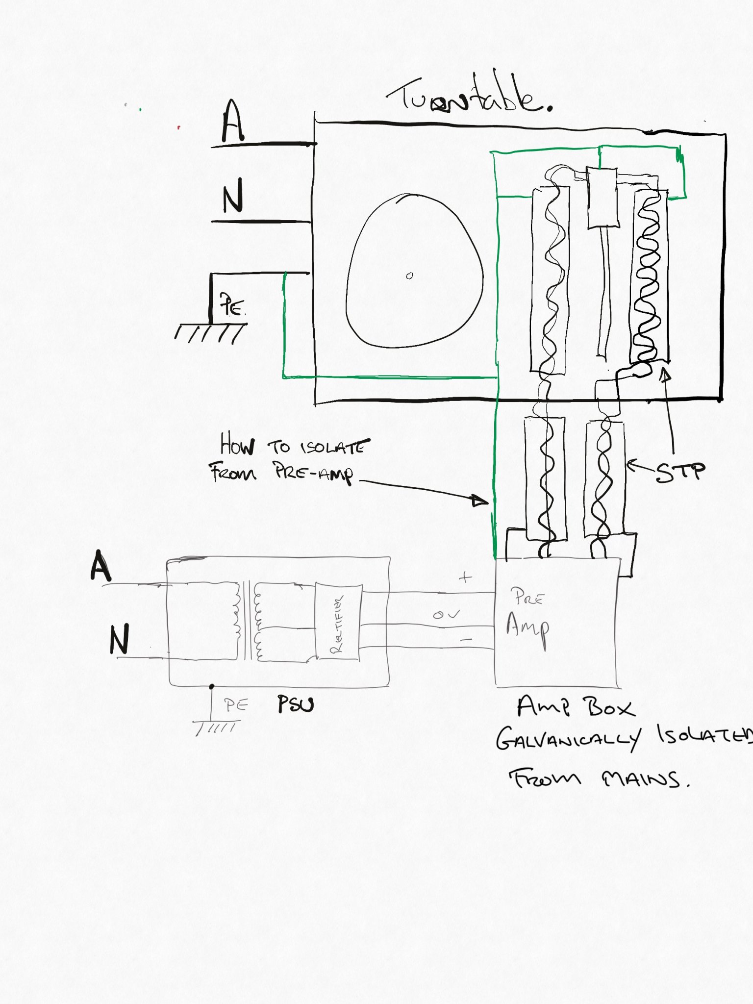

Hi All,
I have a turntable (TT) that has its metal chassis grounded to protective earth (PE), as would be expected. Also grounded to this chassis (via a tiny ~30AWG wire) is the tone arm, internal cartridge wiring shield and the “grounding wire” – a small diameter wire (~20AWG) that is intended to be connected to the chassis of the pre-amp. The pre-amp consists of two metal enclosures – one is a PSU and is connected to PE, the other is the amp itself and is galvanically isolated from the mains via the trx and it’s appropriately rated insulation (the design and build has been checked by competent and qualified persons). If I connect the TT to this pre-amp without the “grounding wire” I get a 50Hz hum (as I expect). If I connect the “grounding wire” to the chassis of the pre-amp the hum goes away (again, as expected). The problem is that by connecting the “grounding wire” (referenced to PE in the TT) to the pre-amp the galvanic isolation of the pre-amp is lost, as the pre-amp chassis is connected to the 0v rail of the secondary of the trx (see attached sketch). I am trying to figure out the best way to solve this issue. The options that I see as possibilities are:
I have attached a sketch of the wiring.

Whilst the hum has been removed, the connection of the PE referenced "Grounding Wire" from the tone arm to the pre-amp defeats the galvanic isolation of the pre-amp as the pre-amp 0V rail would now also be referenced to PE. So the problem is that I want to maintain the design philosophy of the floating and galvanically isolated pre-amp but wish to connect a TT that, from the manufacturer, has its tone arm ground wire referenced to PE.I don't see that you have a problem if you have removed the hum.
I tried this, but it made little difference (perhaps slightly worse) to the hum. This seems what I would expect as the tone arm is already tied to PE in the TT - connecting the ground to the PSU box, also bonded to PE, only creates the potential for a ground loop. As I understand it, the tone arm and internal shielding grounding wire needs to be connected to the reference of the signal it is protecting.What happens if you tie the TT ground to the PSU box?

Most modern T/T's use low voltage DC motors and wall warts of some description. In older T/T's, a mains cable ran to to a PSU in the plinth that then powered a DC motor (Technics, Pioneer etc). The power earth (PE) is usually separated from the tone arm ground and connected to the mains plug. The tone arm ground attaches to the back of the amplifier at the 'T/T Ground' and should be completely isolated from the T/T PE. By grounding the arm like this, you neutralize any capacitance between the pick-up wiring inside the arm and any external electric fields - they impinge on the arm, and are essentially conducted to the amp housing and ultimately the amp PE (assuming the amp PE is connected to the internal 0V). If you don't ground the arm in this way, noise is coupled common mode into the pickup wiring. Most unbalanced phono amps do not have good common mode rejection - easily proved by plugging an RCA terminated cable into the phono amp, shorting the other end out and then just holding it. Invariably, a lot of hum can be heard from the speakers.

Hi Bonsai, thanks for the detailed reply. It sounds like I should be able to remove the ~30AWG wire that connects the tone arm to the TT PE, floating the tonearm with respect to the rest of the TT, but grounding it to the pre-amp chassis and thus the signal reference via the "grounding wire".Most modern T/T's use low voltage DC motors and wall warts of some description. In older T/T's, a mains cable ran to to a PSU in the plinth that then powered a DC motor (Technics, Pioneer etc). The power earth (PE) is usually separated from the tone arm ground and connected to the mains plug. The tone arm ground attaches to the back of the amplifier at the 'T/T Ground' and should be completely isolated from the T/T PE. By grounding the arm like this, you neutralize any capacitance between the pick-up wiring inside the arm and any external electric fields - they impinge on the arm, and are essentially conducted to the amp housing and ultimately the amp PE (assuming the amp PE is connected to the internal 0V). If you don't ground the arm in this way, noise is coupled common mode into the pickup wiring. Most unbalanced phono amps do not have good common mode rejection - easily proved by plugging an RCA terminated cable into the phono amp, shorting the other end out and then just holding it. Invariably, a lot of hum can be heard from the speakers.

The TT in question is a late 1970's Denon DP1200. According to the schematic I found for it, the tonearm was connected by Denon to PE via the ~30AWG wire at time of manufacture.
Yes, you should be able to float the arm and ground it to the T/T.
If the main metalwork of your T/T is connected solidly to PE, I would not worry that the tone arm grounding wire is thin. I cannot imagine a scenario where you would get a safety problem the arm. The thin wire is there purely to ground the arm for noise purposes - not safety.
Seems strange Denon did it that way, but if it works, you should be good to go.
