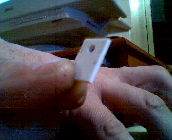

oxide
peter may be still selling these thay work great and you dont need to make the fet super tight for it to work good..hmm the name i think was ceramic oxide. no goo needed😉
