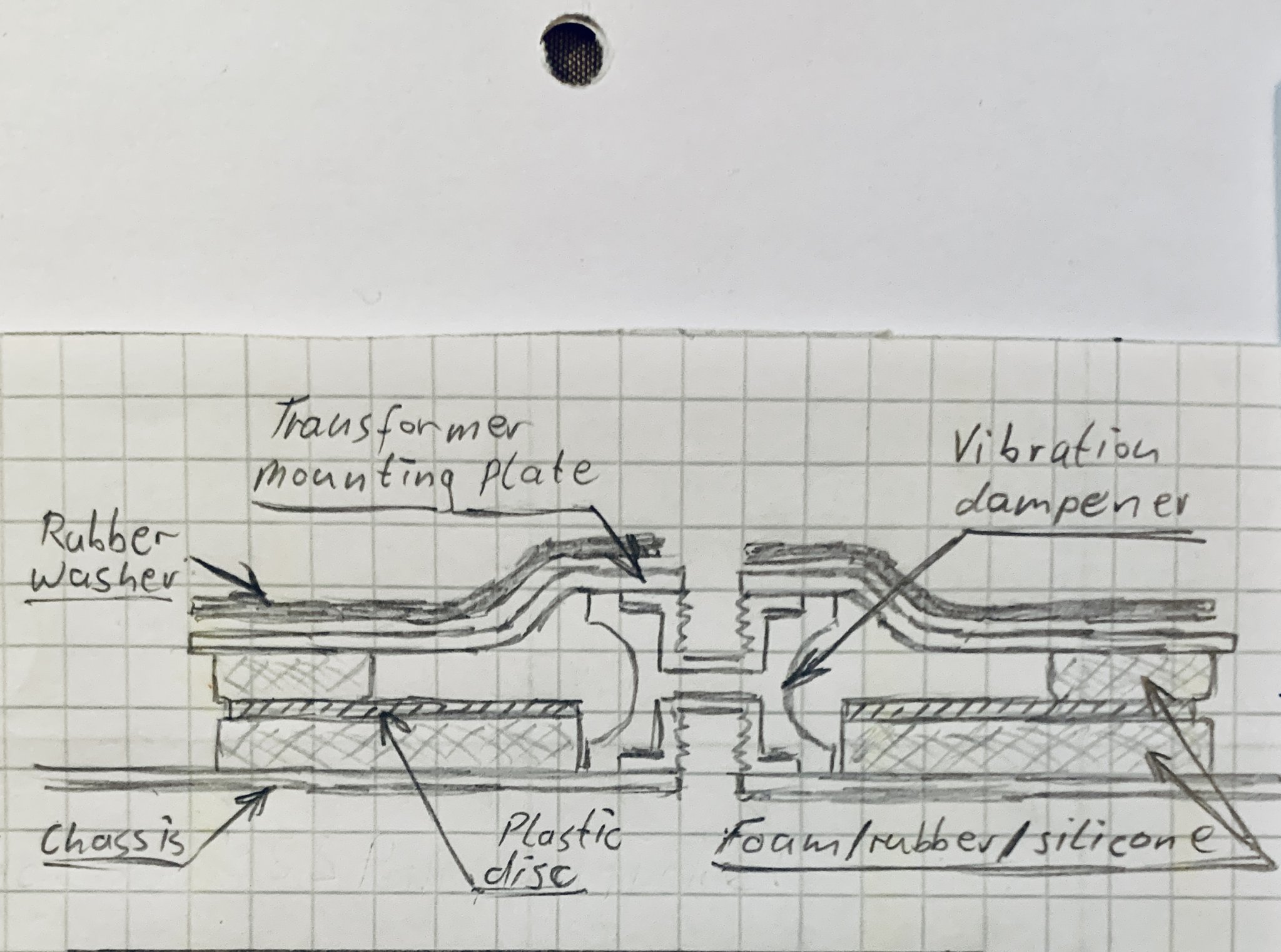

Isolate transformer vibration
More times than not plastic gears failed on me. I would prefer minimal noise and added piece of mind.
The difference between either while purposed for bolting down a transformer would probably be minimal at best anyhow imho. Instead I'd focus most of the efforts on good quality graumets intended for the specific job. Keep it simple and quiet.

So, let's go with a more serious approach. When solving a problem such as vibration, it is important to keep on track as far as focusing on that problem, and not trying compare apples to oranges. There are so many variables being put into a conversation that can actually lead away from the solution. My lawn mower and my washing machine both have vibration and could possibly be compared with each better than trying to compare them to a transformer in a steel chassis. Exaggeration intended. If the transformer is coupled directly to the chassis through means of most connectors, vibration is going to follow. If I were a manufacturer, I would do the exact same thing as they do since the mass of the transformer must be held snugly to the chassis for shipping. No argument there. If for some reason the transformer is making its own mechanical hum, then isolation may be the best bet for containing it. It will depend on the amount of vibration, and the frequency of the vibration (yes, 60 cycles per second most likely) that needs to be controlled. Isolation first and -absorption-after and away from the chassis, will yield what we want to accomplish. Some care might be needed to allow the transformer to dissipate heat as well, so too much absorbing material will have to be avoided.

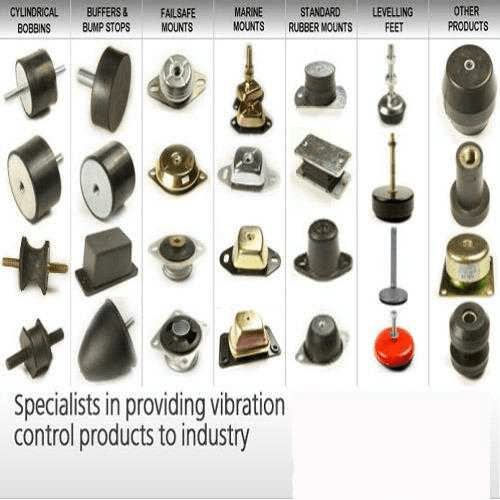

Look at the damping units used to mount compressors in air conditioners, they work well enough.
A well made transformer, and properly rated, should not hum so much as to need treatment.
Also, bear in mind the transformer will heat cycle. So whatever damping material is used, must bear the variation.

Plastic fasteners are used to save money. Do not rely on plastic screws to out perform any kind metal in any way except for saving weight.
Besides I don't see why coupling two wholes together with plastic would transfer any less energy anyway. I see the same objects transferring  greater energy with plastic due to there being less strength at the connection point. If it were a solid connection the majority of the energy will still travel through the objects larger mass and surface area. And a very low percentage through the fastener itself.
The thing is the metal screw might be causing the transformer to vibrate to begin with...
Reactions: Subuckethead
Could be but then I would place more blame on the rubbers and whatever there issue is, dried out or too soft to start with. Allowing the screws to carry the load. Of course it will easily transfer that energy.
My money is still on the rubbers.
