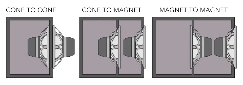

My experience as well. I had 8” isobariks in my hatchback years ago. Small enough to tuck out of the way yet powerful enough to blurr the rearview mirror. The smaller box is also stiffer and less resonant at low frequencies than the larger box.The result is that the coupled driver pair (iso-group) can now produce the same frequency response in half the box volume that a single driver of the same type would require." https://en.wikipedia.org/wiki/Isobaric_loudspeaker
"The result is that the coupled driver pair (iso-group) can now produce the same frequency response in half the box volume that a single driver of the same type would require."
Just to clarify, the above statement applies when the two drivers are connected in parallel. If connected in series the isobaric system frequency response will be -6 dB for the same input voltage.
Correct. As noted in the passage I quoted (in the link I posted), the parameters they listed were for a parallel connection.Just to clarify, the above statement applies when the two drivers are connected in parallel. If connected in series the isobaric system frequency response will be -6 dB for the same input voltage.
I saw that, but they don't say what happens for a series connection, which I felt was also worth knowing 🙂.

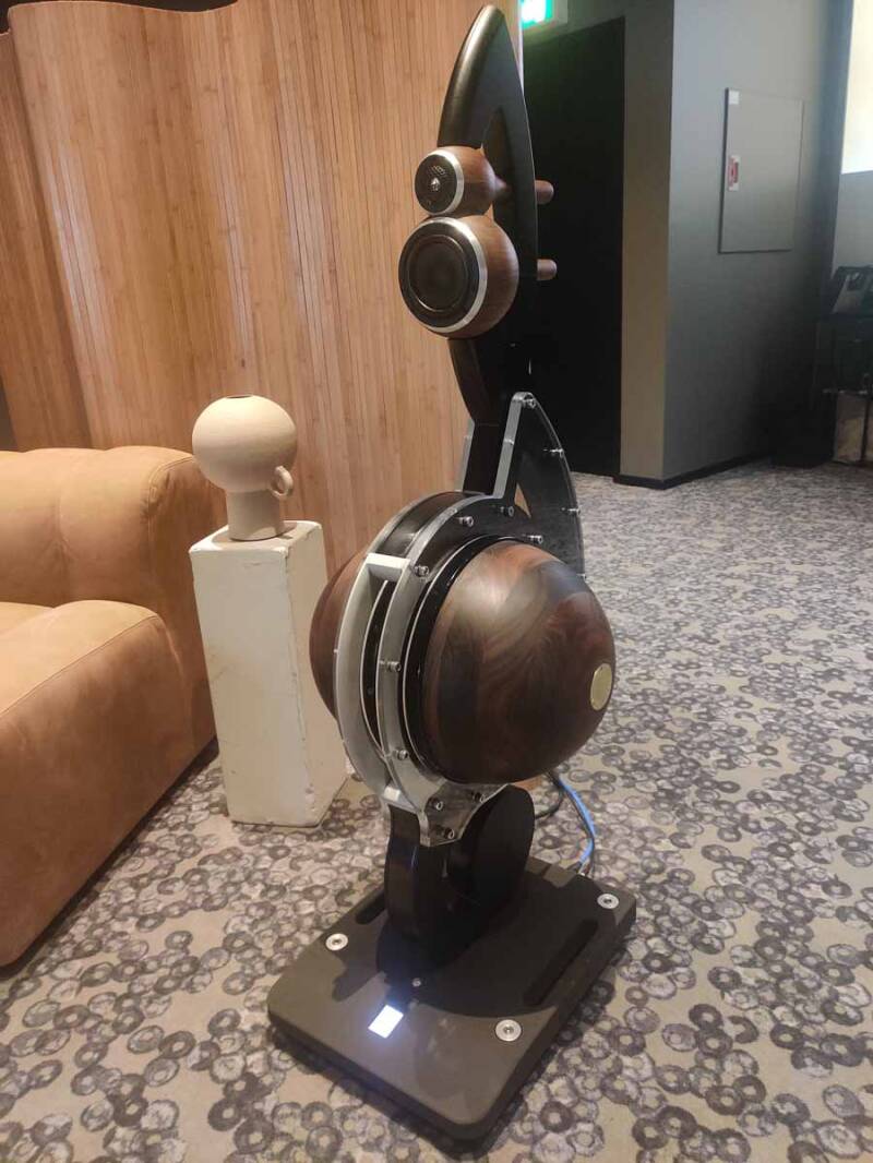

Correct. This is neither an isobaric construction nor a dipole. It is two closed boxes facing each other with in-phase radiation, similar to a push-push construction.View attachment 1443493
Looks more like a face-to-face push-push sealed. Given the small size likley EQ? A ripole would be the “OB” version of this arrangement. A technique used by Monitor Audio in their flagship.

If they were connected with reversed polarity, there would be no sound emission, the sound emitted by the two closed boxes would cancel each other out.
They are ripole upon further inspection
With some heavier "mass loading" than traditionally seen on the back "OB" exit. Or maybe not.

Ok, seems that you're right and I was wrong. 😢They are ripole upon further inspection
This picture seems to make it more clear:
The isobaric design is useful to a manufacturer that wants to build a new, "innovative", sealed, passive crossover speaker to sell into the classic high end dealer model, where equalization is verboten, but they already have a thousand woofers in the warehouse that are close but quite right for a single driver sealed design. Once you have the woofers and can build whatever box, bigger and heavy seemingly more impressive, this is a good solution. All the above mentioned improvements apply. Woofers front to back cancel some of the distortion. The in box F 3dB is lower for a given volume and sealed bass is great. Of course the max SPL is the same as one woofer and the efficiency is lower.

We were all wrong. I just happened upon that pic low in the second web page of a link off the main page. The advertising glamour shot pics didn't show a clear back view. 😳Ok, seems that you're right and I was wrong. 😢
Jeremy
Ripole comes from "RiPol", the shortened version of Axel Ridthaler's patented "Ridtahler dipole",They are ripole upon further inspection
The "figure of 8" pattern depicted in the Treble Clef Audio Model M photos makes the dipole radiation and conceptual origin obvious (to those familiar with the RiPol..), though it doesn't appear they acknowledge Axel's work.
The larger volume between the speakers and rear chambers in the original RiPol create a nasty 10-20dB resonance peak in the 180-300Hz range (volume and depth dependent) requiring a fairly low and steep crossover frequency which relegates them to subwoofer use below ~125Hz.With some heavier "mass loading" than traditionally seen on the back "OB" exit. Or maybe not.
The Treble Clef Audio woofer's small volume, constrained layer synthetic rubber damping and cement based syntactic foam damping material in the hemispherical rear chambers claim to raise the resonant peak frequency "to at least above 370 Hz".

Hmm, 370 Hz is nearly an octave below the invention claim of 16-700Hz:
Oh well..Lets go to the real world:
Anyway, it looks cute, and the Treble Clef Audio Equalization Manual and White Paper are actually quite well written and informative.
