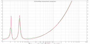

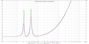

Seems more appropriate to bring a thread back from the dead rather than start my own. As the previous discussion is just based on identical drivers and such like, yet in the real world there is always mismatch and loss.
Basically I have built and isobaric bass reflex box. For testing I have wired the two dvc drivers in parallel with their voice coils in series and clamped the side of the box on to check the tune. In actual use I will wire the drivers in series.
Attached is the measured box impedance compared to the simulated box impedance for the parallel configuration. I believe it shows that mismatch between the resonant frequencies of the two drivers is misshaping the resonant peaks. Also probably as hornresp doesn't include any port losses I would expect the peaks to be a bit lower in real life as well.
Waiting for glue to set at the moment but I would expect that a series configuration is going to not have less distortions as the drivers are fundamentally current mode devices and it enforces current sharing.
