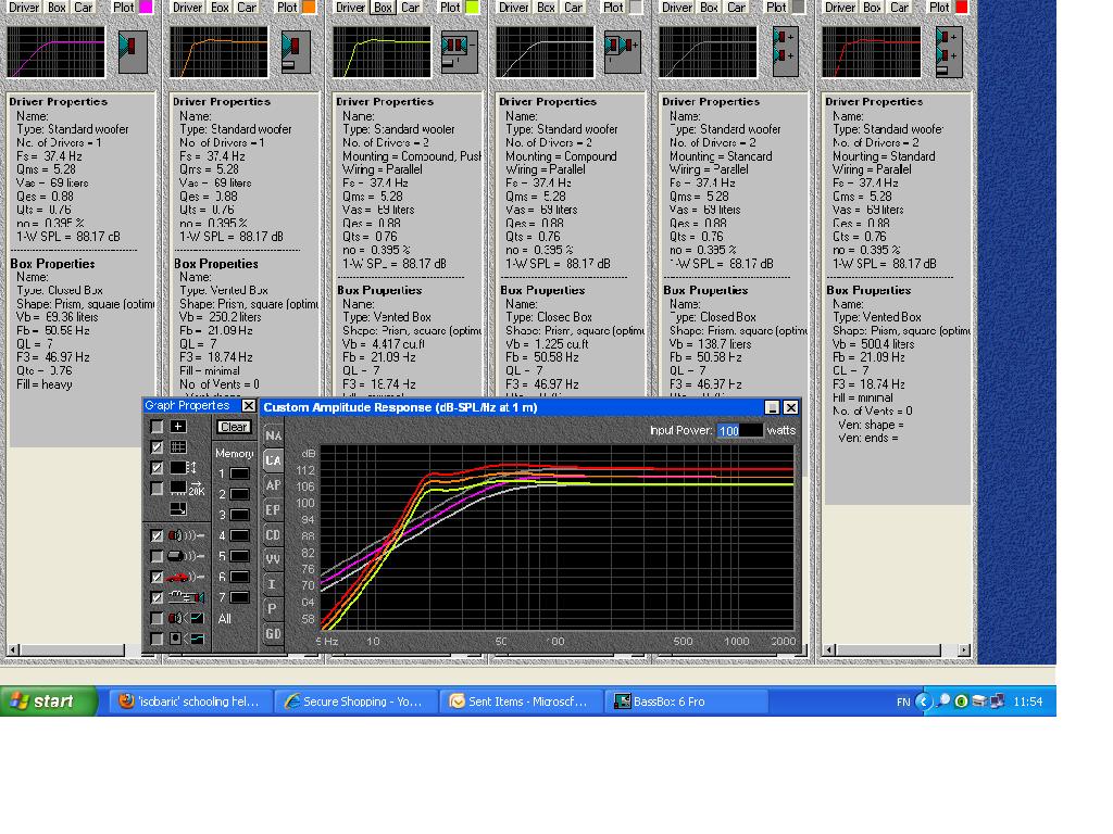

could you post the outputs of what you modelled so i can see what it looks like compared to what others posted as some of the graphs didn't look so bad in ported and sealed boxes. imagine it was a lot better then my last subwoofer experience. a little 8 inch ported eltax thing that sounded like an asthmatic hitting a drum wheeze thud wheeze thud thud pop wheeze.
ok, I extrapolated the missing TS parameters using hornresp and BBP so these are just guesses. All the graphs are two drivers in parallel for a 4ohm load using 100w. The red line is modeled as isobaric to show the difference from standard in efficiency but if the two drivers were used normally the red line would be the same just +3db.
Surprisingly the infinite baffle model was the best. (that's the red line)

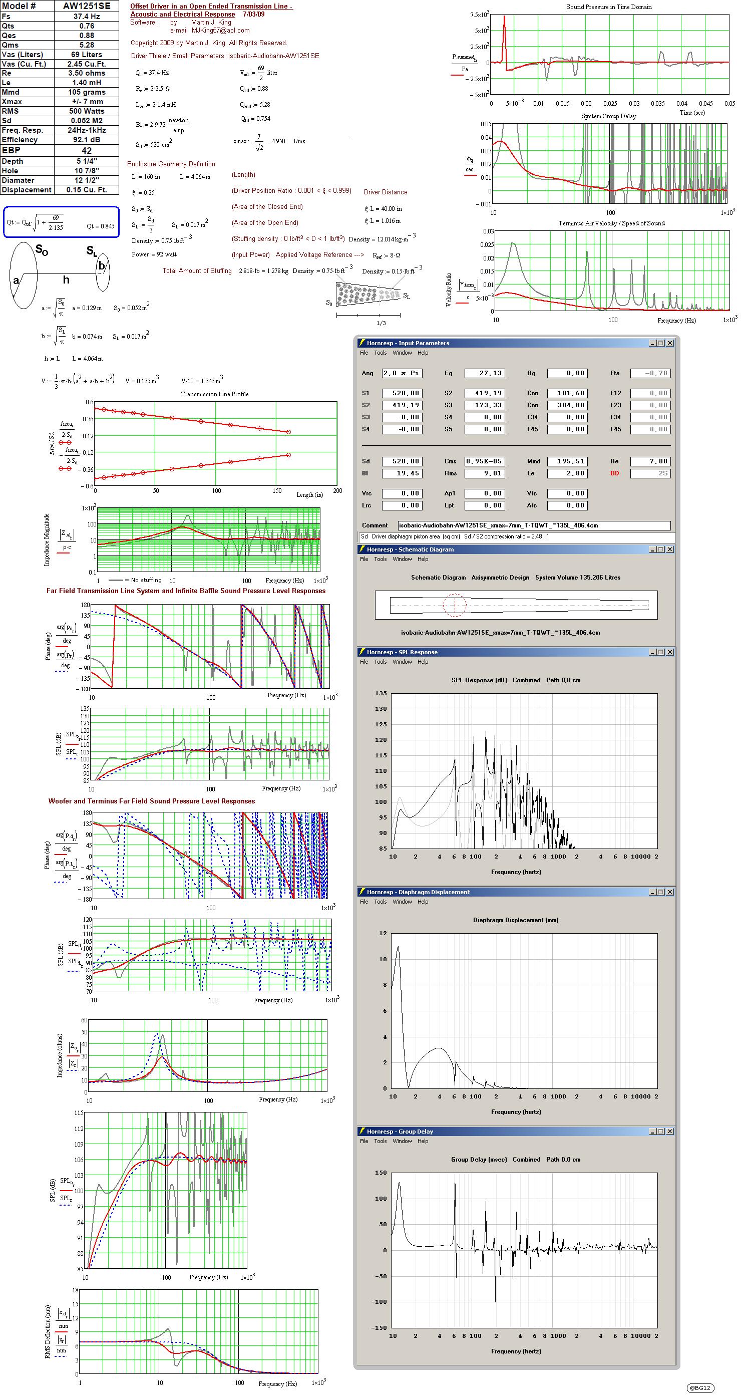

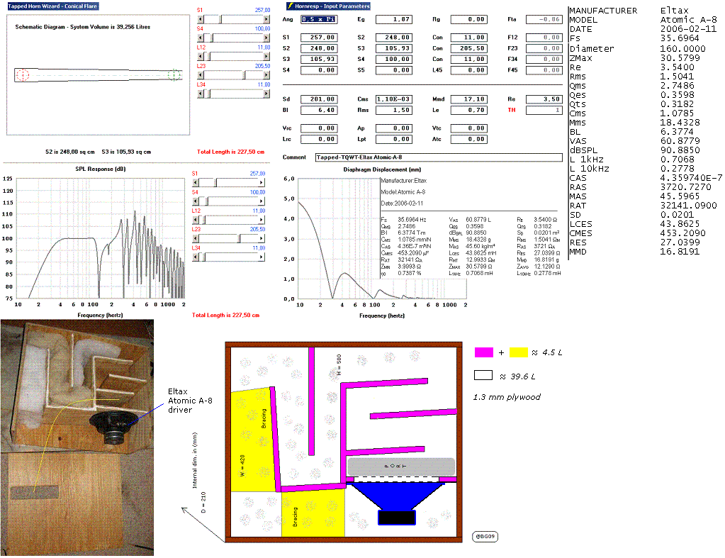

And the same basic data in Hornresp for a T-TQWT, which would be a lot smaller:
Discard the picture in post#4 as containing an apples to orange comparison.
The HR simulation uses 4 drivers ,i.e. two separate isobaric configurations but the MJK only one. = :crazy:
A new corrected picture: The first one of the submitted.
b 🙂
Here is my try at this driver in WinISD: BP6 Isobaric. Would you cut wood from this level of data?
guess that'd be its automotive heritage showing through? tbh they didn't look as bad as i was expecting. what are the down sides to open baffle apart from the lack of driver protection? makes construction fairly easy, but what about room placement?
