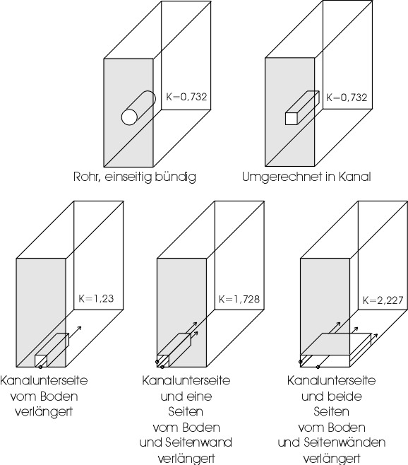

Sometimes can use Triangle ports in all 4 corners.
2 walls shared. so correction factor is higher.
port Efficiency is lower.
Hence Triangle ports sharing 2 walls
or slot ports sharing 3 walls
are somewhat common to use.
to try and reduce needed port length.
and fit into smaller area.
port efficiency is low. so same tuning
but shorter ports.

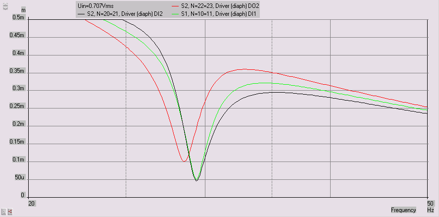

Try and avoid using isobaric configuration in a ported enclosure. You won't get the same excursion-limited SPL as you would with a single driver, due to the enclosure resonance changing the effective rear enclosure volume.
See the attached graph, showing excursion.
The red line is the excursion of the outer driver of a clamshell pair.
The black line is the excursion of the inner driver.
The green line is the excursion of a single driver with T-S specs equal to the combined clamshell pair.
Most of the time, the volume of the rear enclosure is much larger than the volume of the space in the clamshell, so the two drivers move almost together.
But at port resonance, the back-pressure of the enclosure resonance has the same effect as making the enclosure much smaller, and the ratio of the two volumes becomes smaller. The volume of the clamshell space becomes significant.

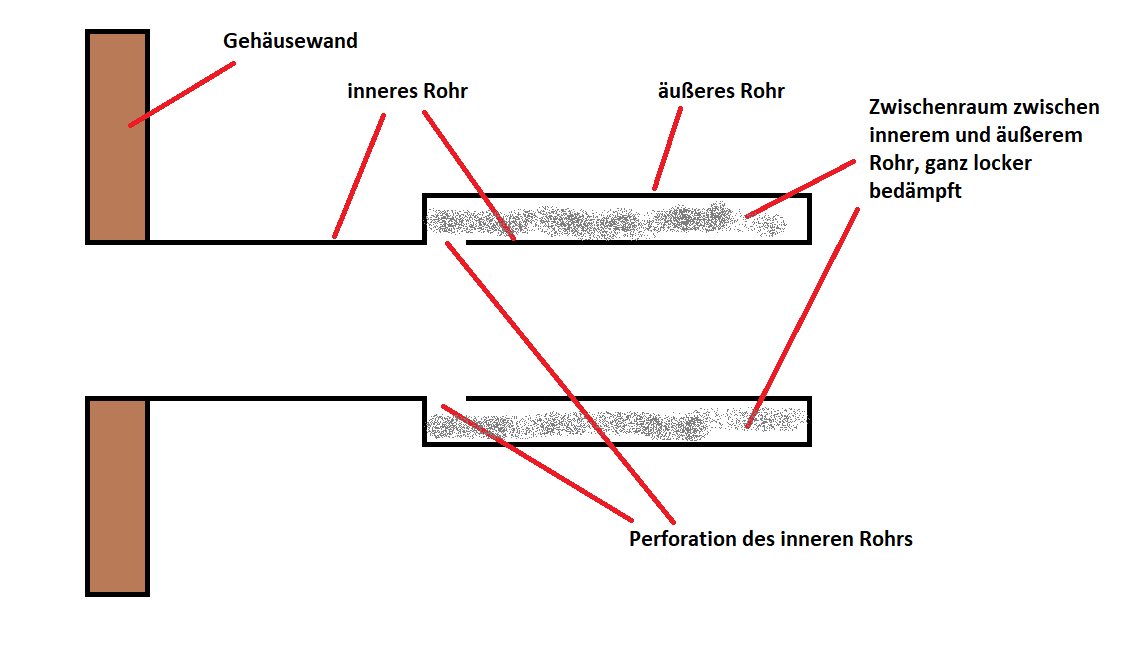

The problem with such large port lengths is that the first port resonance can come so close to the transmission range of even subwoofers that it may no longer be reliably filtered away.
You can then either use passive radiators instead of a port, or try to eliminate the first port resonance with an absorber mounted to half the length of the port, e.g. as I sketched it here once with MS Paint:
deepl.com offers a good translation-service. Instead of the letter "ä" use "ae" and instead of "ß" "ss". 😎
