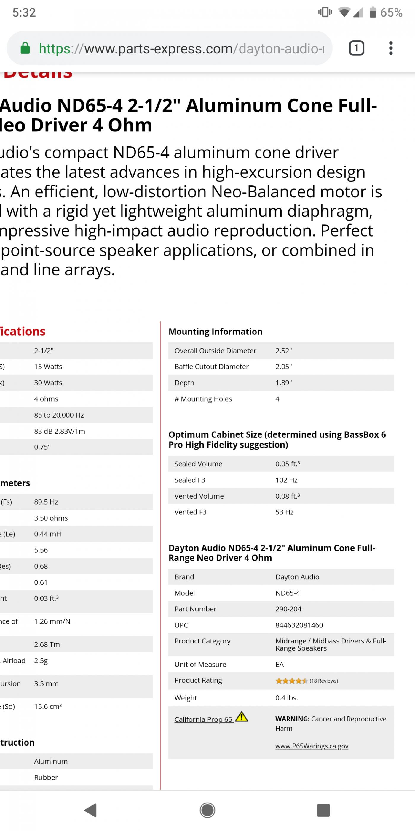

I have a separate thread in which I asked docudrama about vents for small boxes. In playing around with WinISD, I noticed that using 3x6mm vents as opposed to a single 12mm vent, the "vent Mach" number was reduced from an unacceptable number to a marginally acceptable number and since the cross sectional area is similar, the recommended length stays about the same.
I don't know if winisd is calculating accurately for this circumstance, but I was curious to try it.

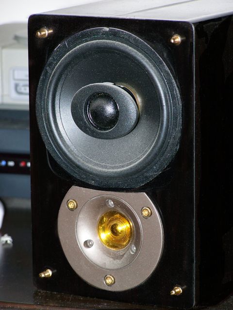

It seems to me that this is where the hobby can really get interesting, particularly for the iAge folks and users. I had done a retrofit to a pair of TEAC LS-H100 speakers from one of their "Reference 100" mini systems that worked out well.Maybe a little large for some to use as a travel system, but easily worth the effort. I disconnected the tweeters from the crossover, removed the factory woofers, and shoe horned a pair of (slightly) larger Vifa co-axials.
You can use whatever physically small amp/preamp you have, and use a typical mini-jack as an input, a USB analog input, or a little passive dock. But at 87dB you may need an amp with a little grunt. The port can be tuned a bit with some Dacron or straws. Listening without any "good" comparative speakers, it seems like they're pretty good, even in a home environment. Unfortunately they can be easily outclassed by good budget speakers, but for $30, how can you complain?
Vent volume does add to box volume. You don't want to make it too small or it may chuff.
I did a miniOnken in the same volume as the SS 10F, i had to double the vent back an extra time to get enuff length while maintaining a reasonable cross-section.

I think I watched that video on YouTube last night, if it was the one with an L port. I was most interested in anything that could actually get an FS near 60hz, as I couldn't
I get the impression that there may be a bit of false advertising at play here, I know I fell victim to the bass box pro sizing and even replicated something similar in WiniSD (a bit higher around 60) but was shocked when it started to distort at half volume.even with a trial of a much longer port sticking well out the box. I can't recall what Greg did with the L port but I was impressed with the sound (even through YouTube)
