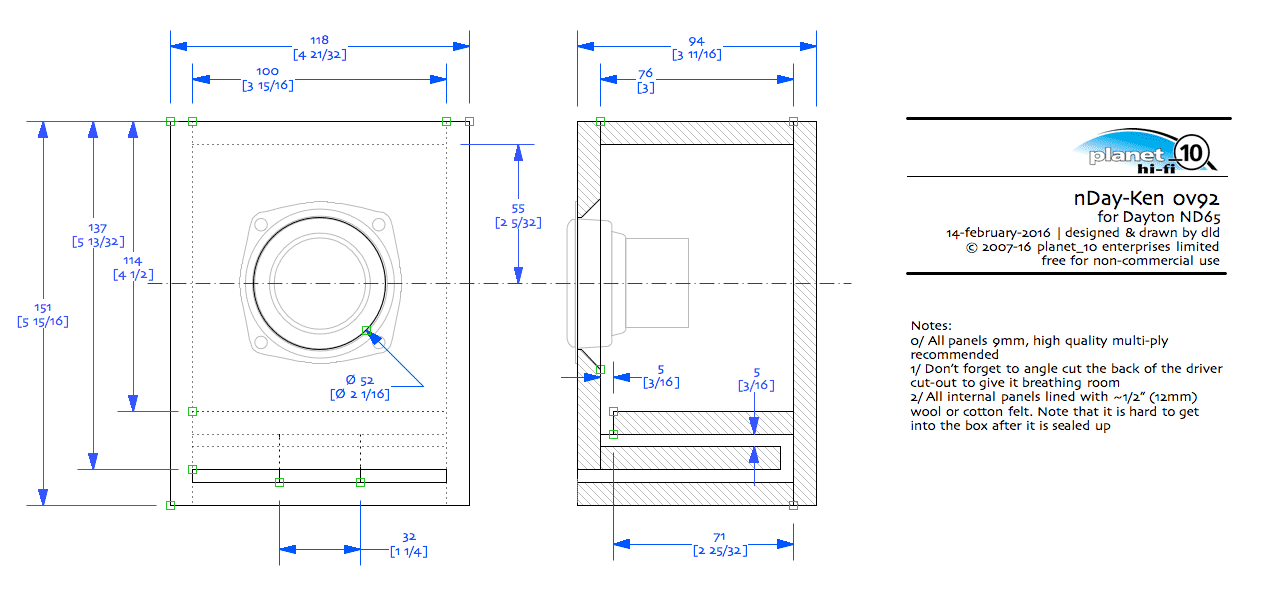

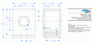

For my small suitcase system i chose the 2.5 litre uMar-Ken for the Alpair 6.2p. I have drawn up 1.5 litre milliOnkens for Alpair 5.2 and FF85wk.
And if you are willing to give up some bass & top and have a biggish budget, the ScanSpeak 10F fits in an optimal 0.8 litre miniOnken.

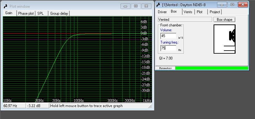

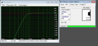

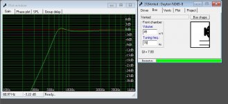

I'm trying to go quite a bit smaller (and less expensive) than these. I'm using a Dayton Audio ND65-8. According to WinISD it will work well in a 45 c.i. ported enclosure tuned to ~75Hz. It'll make some sound down to around 70Hz.
If I was to put that driver in a 90 ci box tuned to 70Hz I'd get a little peak in the 70-75Hz range and a little more extension below that.
If I do the isobaric trick, I can get that same response with my original 45 c.i. enclosure. I realize I have to add the volume of the extra driver and the airspace between the two drivers, but if I can find a good piece of ~2.5 plastic pipe, it should only add around 7 c.i. I still save a considerable amount of volume.
0.74 litre. Pretty close. To go that low in such a small box, it is not going to be very efficient.

I did a miniOnken in the same volume as the SS 10F, i had to double the vent back an extra time to get enuff length while maintaining a reasonable cross-section.

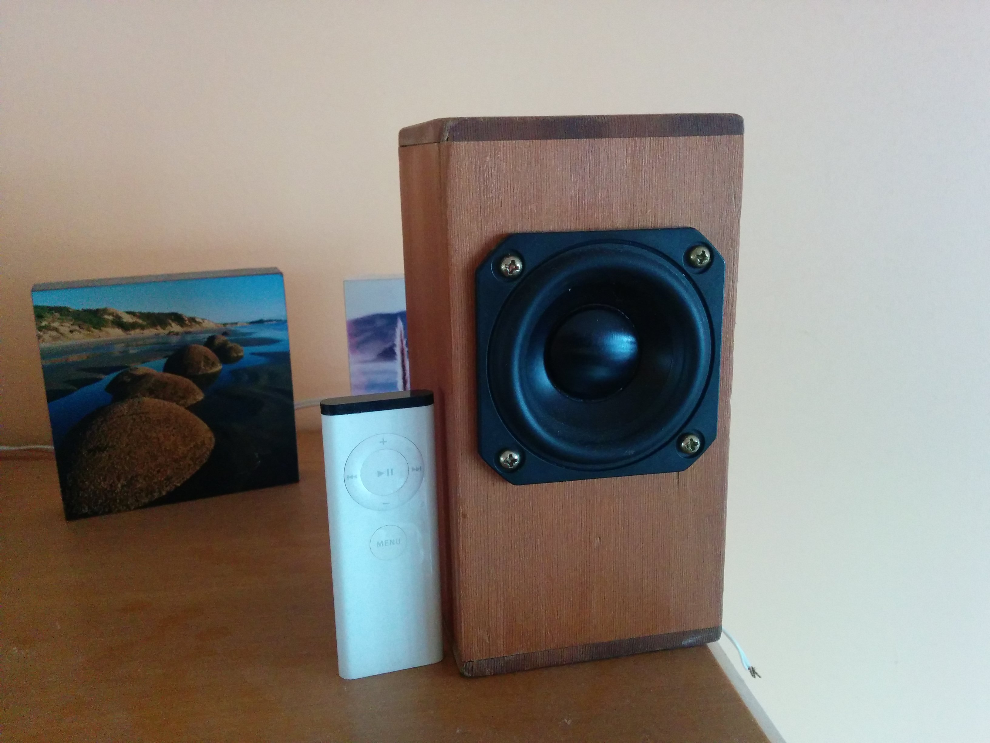

I built these with Peerless 830984 2.5" Full Range 8 ohm for $25 from Madisound for my travel speakers. Sealed and very small volume. I use them with an elekit mini tube amp or a fostex 5w job and am completely happy for hotel sound. When properly travelling, I power the amp with a small LiPo battery.
