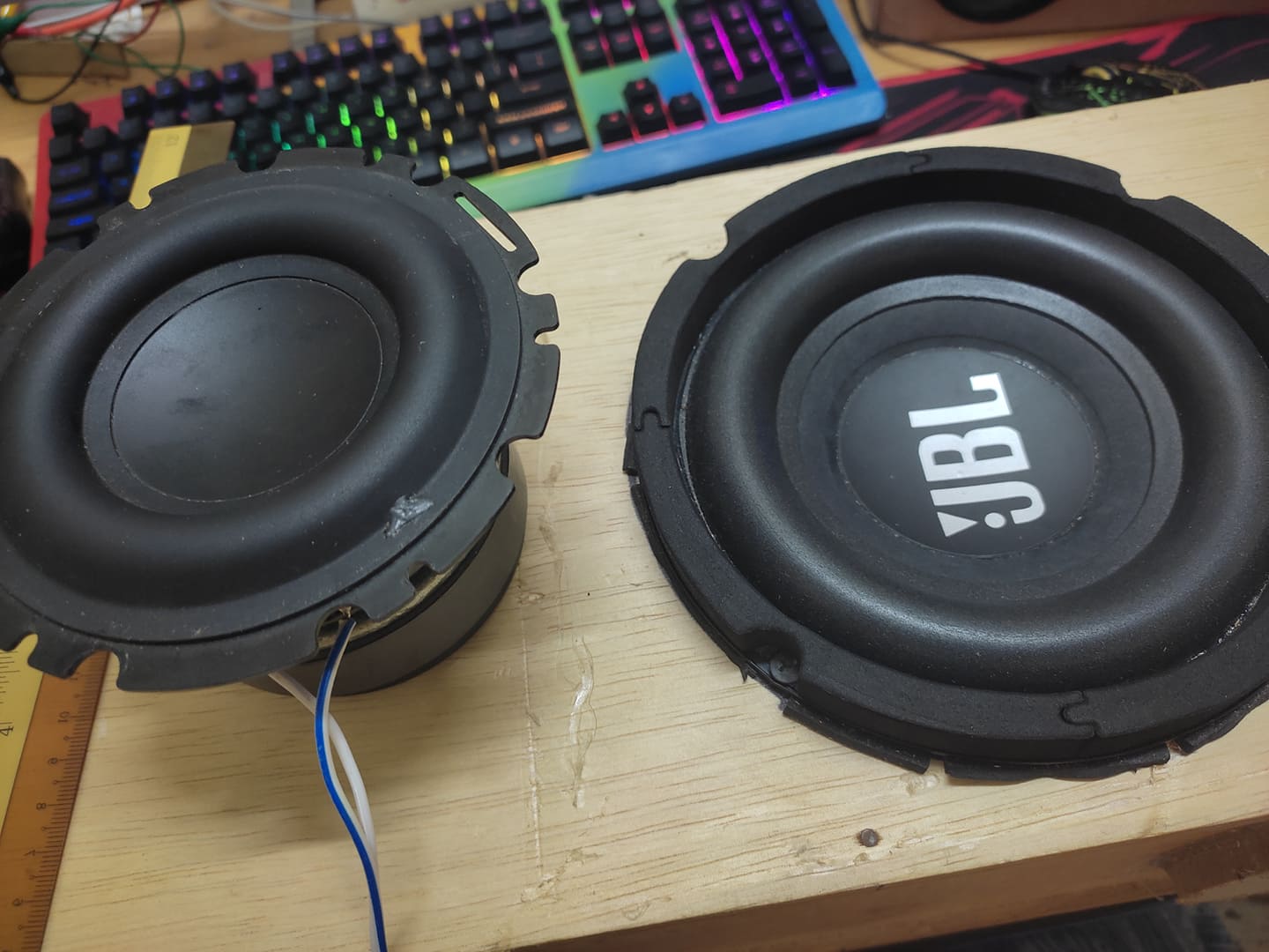

I have 2 pcs of homepod subwoofer ready to bring them into duty in form of 4th order bandpass sytem. It will be using an isobaric setup. There were 3 types of setup available for isobaric ... face to face, back to back and front to back coupling
This is my first time dealing with isobaric system ... which configuration will be the best? thanks

Danny,
Just a quick note that isobaric loading won't give you any more SPL (which seems to be a concern for you), but will allow the use of a smaller enclosure.
I'd typically recommend face-to-face mounting, unless the motor's wind noise is an issue. Face-to-face is the only one that allows useful air flow around the motors.
Chris

the face to face method i will need to create a spacer ring?

Yep, a spacer ring will be needed. Alternatively, you could attach both drivers to the same bit of wood, using the wood thickness as the spacer.
Bandpass designs will filter most of the noise. It's difficult to predict as I don't know how noisy your drivers are. In most use cases, the rest of the music is covers the motor noise of the subwoofers well enough.

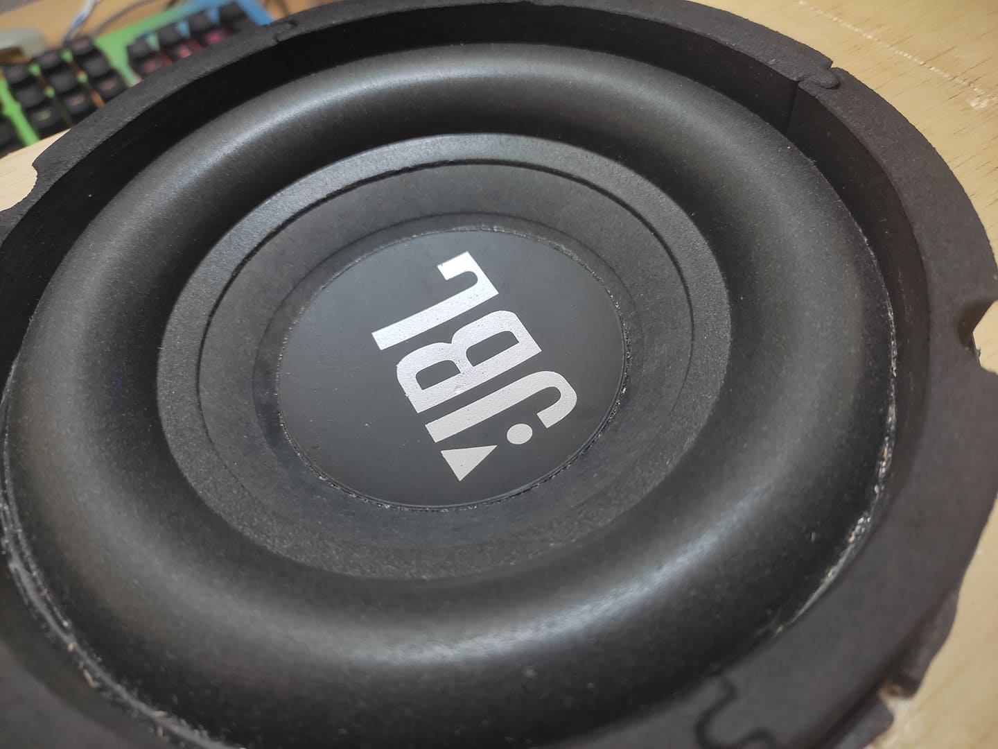

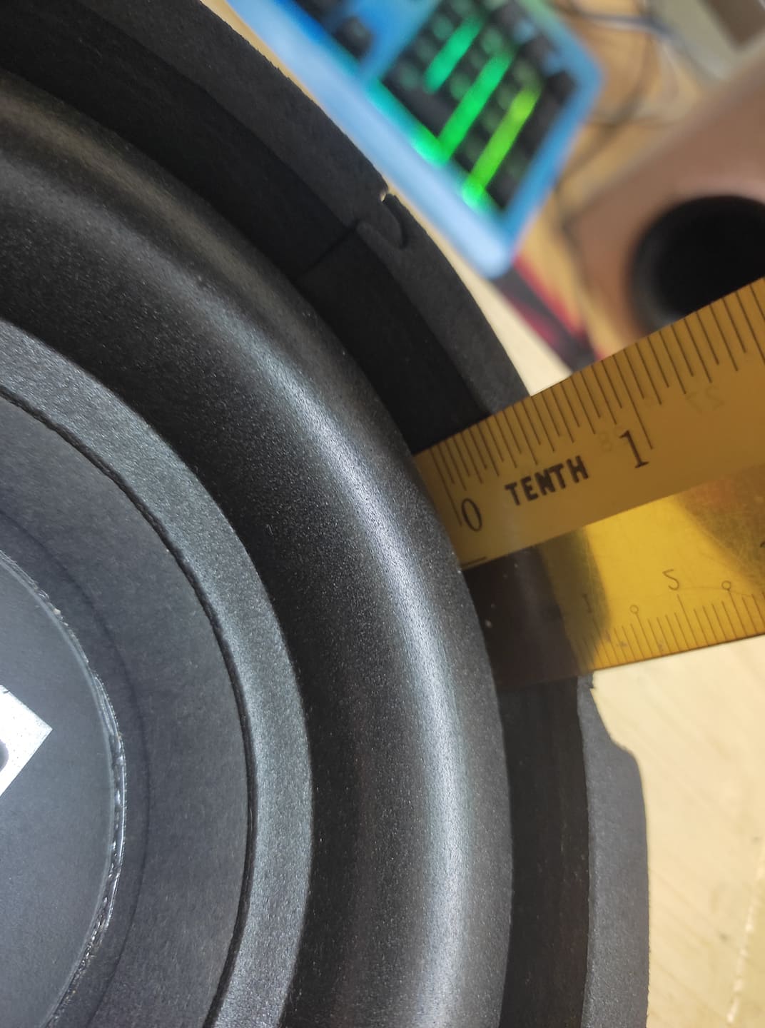

ok how about in this case? for this driver it still need spacer ring because unlike the homepod unit it was already spaced up

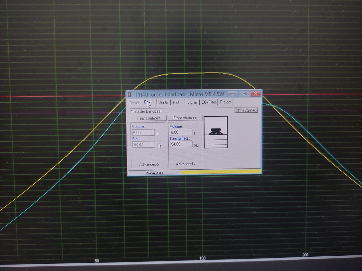

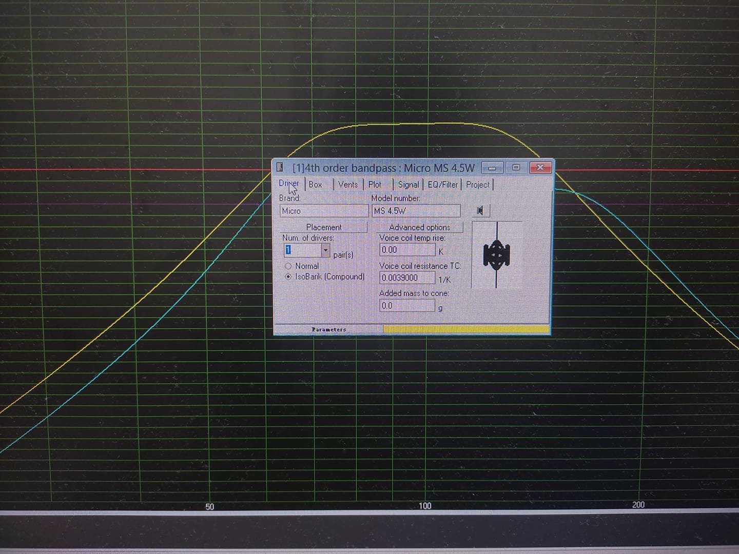

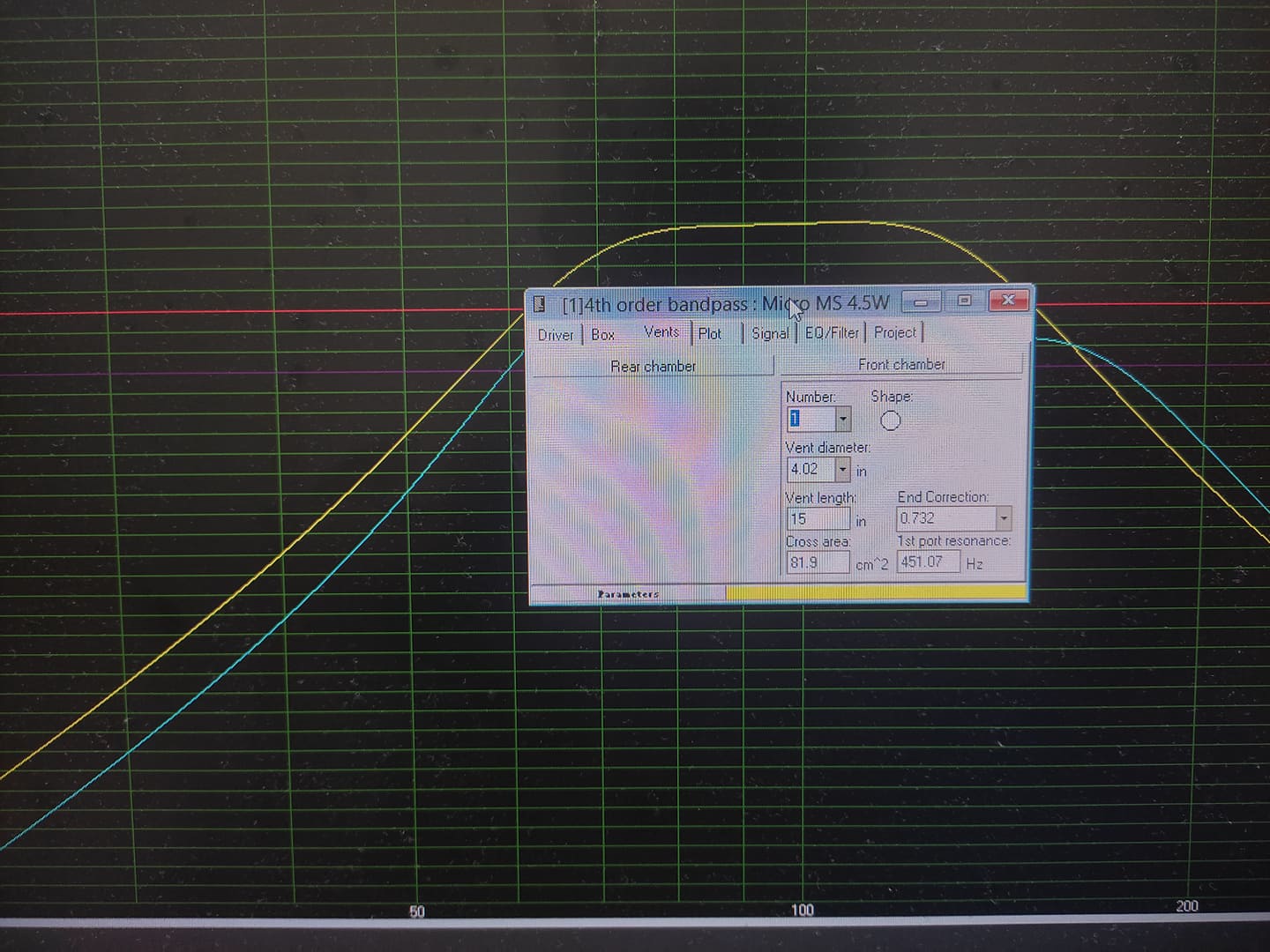

I do not think isobaric is an option with those woofers, if you want to make a 4th order bandpass enclosure. It will make the ports impractically long.
any other options besides this ... i am thinking to try out passive radiators for such application (small enclosure reasonable bass SPL) ... now i am stuck to either 2 of these as the candidate for the bass unit ( not larger than 13L enclosure)

and yes exactly ... WINISD shows that too 🤣
That’s what always crushes my isobaric Fun. It’s off in such a small port cross section that it’s going to be an issue with turbulence ( at the least). However that’s with the MLTL idea saves the day(potentially). But shaped with a venturilike shape for the port so that the chuffing/compression/noise/ whatever issue is resolved(hopefully)?
The tang band w5 -1138 is like this. Small long port requirements
Either way it’s long and skinny, eating up your space in the soundboard design?
