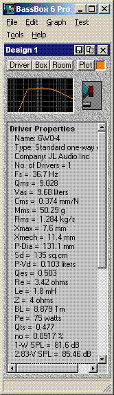

I see little point in using these subs in an isobaric configuration, they already only need tiny enclosures , you are simply throwing away 6db for no real gain.
If they are W-0's then they will respond nicely in vented, attached specs from BassBox6 Pro;

before you can DESIGN an enclosure you need the T/S parameters.
Learn how to measure them and go do it.

Since the T&S paramters are not the same (even if fs/Qts and Vas.Qts^2 is almost constant) you should use two enclosures or one with 2 compartments.
