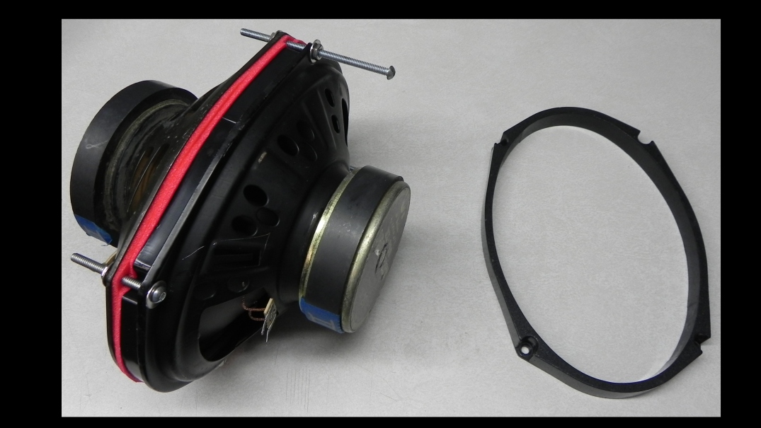

I'm making a stereo set of speakers to be installed at a friend's cabin. They will be built-in to the ceiling over an outdoor deck. That ceiling consists of open timber joists (nominal 2x10", on 16" centres) supporting another floor above. They will be driven as extension speakers from an older receiver/amplifier indoors. So, the installation dictates that enclosure volume and speaker baffle size are limited, they will be exposed to outdoor environment, and they should be 8 ohms. Finally (& sadly), there is always an increased risk of theft at this remote location, so I want to keep them as unobtrusive and undesirable to steal as possible, and hence also low cost. Of the various speaker components on hand, these 2 pairs of old 6"x9" car audio speakers seemed the best fit for the job. Typical of car audio, they are 4 ohms each. I considered running a pair of them wired in series for each side, but this of course presents problems with the enclosure design. Isobaric arrangement seemed an interesting option, but the enclosure design programs that I'm familiar with (WinISD & Hornresp) - while they do accommodate isobaric driver arrangement, don't appear capable of handling either non-identical or series-connected drivers. To solve this problem, I thought that if I could combine the parameters of two different (non-identical) drivers mounted in isobaric arrangement, the result could be plugged into the software to look like a single driver and allow me to easily design an enclosure for that.

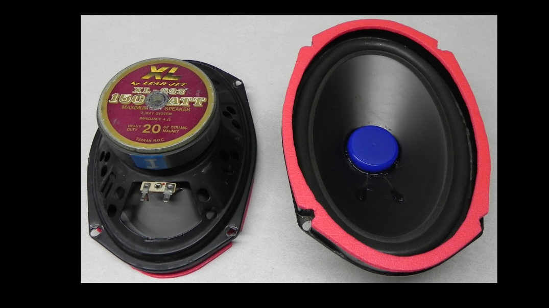

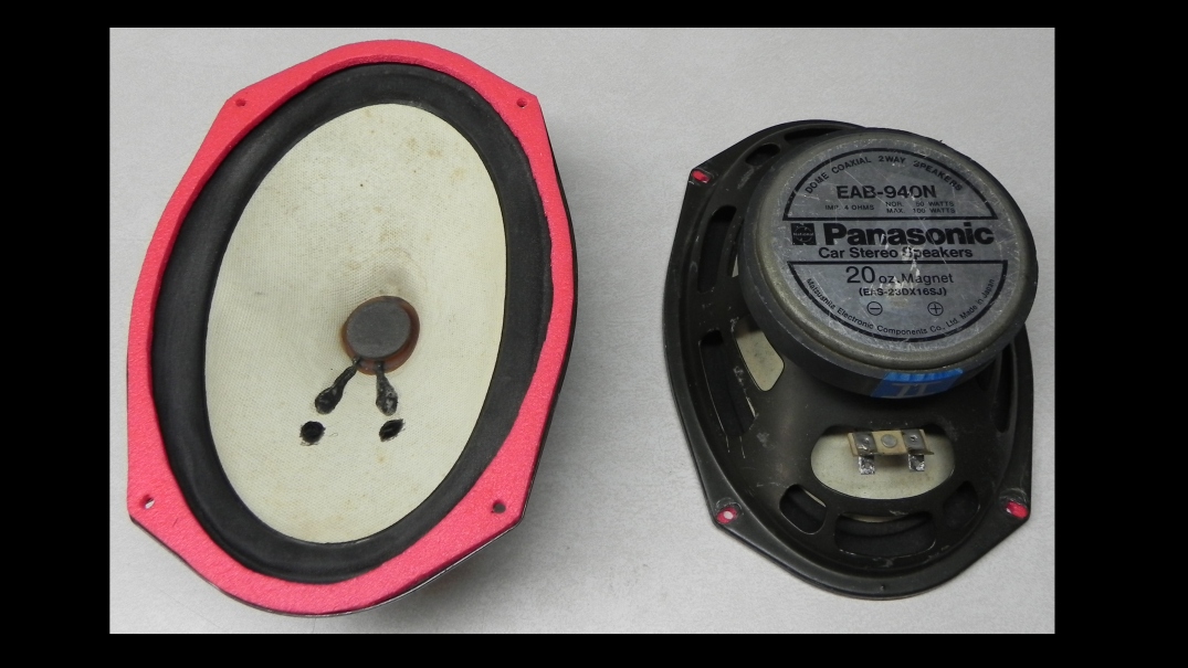

Some notes about the woofers: Both of the two pairs of speakers were originally multi-way coaxial, but I was happy to remove the H.F. components from them. I'm guessing they date back to around 1980, and have served in several vehicles over their life so far. The Panasonic pair is itself slightly mis-matched: PAN-I is Model EAB-940, while PAN-II is Model EAB-940N. The H.F. components were mounted on a "bridge" moulded integrally with the plastic frame, which I managed to completely detach. (One plastic frame was used as a spacer for the PAN-I/PAN-II Isobaric test.) These woofers have a paper cone and treated fabric surround. The Lear Jet XL-693 speakers (LJ-I & LJ-II) are visually identical. Their H.F. components were mounted on a post screwed on through the motor centre pole, with a foam sealing ring. Removal of these bits meant I had to install a replacement dust cap on the centre of the cone, and install a screen on the opening in the back plate where the screw was removed. The plastic frames were left on these, for fear of damaging the woofer surrounds. The Lear Jet speakers have poly(propylene?) cones and intact(!) foam surrounds. (Incidentally - I've never seen foam surrounds that lasted that long, and in some quite extreme operating environment at that!)

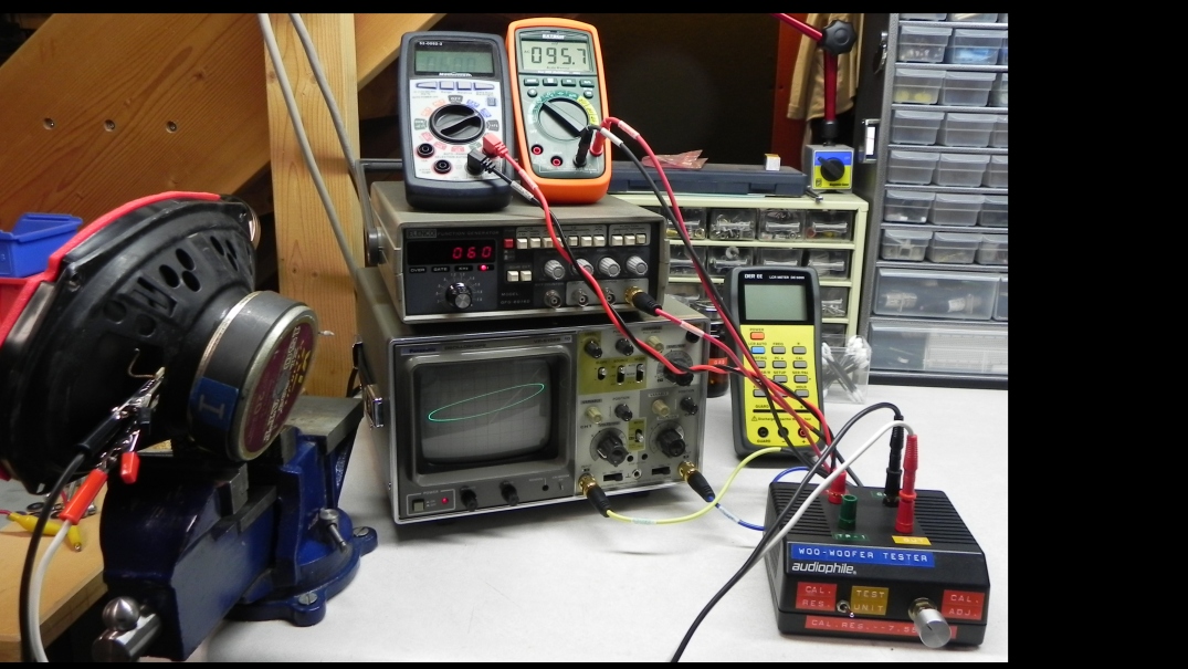

Measurement of the speaker parameters was done on a typical impedance jig, using the added mass method, and with applicable instrumentation. For each test, I established a minimum defining set of values comprising: Qes, Qms, Mms, Cms, Re, Le, fLe, & Sd. Xmax & Xlim were just estimated - ok since these are not highly relevant to my enclosure design anyway; and Pe was also an estimate based on the nameplate ratings. These "independent variables" (shown in cells with green background in my spreadsheet) were then input into the Driver Editor of WinISD to obtain all the other "dependent variable" parameters of interest. The latter were transcribed back to my spreadsheet (shown in cells with yellow background).

The above measurement process was carried out first for each of the 4 speakers separately, and then for each possible combination of the 4 in isobarically mounted pairs, for a total of 10 tests. (The isobaric pairs were mounted face-to-face & connected in series in opposite phase, for correct push-pull cone motion.) All the parameters are summarized in the attached .pdf. To complete the analysis, I proposed (very simple & intuitive) algorithms to combine the parameters of each driver in an isobaric pair into single values for the assembly. (I chose the set of minimum defining parameters as listed above.)
