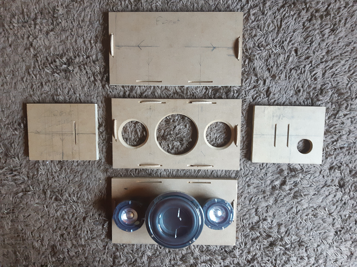

Hello,
I had the idea for few month to build a boombox for my son.
Paul Carmordy Isetta design was chosen for it's good reviews and relatively cheap speakers.
Isetta - undefinition
By chance I had a 19mm MDF board lying on my cave and two suppliers could send me the speakers and crossover parts in about a week (tlhp.com and soundimport.eu).
The Isetta will be powered by a Lepai LP210PA plate amp
Build has started on 04/10, first pictures below, more to come 🙂

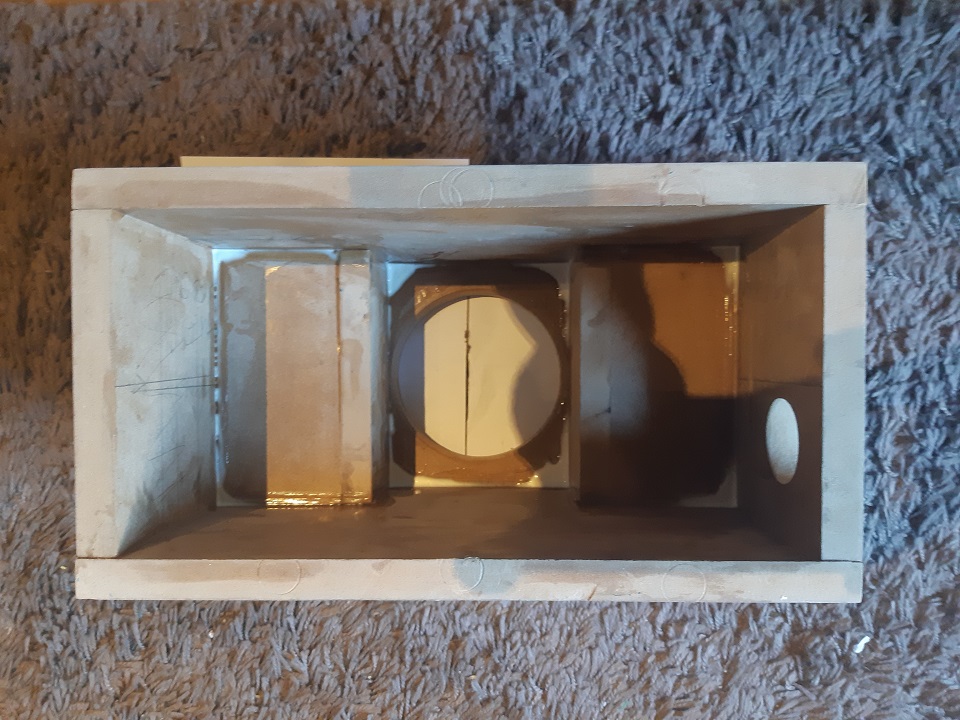

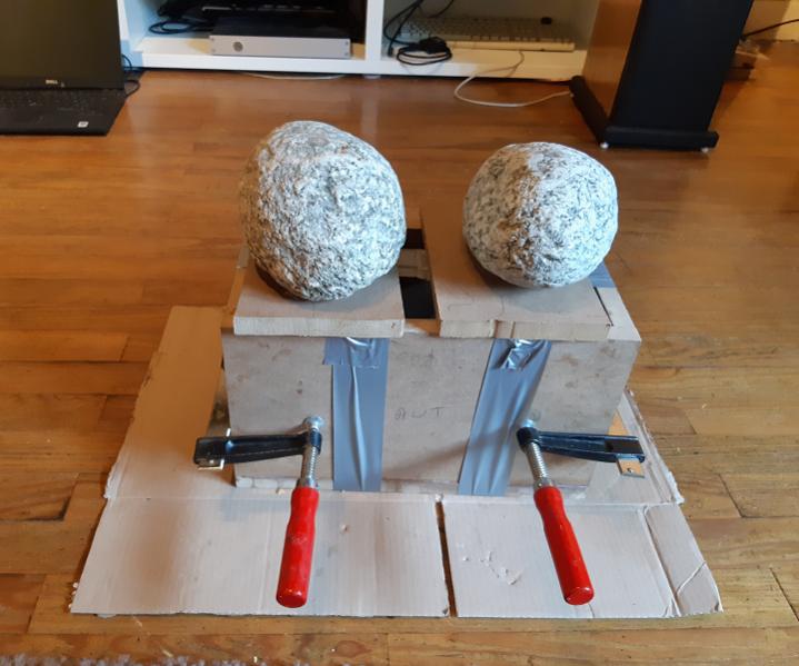

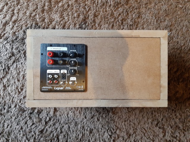

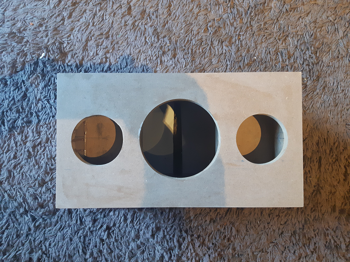

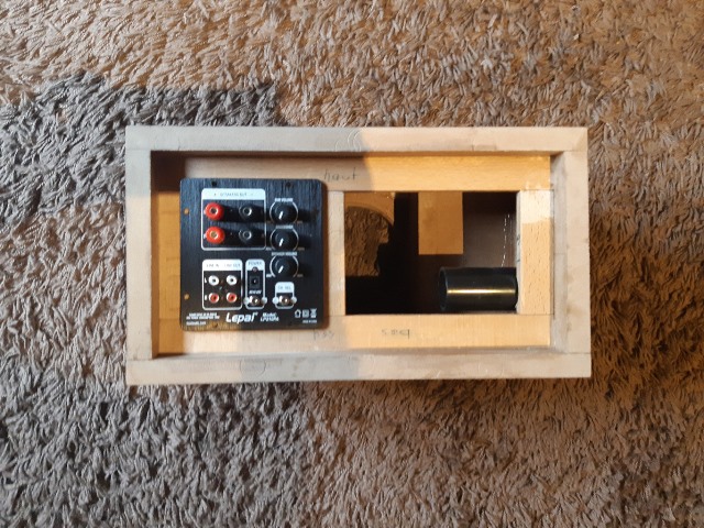

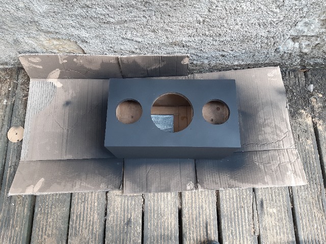

Build process is still going 🙂 Next stage will be working on the back panel wich is planed to be removable.

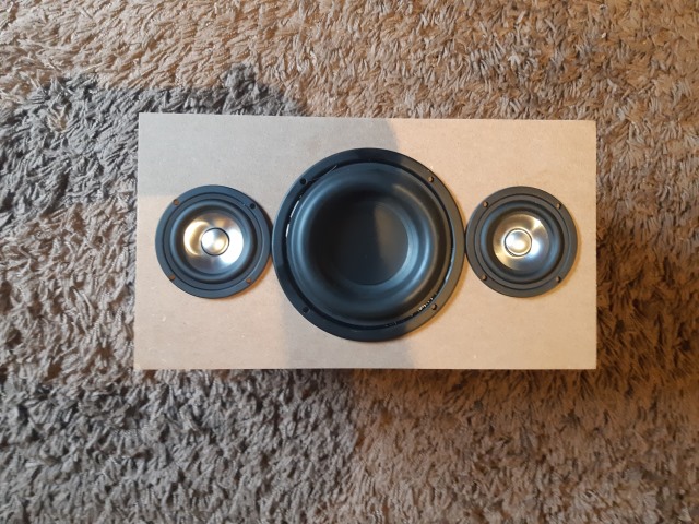

More pictures, build is still going on 🙂
Next step will cabling the electronics parts, amps, speakers cable and crossover parts 😎

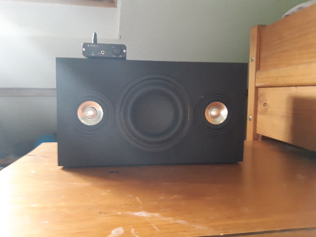

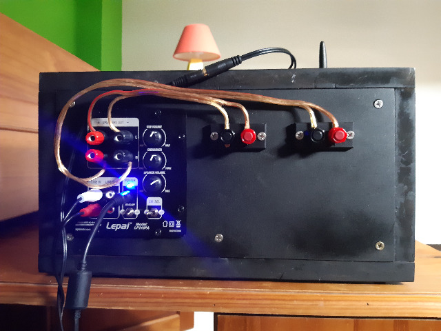

Box is singing for a week now in my son room 😎
Sound is quite good with 50ASX2 and Lepai LP210PA, bass are punchy and hights really nice.
The boobox need another amp for the two stereo channels, Lepai LP210PA Mini Plate Amplifier sound is just fine on .1 setup for the bass section.
I'll add a TPA3116 amp for the two stereo channels
