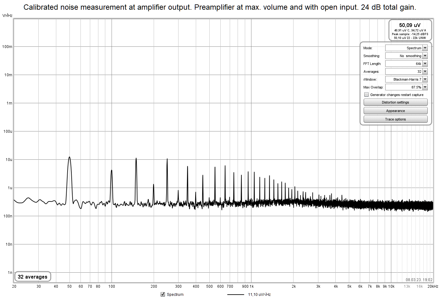

Slightly more precise evaluation method.
With additional 10 dB gain, wideband output noise would be 160 uV. That would produce 3.2 nW / 8Ω or 170 dB below 1W. No way to hear anything even with some 110 dB/W horns. 🙂
