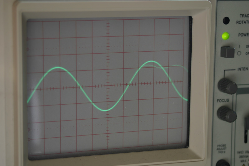

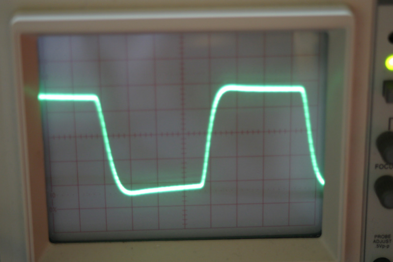

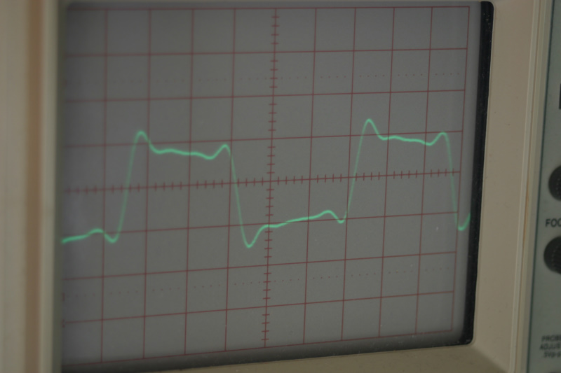

Source is sampled at 44100 at all times.
Oversampling 3000Hz square (ESS Sabre).
Filtered of course, but unrelated.
Oversamping 10000Hz square (ESS Sabre).
Ditto.
NON-Oversampling 22050Hz square (just to overdo it). Filterless. As steep as electronics permit. Post-ringing (PCM1704).
NON-Oversampling 22050Hz square. Filtered. Transient is less, ringing has gone (PCM1704).
A long time ago, when NOS was rather "new" there was a long thread at Hydrogen about squares could not be heard through speakers anyway. Hmm. Look above and you know why.
This, btw, was the same thread which was about the famous UDial test tone (an around 19.x KHz varying tone, inaudible to most, but impeeding for phone-dialing tones which really weren't in the data -> aliasing ... and which could burn tweeters).
Anyway, this is what I'm talking about, and by itself it's nothing new I guess. The only thing I say is :
When everything is deformed like you see above, and knowing that harmonics spring from squariness hence transients, the harmonics are lost by heavy oversampling.
This is very much audible, and hardly subjective. One just needs to know what to listen for.
As said, the downsides of it are in quite another league, and to my firm opinion we can't - or should not - say that those downsides are to be preferred over loosing the harmonics.
We better try to keep them right, instead of throwing them away in advance and all is lost.
Please correct me wherever I'm wrong.

Pictures nb. 1 and 2 are correct - that is the continuous-system waveform of the samples your discrete-system generator with fs=44.1kHz has produced. Do not forget your discrete system is limited to 22kHz and cannot generate squares. It is only the deficiency of your graphical software that it displays straight lines/squares instead of the correct waveforms as on the first two pictures.
Pictures nb. 3 and 4 are obviously wrong. System with frequency-limited transfer function cannot produce straight lines. If it does, the waveform is "straightened" and "sharp-edged" by aliases causing serious distortion of the original signal (which could not be squares in the first place).
You chose 22050Hz for obvious reasons - the squares look just nice (exactly 2 points per period). Why don't you take pictures e.g. for 20kHz "squares"? For NOS you will hardly recognize the shape (if you make your scope synchronize at all), while OS will produce decent curly squares - just as it should be. Maybe you will want to post the resultant pictures for others to see.
Hi Peter
That's a nice demonstration of your point, so I see what you mean now.
However, you've missed a fundamental property of sampling theory: the square waves you show aren't really meant to be square waves. A group of positive-full-scale samples placed directly after a group of negative-full-scale samples (and repeating) is not a square wave. It looks a lot like one if you join them up with a smooth line, but that's misleading, and isn't what the samples mean. They've come out as a square wave in the unfiltered case because those are actually distorted by the lack of filtering. There are harmonic frequencies there which the digital system is not capable of controlling, and what you're seeing is distortion.
For example, try generating a full-scale sine wave just near the Nyquist frequency - it'll come out as a square wave. Clearly not what you want.

1. This thread indeed is not about that. On that matter all last posts are not. So, I'll stick with some misconceptions for now.🙂
2. phofman, you are right. But only because I indeed was unlucky to use a frequency I should not have. I did not think about that, and the 22050 was just because it is the max to be used.
3. Wingfeather, of course I agree, but I look from the other standpoint. So, besides, again, I used pictures I shouldn't have (and which were taken for a different purpose really), I just *want* the 22050 as a sine to look as it does on those last pictures. That is how the data is, and I don't want it smoothened.
And I don't want that because everything will be smoothened because of it otherwise. That this leaves me with a pile of harmonic distortion ... well, I've said it earlier.
All 'n all when the data shows transients, those transients should come out. If we only can agree on that (not difficult), we can debate on how to do it (ok, not here), what will destroy it in the first place (I say heavy OS) and whether it will ever be possible without a pile of distortion when you start off right. And I know, shifting Nyquist to infinity will, but this is infinit OS. The wrong start.
