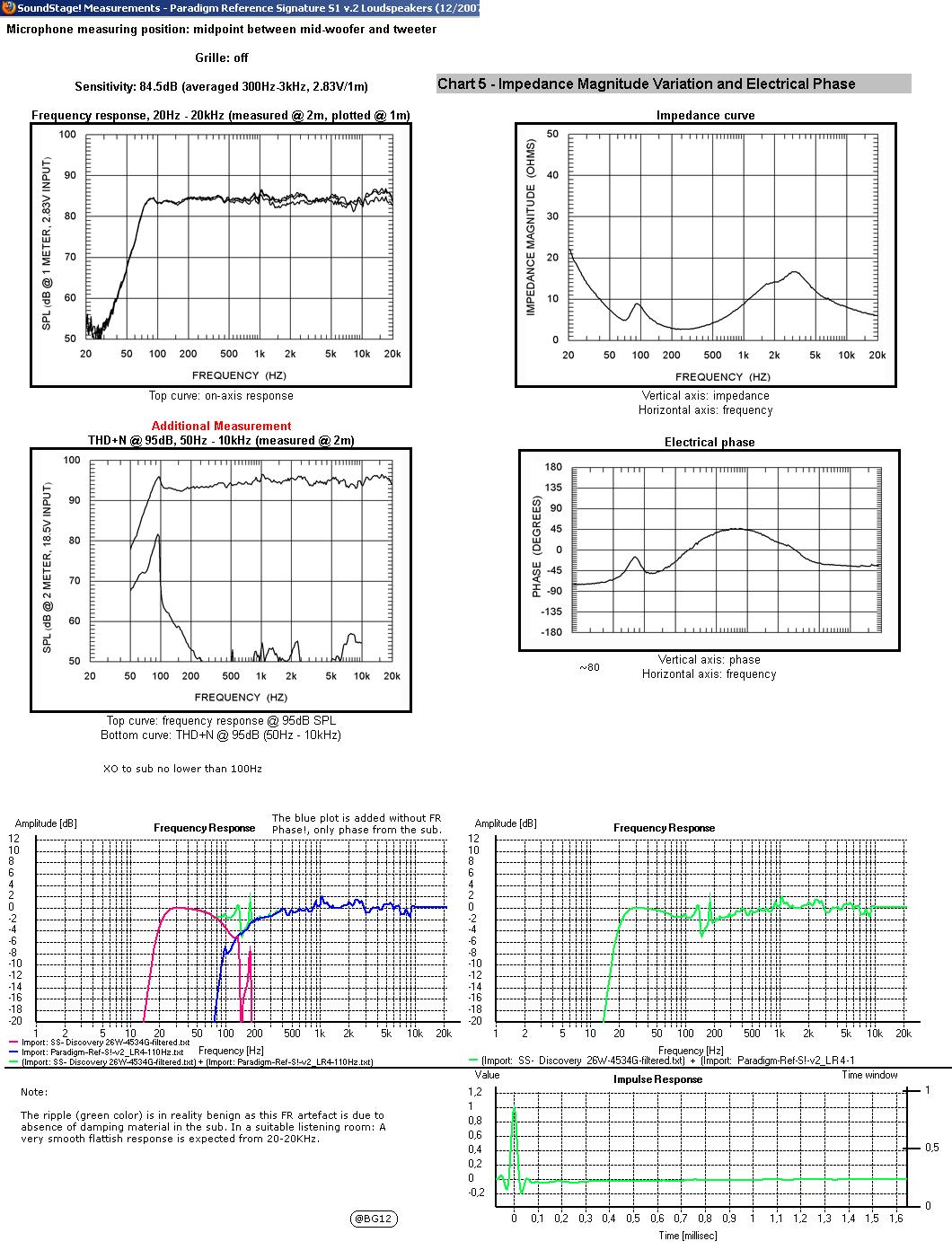

IMO, If the Pre-Pulse is separated from the Main-Pulse more than ~10 mS:
The Main speakers needs to be 'time' aligned with the TH:s using signal delays.
10 mS is the typical ear integration (fusing) time when listening to music.
Within this time the localization cues and sound onset(attack) characteristics are established but not the ear/brain pitch determination for signals below ~100Hz as they need more than ~3 periods to be tonally heard.

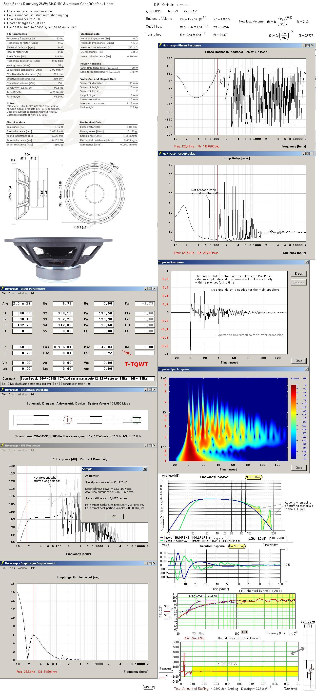

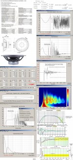

Most TH:s that are digging lower than ~30 Hz have a large time separation between the front and rear acoustical signals.
In that respect I find T-TQWT's are superior (SQ-wise too) compared to TH:s as they normally are designed without needing signal delay's for the Main speakers or to be FR tamed using EQ's.
I don't think signal delay units are to be blamed if bad SQ appears but instead the operator of the equipment when doing a lousy system integration of the speakers.
