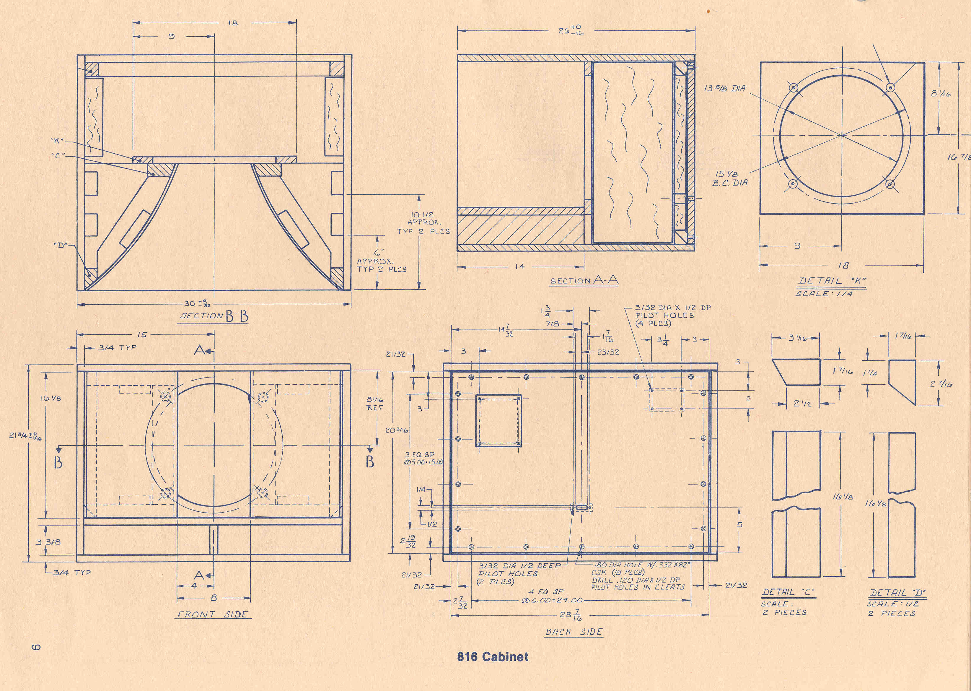

Is this weird Altec clone worth salvaging?
A friend picked up a pair of Altec clones at an estate sale, thinking they were something special. He has offered them to me for $300, and my initial reaction was enthusiastic as I long to experience the famed Altec sound in my 24'x18' shop, or maybe even in my 20'x24' living room. Further research has only served to muddy the waters and I am no longer sure they are worth playing around with. Any advice from the braintrust would be most appreciated.
The drivers are:
PRV Audio D280Ti-s CD in what appear to be an Altec H-811B Horns
Dayton PA310-8 in the boxes
Crossovers are Eminence PXB2:1K6
I can find any number of Altec designs that look like this for 15" drivers, but none for 12" drivers. Are there any? Could this be a real clone, or more likely a one-off attempt at a downsized 15" enclosure?
Are the PA310s good candidates for horn loading give these T/S parameters?

If it's an 816 scaled to a 12" it's a custom from 'somebody'; that said, a lot of official Altec speakers were made by authorized distributor's in-house engineering crew such as I had access to here in Hotlanta plus there were Altec authorized furniture manufacturers that did them too, so in theory it could be 'Altec', but without documentation have to assume someone like me either designed it and made by others or my DIY, so worth however much one values their time and whatever it cost in time/materials to make or willing to pay others for it.
Without cab design dims, can't comment on its performance beyond showing the 15" 515-8G in an 816 cab with its ~110-342 Hz horn reflex tuned to 62 Hz, so the response above ~342 Hz is strictly the driver's output, ergo the Dayton will in theory drop down ~4 dB, so in a scaled version seems an OK match-up.
What are the dimensions of the mouth and throat? Looks like an 816 maybe the board the woofer attaches to can be replaced with one for a 15 without too much trouble depending on how it was constructed. That said I don't think they are worth 300 esp. considering the distance.
816 cab drawing
511, 811 horns, 807/804, 808/802 CD dims
At a glance then; based on a 12" woofer, 811 horn, a 4/5th (0.8) scale (12"/15" Sd, 30" 816 width) looks close enough for me without actual cab dims and at 16 1/8"(.125") i.d. tall this revised 816 can barely squeeze a 16" frame Altec in it.
Note that all the older horn designs were designed for 15", so anyone with these older cabs (literally) have their work cut out for them to ensure no frame warpage or cracking as I've seen just from folks who believe they have calibrated wrists, but don't, as the later frames were a big cost reduction from the original steel and cast 'bucket' frames.

That said, I don't think they are 816-based cabinets. I had my friend check and the upper and lower faces of the horn are not parallel. The lower is sloped up to the throat, likely reducing the issues (as I understand them) with the 816.
You're welcome!
Thanks! I couldn't make up my mind if it was sloped or not. Might even be a clone of one of mine (I braced the HF horn section differently) as I chopped up many an 825 and a few 828 cabs to make a cheap, superior sounding 816 for 'garage'/school/Fraternity bands from '70-'82.
