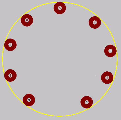

Is this top of bottom view of 12AX7 / 6N30P?
Reality check before I burn stuff: Is this top of socket view or bottom of socket view for these tubes?

Hi Petter.Glad to hear from you.

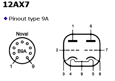

I think I remembered an old rule for tubes that the 1 was first left view from bottom.Don't know if it makes clear or not, but...I am not so tubed :darkside:
I think you could see the filaments at the center of the tube,should be 4 5 with 6.3V
Sometimes the common is not specified to inside tube for a 12V operation
OUUUPPSS !:bigeyes: :bomb: 😛irate:
Hope you won't burn anything....
