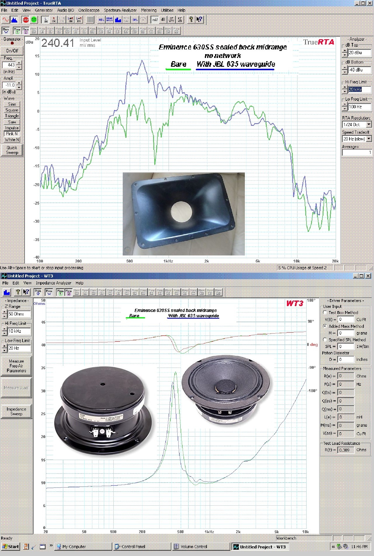

Here's a 6.5" Emiinence sealed back speaker on a short waveguide. It would have been more fair to have a flat baffle the size of the waveguide's mouth rather than bare driver.
While there's still activity in the thread ... is it possible to do T/S parameter based sims for such sealed back drivers? Or the values for Fs and Qts are to be understood like the final Fbox and Qbox of a sealed box? (In this case I guess one would have to trace the FR and impedance curves, assuming that's half-space, to try to predict the boost needed for the desired low-end reponse and calculate the cone excursion manually.)
