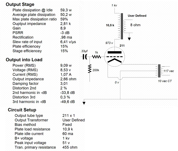

I don't intend to make that amp.
I'm looking forward to make a 7 to 15W SE amp with them.
since they are 311T and have that "problem" I'm not sure how to get them blowing the good tube sound
and still I don't have PT and OT for them.
just have the filament transformer for both.
If you can help me to get on the right track I would appreciate that 😀

People make 805s work as outputs, and they are even worse as far as Rp and voltage requirements go. So your 311Ts, if good, can be used. Depending on Vp available, low negative or zero bias might work. Choke loading and parafeeding the output to a 10K ohm PP transformer is a possible way to go.

my 311T's are good and tested for.
they had been tested with 300V and a simple Class A design.
and sounded pretty good! no distortion on my scope...
but the output was less than 300mW
so. i will post a schematic that I would be getting to practice. later on...
since I don't want to buy a bigger power transformer... and use the one I already have... I will have both tubes with cathode to ground...
so. negative bias needed.

If you want, or expect, 7 to 15 watts from a single large triode like this, you will need 800 or more volts on the anodes. There is simply no way around this.

for the PSU I was wondering about 1Kv. not to difficult to achieve. although. dangerous
I'm posting the details from SE tube CAD program.
if you please, tell me if it is in a good track...
I don't have the driver circuit made yet.
if I 'push it harder' on the input signal it will have positive grid current.
anyway. it is a 311T and 10W of power is pretty good for me ^^
p.s.: on the picture is does not have the negative bias on the 200k grid resistor. it is suposed to be -51V
