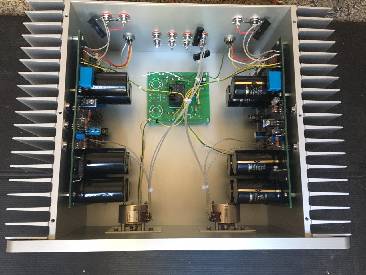

is this OK grounded ? os miss wiring connection?.. Thanks(picture)
this is a 2 chassis preamp, power supply & preamp connected via 4 wires umbilical cord using Lumberg LV thread locking connectors.
Few days back troubleshooting a problem (not solved yet) , found this. The yellow wires (ground) on both chassis board end on connectors where gone to no wires, and on the umbilical cord is are a black wire that happen the same (to nowhere) but on opposite pin. Could be a miss from the builder ? None has continuity to chassis or AC ground outlet.
If YES how it works good for years ? 😕

Johnmath, thanks . This is an H2O Audio (designed of S250 amp, for low impedance Apogee full ribbons speakers) and this the Fire preamp (2010-2020)?, to emphasized the S250 amp, this one was builded around 2018?. Unfortunately the designer Henry Ho past away this year and are no circuit recorded.

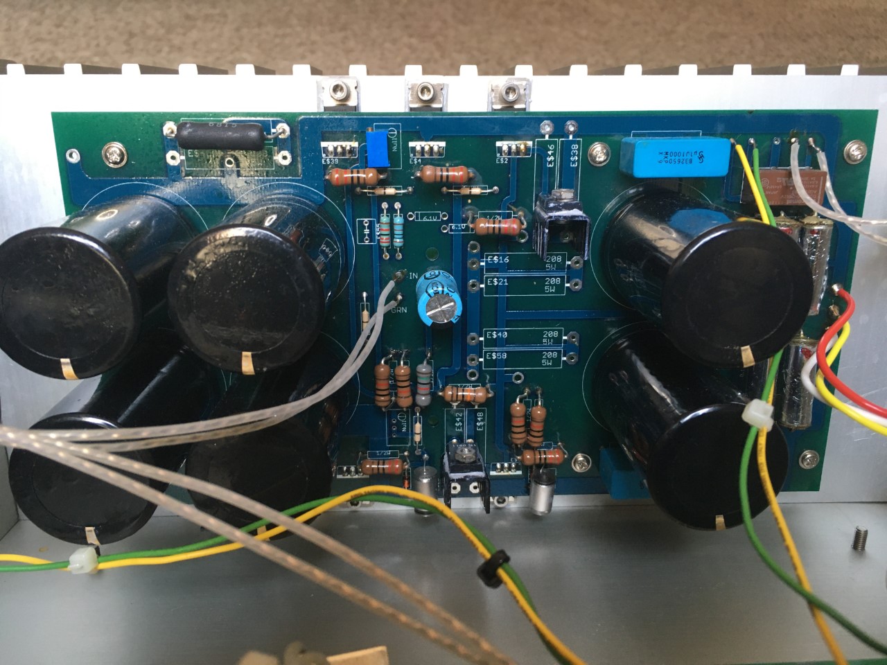

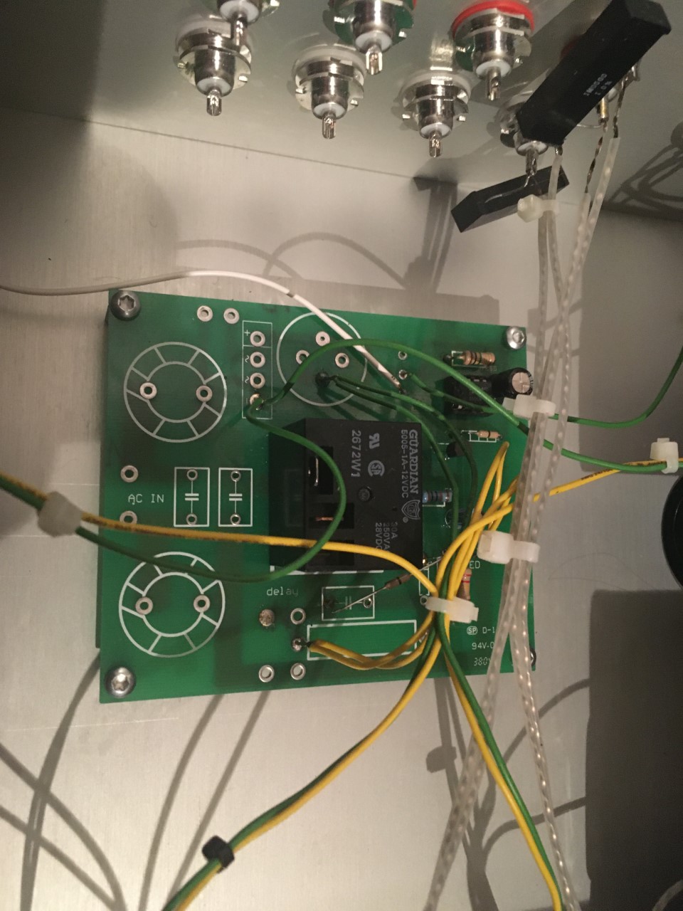

What I missing, is that ground on both units running through 39,0000 50v caps that are not grounded to chassis or ac plug and umbilical snake has a black clown wire that go nowhere too.
pictures of both

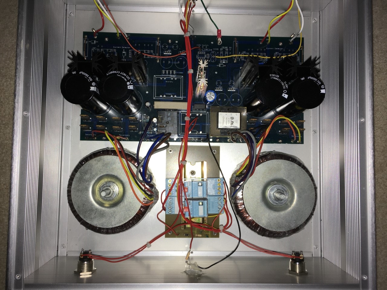

it worked fine but recently start an issue on one channel, but today found that a toroidal trans was the fault. So ordered.
What no make sense is the board has the wire output ground connection and builder take care to solder those cables (power supply yellow from board, preamp yellow from board & black wire on the umbilical cord on opposite location).
And due from one chassis to to the other the connectors has inverted installation that could cause the confusion by the builder (my speculation only).
