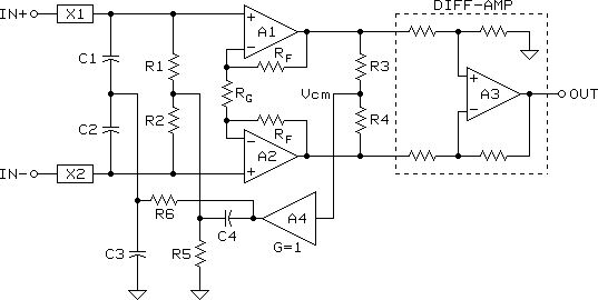

A more elegant solution would be to bootstrap the CM impedance, but I'm pretty sure THAT Corp has a patent on that, which makes legal reproduction tricky. You can trawl through the patents for the THAT1200 to find out.
EDIT:
Maybe I should just use THAT1200 front end?
And LM3886 inverting / non inverting configuration, of course with all of your sugested parts on LM3886
THAT1200 is not very cheap, but when I calculated cost of my config with 0.1% resistors. I feel dumb now 😀
I thought that I am geting something cheaper, but I was wrong 🙁
I can see, that THAT1200 (pun not intended) have extremely good CMRR, and can easily drive any configuration of LM3886.
This circuit looks extremely nice, I don't think I can get even close to its performance:
Note that C1, 2, 3, Pin1 & Shell all go to Chassis.
All others are Power Ground (PG).
And that somwhere PG is connected to Chassis (for safety).
All the symmetrical signal components still need to be matched.
Tom
It might be B.Whitlock that holds the patent and that THAT are licensed to manufacture.
https://www.google.co.uk/url?sa=t&r...tAXHaUDZA&sig2=IsPFf97h_ORrPI1NxqOqXg&cad=rja
There is an earlier version of that paper dated 1996 and it omits all references to THAT
The post25 sch is different from the two B.Whitlock papers. Both the B.Whitlock papers show the bootstrapped resistors as well as the bootstrapped capacitors.
I know, I saw differnt ground symbols.
They would benefit from matching, but this circuit can achieve much better performance even with worse matching, atleast datasheet says so. It has to do with CM pin. Datasheet explains it. And I can use cheap 1% resistors around LM3886. I think 1% everywhere will still give good performance.
https://www.google.co.uk/url?sa=t&rct=j&q=&esrc=s&source=web&cd=3&ved=0ahUKEwiMi8Db5rDLAhWK5xoKHWF7BB8QFggsMAI&url=http%3A%2F%2Fwww.thatcorp.com%2Fdatashts%2FAES6261_New_Balanced_Input_IC.pdf&usg=AFQjCNG_jnyLkJUP3vgkVI6r-tAXHaUDZA&sig2=IsPFf97h_ORrPI1NxqOqXg&cad=rja
Circuit from this post (which i don't know how to quote) is in THAT1200 datasheet too.
If you read the B.Whitlock early paper you will see that he refers to a 1ohm error and what that does to the CMMR.
The 100r in the filters look like source impedances to the balanced receiver. You need to match them.
Similarly the capacitors appear as input impedances. These too need to be matched.
The bootstrapping improves the CM impedances of the differential resistances and capacitances. This improves the Receiver tolerance to imbalance in the Receiver as well as improving the bridge's tolerance of imbalance in the Source.
But don't add to Receiver, or Source, imbalances.
The purpose of the InGenius is to improve on what was available with very close matching. Going complex and then throwing away the very close matching seems silly.
A DMM set to 199.9 ohms will batch your 100r to an accuracy of ~±0.25ohms
and a capacitance meter can similarly batch your capacitors.
The resistors can then be strung in series and pass a 1.8mA current through the string. 0.3mW through the resistor.
Use the DMM set to 199.9mVdc to measure the volts drop across each to find some within 0.1mVdc of each other.
You now have matched your resistors to ±1part in 1800. Just about the same accuracy as buying 0.1% precision resistors.
If you have a 4000count DMM you can do even better.
