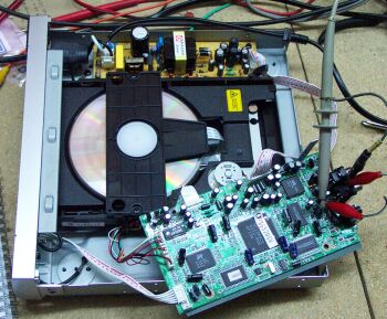

Off subject? Nahhh. Topic is trying to make my DVD player honk. Ok. The switcher psu is on the extreme left side of the case and the pcb is on the right and they are separated by the width of the drive. There is a little bit of 50kHz (radiated) noise sneaking into the audio from the psu, so one of the things I am going to do is make a little shield along one side of the psu to isolate it frome everything else. The psu has proper X and Y caps and a common mode choke at least, but there is no earth to the case; I think it is suposed to rely on the RCA connector earth! I'll have to make a proper 3 wire mains lead for it. Whoa! Maybe I should get one of those enchanted power cords. 😉 I'm just lucky at work we have a shielded room and nifty new HP RF spectrum analyser just for sussing out SMPS's. I may have to hit it with this big hammer. BTW, what's a good dual dual opamp I could stick in it? At the moment it has a JRC4580, IIRC. It is a little wider than a normal 8 pin SOIC.
OK. Here's the box in question.

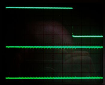

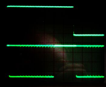

Interesting thing is that the disc doesn't rotate at 500-200 rpm like a normal cd player, rather it goes at a constant 2500 rpm or so.
Anyway, this is the bitstream fed into the D/A with the remote volume at full blast. Only the 16 most significant bits (starting from the left) are fed in as you might expect, the lowest 8 are all zeros. The Upper waveform is the left/right clock.

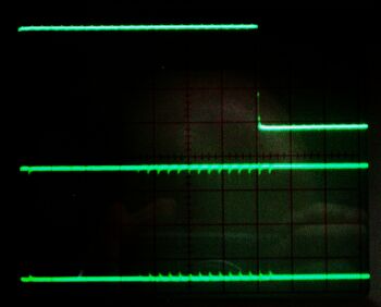

Then I lowered the volume by one step out of 22 and the D/A's get fed 24 bit all of a sudden! A scaling factor is applied to the 16 bit signal and the lowest 8 bits presumably represent the remainder, rather than sticking with 16 bits and losing resolution!
