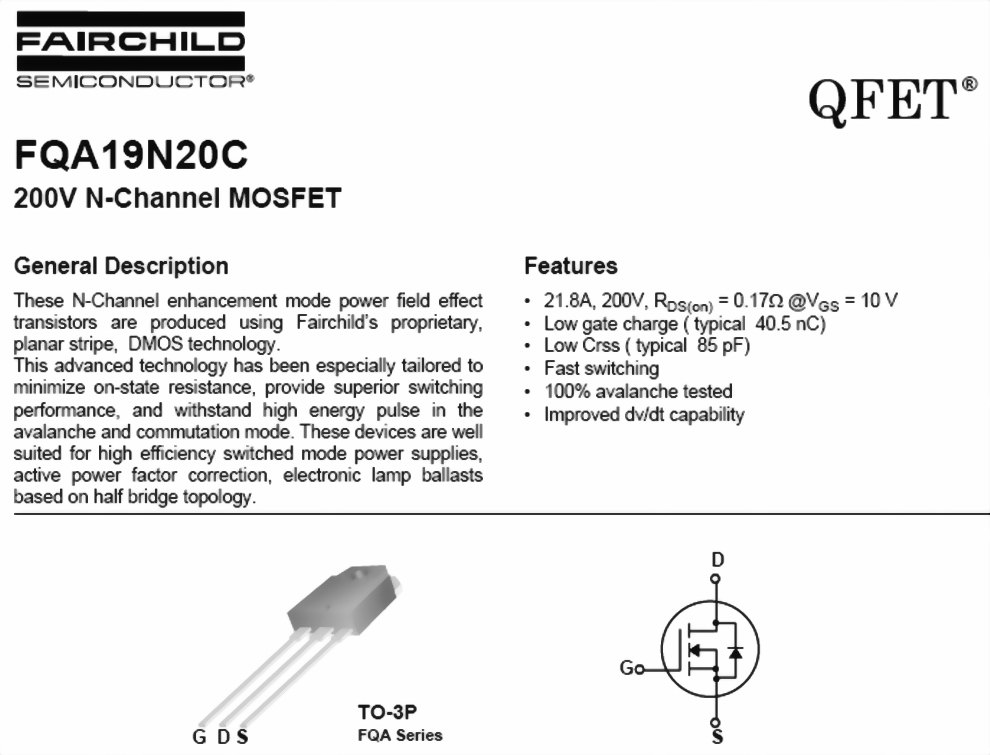

If no good, why?
Please, inform the complementary, i have many FETs in my home and i do not know if i can match them to work as complementary.
What is the main characteristics i should observe into the datasheet to decide if they can work together? (studing N type and P type).
Is this mismatch related drain to source resistance something important to worry about?... some of them, for instance, having 0,47 ohms and others having even lower...or higher resistance.

These are decent vertical power mosfets. Although originally intended for switching, they will do a fair job in audio amps. The closest equivalents I can think of are IRF240/IRF9240
Carlos
I cannot imagine that I am gonna say this to YOU, but......Try it!😀
Feedback should take care of whatever non-linearities there might be. Try them in maybe in these:

I'd try to find something that has similar slope in the Vgs-Id characteristic (transconductance).

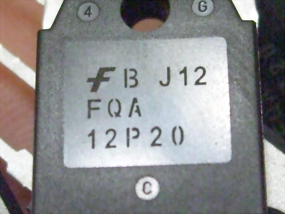

To the extent that average vertical MOSFETs have complements, try the FQA12P20. Works nicely.

the DMOS technology is a substantial improvement, for instance, giving reduced capacitances. In another datasheet Crss for FQA19N20 is reported as low as 30pF. Very nice.

except, there are posters here that suggest IRF240/IRF9140 are a better matched pair.syn08 said:These are decent vertical power mosfets. Although originally intended for switching, they will do a fair job in audio amps. The closest equivalents I can think of are IRF240/IRF9240
If I am not wrong, they were used in the Pass F5. Plenty of discussions on MOSFET choices there if you would care to dig through the lot.
