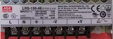

Take care with that, sometimes the V- is connected to safety ground, then it won't help to isolate the chassis of the SMPS from the chassis of the amplifier.Yes, the chassis must be isolated from -V on each power supply if their chassis will be in contact.
Or you isolate both chassis from each other if they are not isolated.
As I said, concepts to learn!
Yes, in this particularly case one of them would be shorted by the common ground if connected.
The SMPS model he indicated seams to have a separate ground from -V and from neutral too.
But sure, everything must be checked when playing with power components.
The best option is to go for a linear 60Hz power supply.
