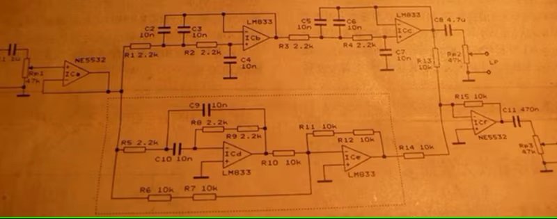

Is this crossover board 12dB/oct or 24dB/oct
Hi.I asked seller but he did not respond. Is this board 12db/oct or 24db/oct ? And it seems there is 7 resistors and 8caps. Should not they be same quantity?
I will use them for 225Hz. So is it ok to use 33K dale cmf55 and 15nF kp1830 1% capacitors?

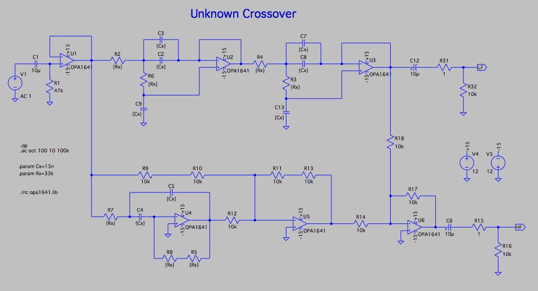

I don't know about "hybrid", but it is 24dB/oct. Strictly speaking, it is not LR. Phase is different than LR:
LR is 0º AT the crossover frequency, this board is -180º, otherwise essentially the same.
Who knows why this design was devised, perhaps for a special need and/or specific drivers. As I said before, it's an unusual circuit, I've never seen the like before.
Reactions: Veysel

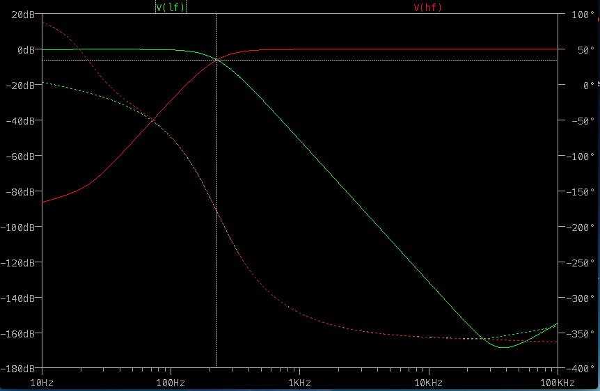

Derived from the photo by "connecting the dots". 99+ % sure it is correct, it does simulate properly.
@Veysel calculated values do produce 225Hz :
LTSpice sim attached

This crossover is the one described on p135 of Doug Self, The Design of Active Crossovers, the chapter Subtractive Crossovers.
It consists of:
1. Two Sallen & Key 2-pole Butterworth HP filters, which therefore constitute a 4th order Linkwitz-Riley HP filter.
2. An MFB allpass delay filter, summed with the inverse of (1), which turns it into a 4th order L-R LP. The delay is necessary to correct the subtracted response.
Self states that subtractive crossovers are extremely sensitive to component tolerances.
