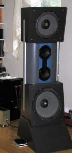

I'm using Raven1 tweeter (not that I couldn't buy something better today, I got this one for last 8 years), Triangle midranges (those are the best sounding mids I tried so far) and Focal Audiom 12" and 15" woofers (those are in Grand Slamms😉 ).
I'm using bi-amp system so I can taylor woofer's response as I like. I can never imagine more natural bass than the one coming from an open baffle. It might not be rumbling but it is very natural. I prefer the last.😉

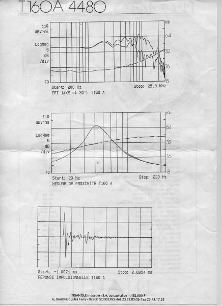

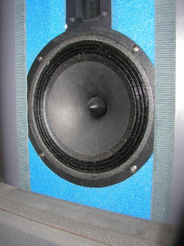

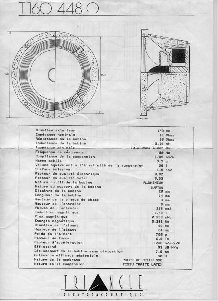

I bought my Triangles T160 in 1996 and paid $250 ea. Since then, Orca for some reasons stop distributing them and picked up PHL line instead. I compared them to many Focal drivers, ceramic Accutones (I've been using), PHL 1230 and few others. The Triangles sounded the best, I just don't hear any colorations and the sound is very smooth. Here is some info.
