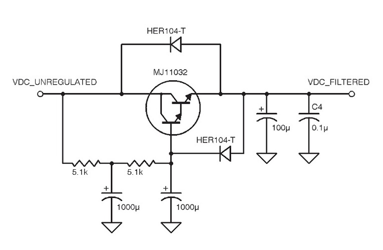

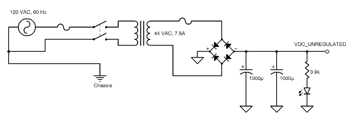

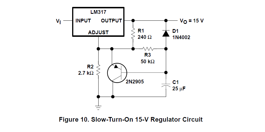

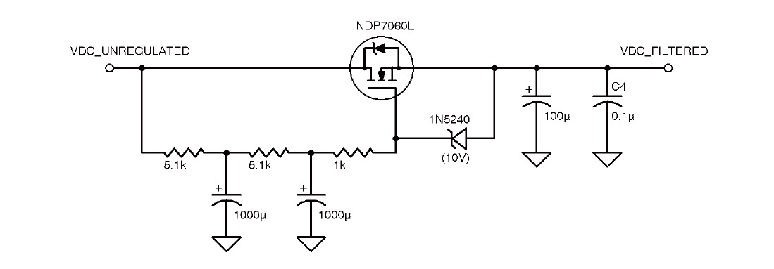

Is this circuit a capacitor multiplier a regulator or neither?
Posting the schematics to make the thread self-contained.

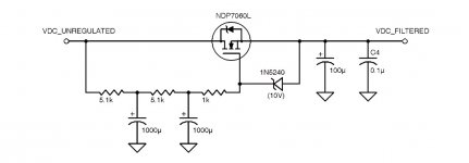

MOSFET or transistor options.

The schematic of the DAC 4 is not really a cap multiplier as it adds a zener to the base of the pass transistor. It's acting more like a poor regulator.
I'm puzzled though by the crazy quintuple emitter follower they use. Anyone has an idea on why they would want to do that ?
I have to assume it's to get the highest hFe value they can, possibly because their zener based "regulator" really doesn't handle varying loads well. I probably would have used a FET before I used a quintuple EF.
Caution should be used before trying to do delayed start up with a circuit like this as you may run into SOA limitations of your pass transistor, especially if you power cycle the device (so the filament would still be hot).
