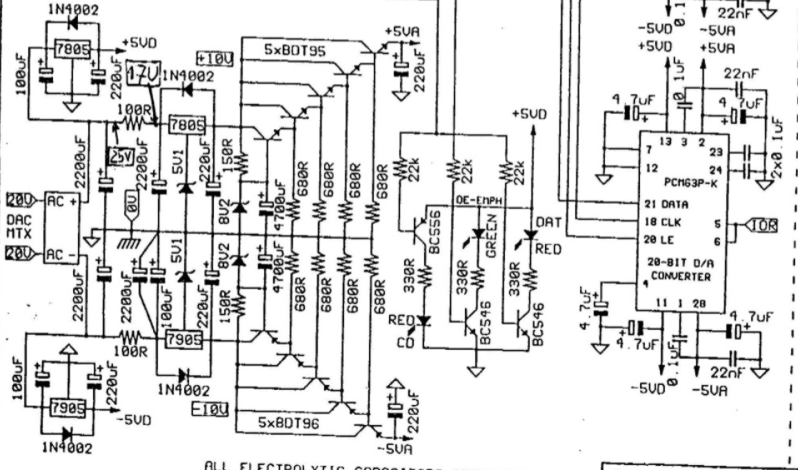

I found a project article that promises to reduce ripple greatly at a fraction of the heat dissipation of a regulator. The author sets this up for low voltage supply. I have a few questions... Is this a regulator or some type of capacitor multiplier, or neither? Also what mosfet would I use if I wanted to scale this circuit up to handle B+ level voltages? It looks promising to me as a preamp DC filament supply as it wouldn't dissipate as much as a regulator and regulating filaments isn't really critical anyway. For B+ it looks like a simpler alternative to full out regulation, a middle ground between unregulated and regulated?

yes, it is a capacitor multiplier.you find a bjt similar one in the art of electronics.you have a more advanced one in DAC4

I share the same opinion. This circuit does not multiply the reservoir capacitance but uses a transistor to suppress the ripple. It is better called active ripple suppressor.JMFahey said:Poorly called "capacitance multipliers" (which they are NOT), are poor regulators, dissipation is STILL voltage drop times current , only since they do not even attempt to regulate output voltage, just absorb ripple, typically voltage drop is lower.

This explains it well, thanks. The work of a regulator having to trim out the voltage above its drop out point causes heat, as well as the load. In cases where one doesnt need regulation, but goes ahead and does it anyway, just to get the fine ripple performance is what I'm thinking. This is simpler and cheaper if you dont need the whole regulator, you just get the active ripple removal?

The schematic of the DAC 4 is not really a cap multiplier as it adds a zener to the base of the pass transistor. It's acting more like a poor regulator.
I'm puzzled though by the crazy quintuple emitter follower they use. Anyone has an idea on why they would want to do that ?
