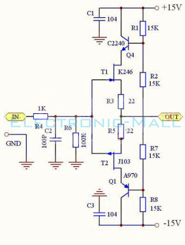

I have an ICEpower 50ASX2 which is sounding good, but I want to try adding a buffer.
I bought a cheap jfet buffer board which is found all over eBay and AliExpress for $10 or so.
It uses 1x C2240, K246, J103, and A970 per channel.
If I use a good power supply such as an LT3045/LT3094, will this buffer do the ICEpower justice?

Looks perfect.
Especially if you trust the seller that the semis are original. I wouldn't but that's just me 🙂
And those screws would better go. They may be acceptable for the power lines but i'd never use them for signal.
Those are good connectors when one replaces them for Phoenix ones that are copper/brass. The Phoenix ones are excellent for signal as well and way better than soldering wires to boards.
I think they used so-called "pulled" JFETs but if they are original it is a bargain. For that price an acceptable gamble. Why not connect it and try it out?
Soldering 12 SMD resistors is what separates the men from the boys 🙂
I have the 50ASX2SE as well. An unexpected good performer (I thought it could not compete with other amps I have) connected directly to a DCB1. It is the varying input impedance that created the (more or less) urban myth that 50ASX2 needs a buffer but if your pre is capable there is no need for a buffer at all. Connecting a volume potentiometer directly to 50ASX2 is not OK.
So yes, when you have tested it is not detrimental to the sound and no channel differences can be heard/measured and that PSU is used. If it is needed is another question.

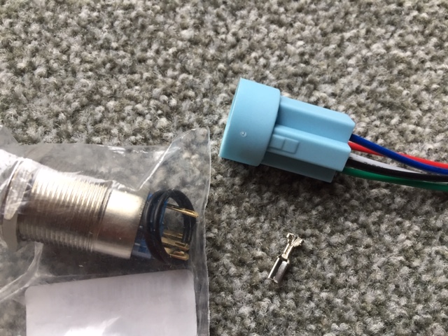

🙂 the Chinese nearly always fail the magnet test. Not only the screws are iron (OK) but also the contacts....
Of course I meant that screw connectors of a respectable brand are OK for signal. The system itself is OK as a connection in audio but only if they are made from copper/brass.
Geezer warning: like SMPS are replacing linear PSU's is copper/brass being replaced for recycled stuff (so so) or even worse steel or the very worst "anymetal"... I was crimping connectors last week and found my tool had some problem crimping the connector only to find out even the connector was made of steel.

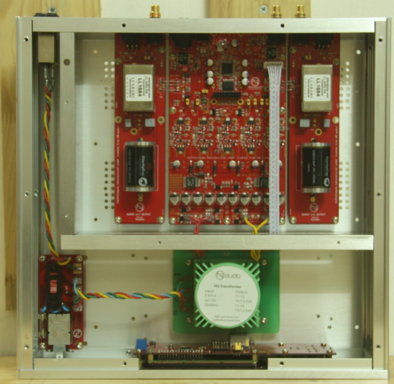

Sure, I had read many reports that a buffer or preamp is necessary with the lower power ICE amps, and while this may, or may not be true, my DAC has a transformer output stage and the designer of this output stage advises that it performs best when it sees a minimum input impedance of 20k, and preferably higher.
I must say that the amp sounds damn good as-is, though maybe with a small hint of "raggedness" in the top end.
The designer has a workaround for such situations where input impedance is lower - add a snubber circuit to the transformer secondaries - and I will try this later, but I will try a buffer first.

I had a closer look at the circuit in the OP and I doubt it will have a positive effect.
1. Any disturbance of the power rails will appear on the drains of the Fets almost unfiltered (can be fixed with 2 Cs additionally)
2. Output impedance is pretty high (160 ohm at 5mA Idss) and varies with the output level and frequency.
3. The Fets need to be selected for equal Idss, the parts have a 10:1 variation each.
4. Offset will vary with time and temperature.
5. Input spikes > +/-7V destroy the Fets
6. Additional distortion is created.by the fets

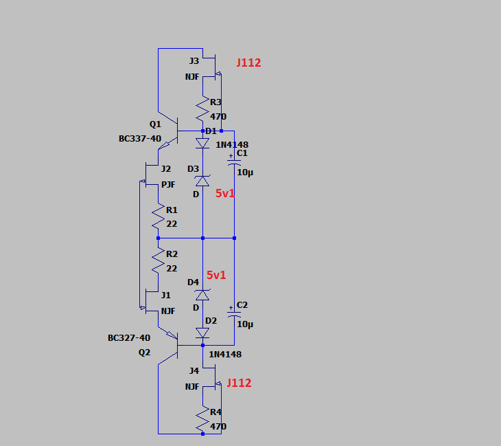

R2, R7 should better be connected to the output pin
This would be a littele bit better.The zenner diodes could be anything up to 7.5v, 5v1/400mw has the lowest tempco according to two major zenner manufacturers. R3, R4 could be anything in between 470ohm ...1kohm
